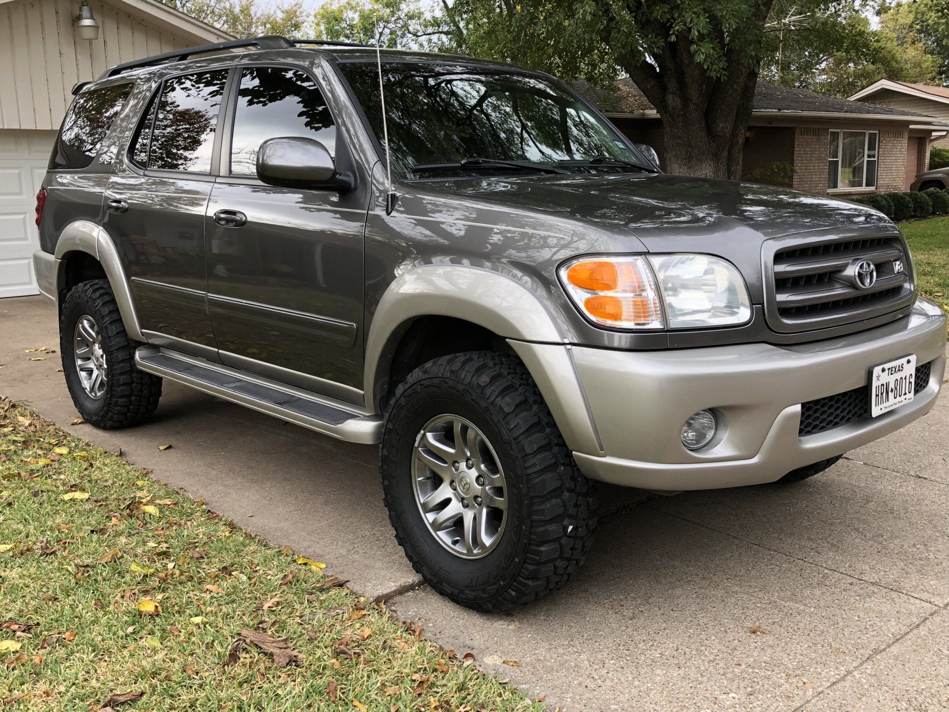

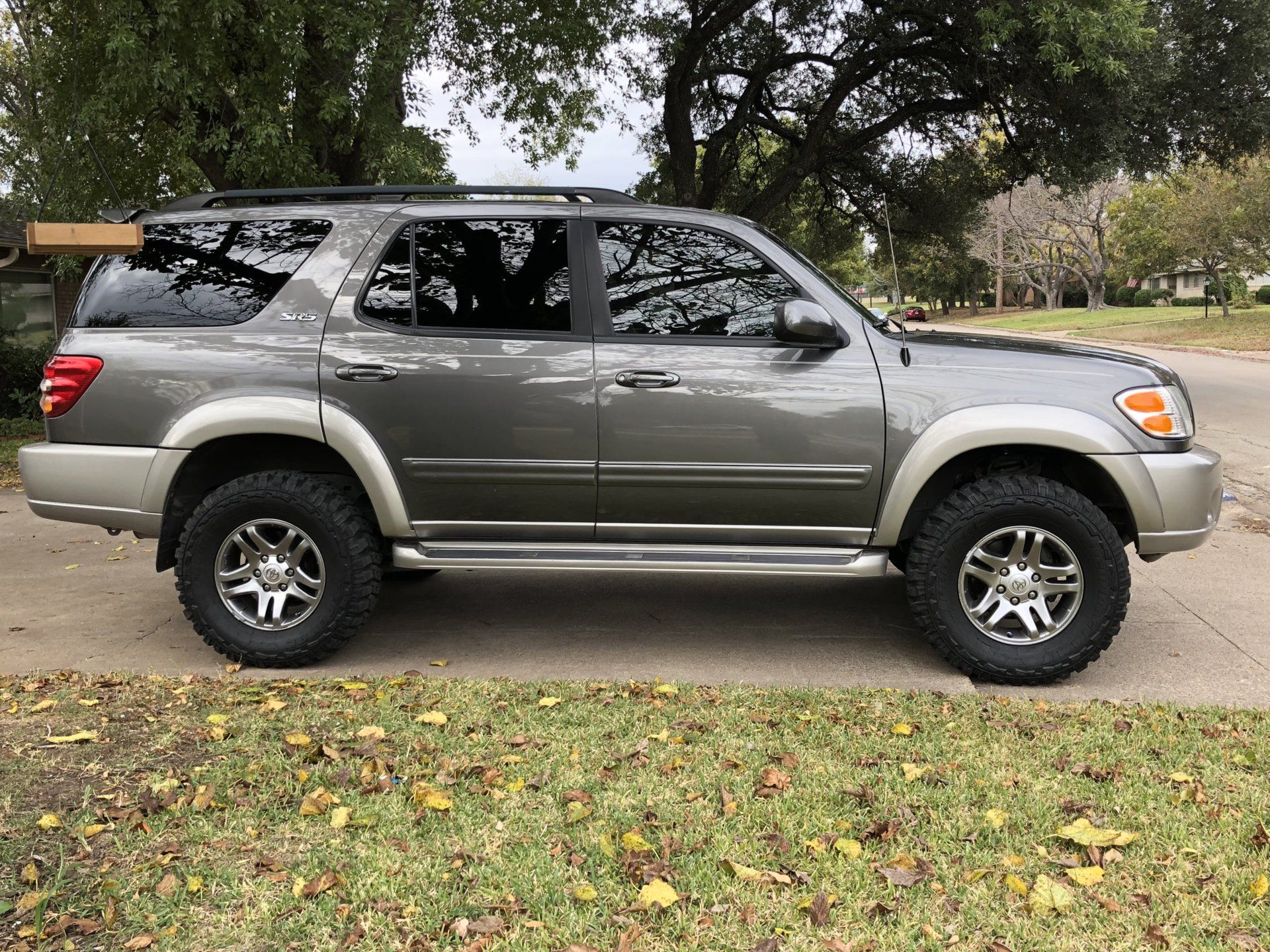

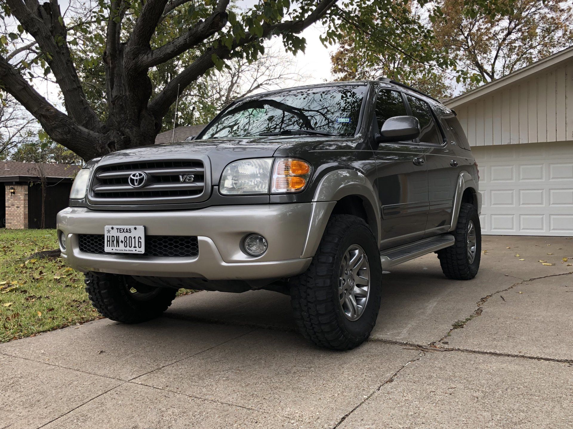

OME 2862 Springs are definitely the route to take! Super smooth ride and no more boat sway!
My Setup:
Front: Bilsteins 24-261425 (Top Notch)
Rear: Bilsteins 33-187174
OME 2862 Rear Springs
1.5" Synergy Performance Wheel Spacers
285/70/17 - Federal Couragia MT Mud Terrain Tire

Thanks. Totally understand on the spacers, I went back and forth and had to do it if I wanted 285’s with no rubbing on full lock. It was strictly either SpiderTraxx or Synergy. Both same price, but Synergy was cheaper on Amazon than buying direct, so it won out.
You mentioned the occasional heavy load, the Bilstien/OME combo is the way to go. You still have control under a load and eats bumps all day long.

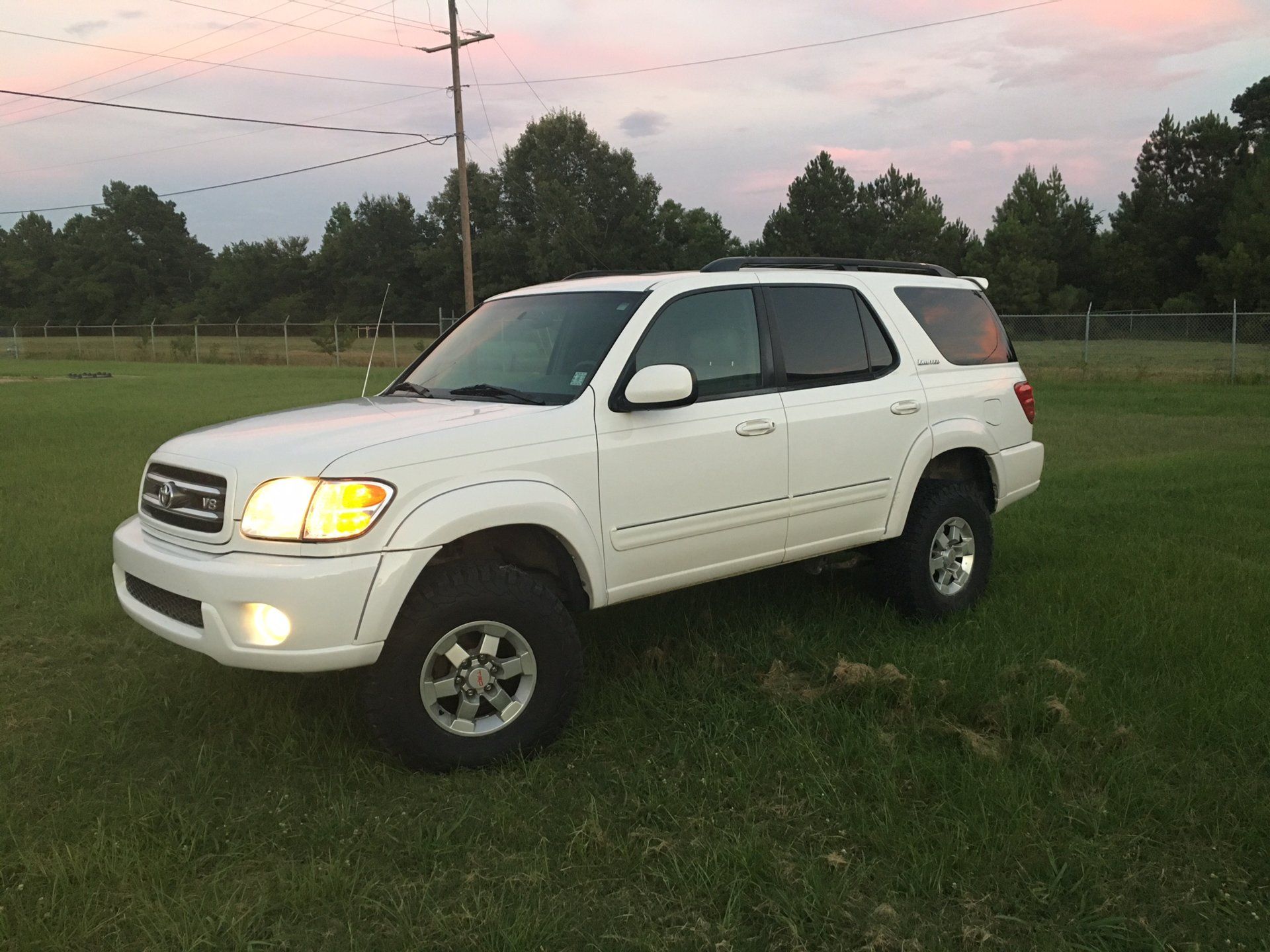

Curious. I noticed you have the exact same suspension setup I have (brands, part numbers, etc.). Do you find your shocks to have little / no rebound setting in them? Bump is good, pleasant, and controlled, while rebound is, virtually, non-existent! I can go over a particular bump in a highway near me, and the rear shocks extend so quickly / uncontrolled the rear tires leave the ground! That's true in neither of my other lifted trucks (200 Land Cruiser or 2004 GX470). The tires coming off the ground also leads me to believe the rear shocks aren't long enough.
I like the look and stance, but I'm not at all pleased with the driving characteristics. Anyone want to buy a used suspension at a discount? :grinpimp:

You actually might be correct. If you go onto expo portal or sequoia-forums and find Sal R's truck build he found out that the rear shock was too short and instead decided to go with a Dobinson. I believe he has since changed it because he carries a lot of weight in the back but the FJ rear shock is too short for it.
Correct, the 5100's sold for the rear are actually for an FJ and they are too short for a Sequoia, even one at stock height.
I am very please with the Rancho rs9000. I have ahc so the adjustment is nice to have. They have a large variety of lengths on their website to choose from. I got them very cheap with a coupon and 20% off from advanced. Dobinsons I'm sure are great as well.
