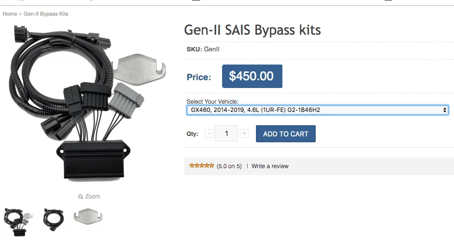

Have you thought about a air pump delete with the new GEN2 Hewitt-Tech bypass units?
"You can remove the air pump(s), pluming, air injection control drivers and by adding Pressure Sensors Options (PSO) you can also remove the air switching valves."

Would it cause issues with CA smog check? That’s one thing I have to deal with eventually.

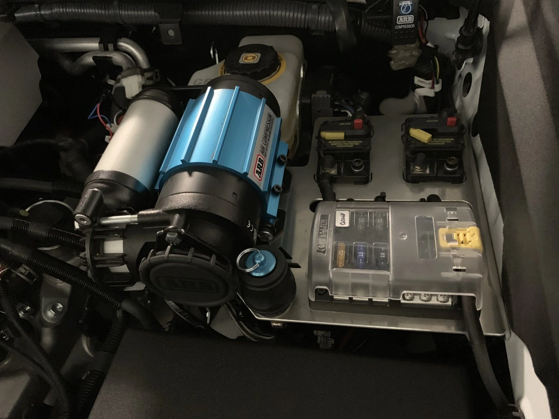

I have the Slee compressor mount in mine with a dual ARB. I'm not sure what I am going to do about the dual battery setup yet. The truck build has been put on the back burner for the time being.

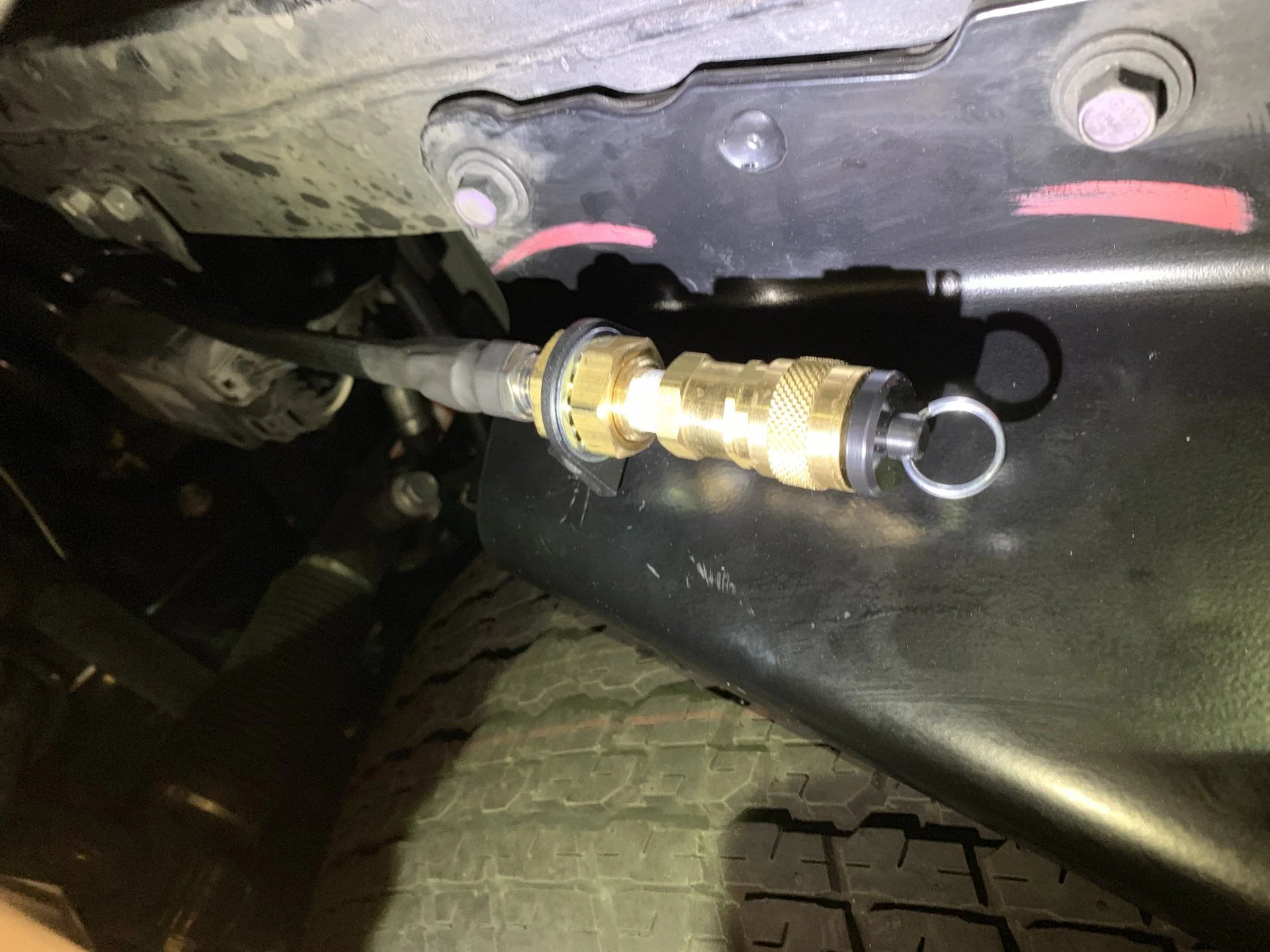

I did the same as @Tex68w but with PowerTray for a 5th gen 4runner. I ran hoses front and back so I never have to lift the hood to use my OBA.

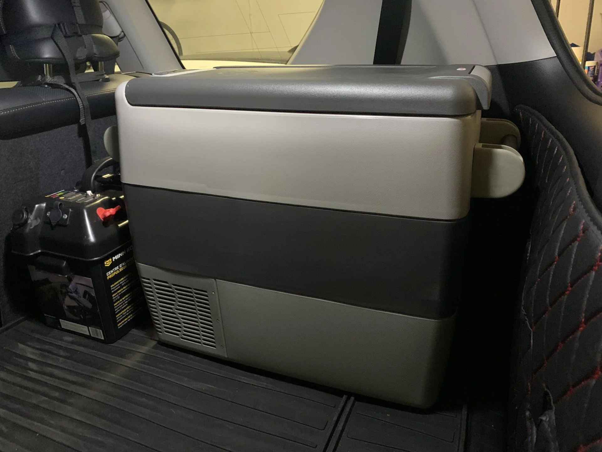

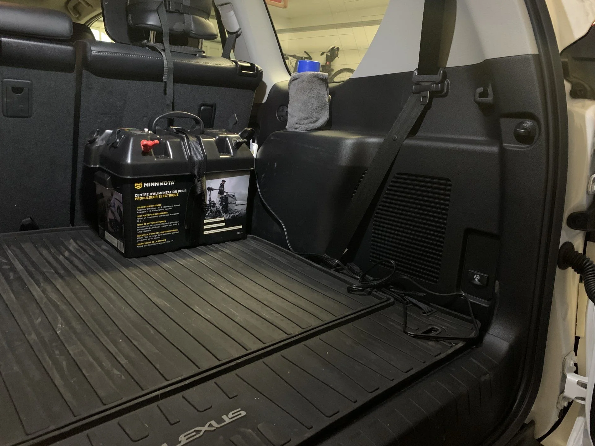

for the second battery, I just have it in a marine box with usb and cigarette ports for my 50L fridge. My particular fridge runs fine in the GX 100w plug in the trunk area and then switches to my aux battery when the truck is turned off. I have a 125ah agm, good for about 4-5 days easily.

I used the PowerTrays bracket for my compressor - they have single and dual ARB compressor options.
As to the second battery, I will probably go the Hewitt Tech Bypass kit and put it by the passenger firewall like the T4Rs do. I don't know enough about CA testing to know whether it will cause you a problem. All the SAIS does is blow extra air into the exhaust stream post-combustion to help the catalytic converters work more efficiently. If the smog test actually tests particulate emissions you may or may not still pass, although my money would be on passing with factory catalytic converters. If the smog test only runs via OBD II port it is less likely to be a problem. You may want to ask Hewitt Tech about how the bypass works for emissions testing purposes; for example if the scanner tool still shows normal operation through OBD II or whether it shows an inoperable system (which can be enough for a failure in some states, regardless of lack of codes or otherwise passing emissions).

The mount is made by PowerTray (link to exact product I used: ARB / Solar PowerTray)

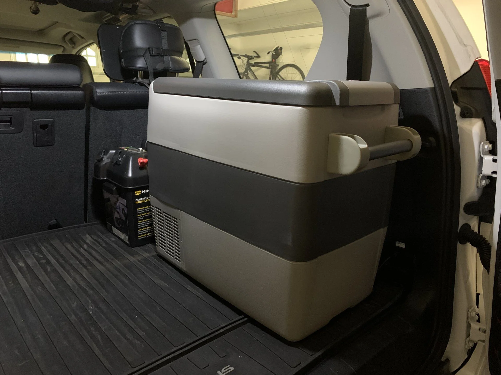

it's currently just sitting behind the fridge in the trunk area. Just a poor man's version of a goal zero. I'm going to be packing for a trip in a day, i'll try and snap a photo for you.

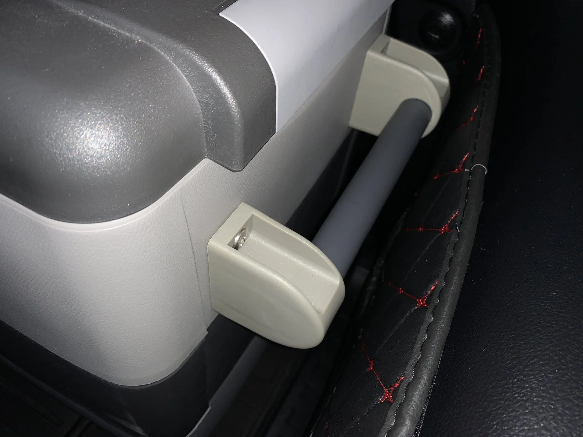

This is an indel b 50L. The footprint is the same for the 35-50L so I went for the biggest one. I did buy the side hinge flip kit to open the lid sideways. I’ll get around to it sometime.
Who makes the fitted pad for the swing gate?
