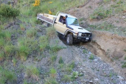

Hi - I run the same tires, 285/75 16s on factory alloys road pressure I run between 2.75 bar and 2.06 depending on the load at the time. For extended road travel I remain at 2.75 bar. for trail work with a reasonable load ( Recovery & weekend camping gear) I remain at 2.06 bar and can reduce to 1.3 bar. At that pressure the tires have a good bulge indicating a good footprint.
My truck is a 79 series V8, which I am guessing will be heavier that yours, especially with all the gear I carry. I would not go lower than 1.3 bar with my truck. The result of reducing pressure to low will result in rolling a tire of a rim, which is more than a little inconvenient. Depending on your the choice of terrain, if you are in a lot of soft stuff, ( MUD) the size tire you have on the truck should be fine, same as sand, but if you are on hills etc and steep stuff I would chose a narrower tire, as for the hilly terrain you need a certain amount of ground pressure to get grip. A wider tire on hills is less than Ideal I have found. But again it depends on the weight of you truck.
Hope that helps
