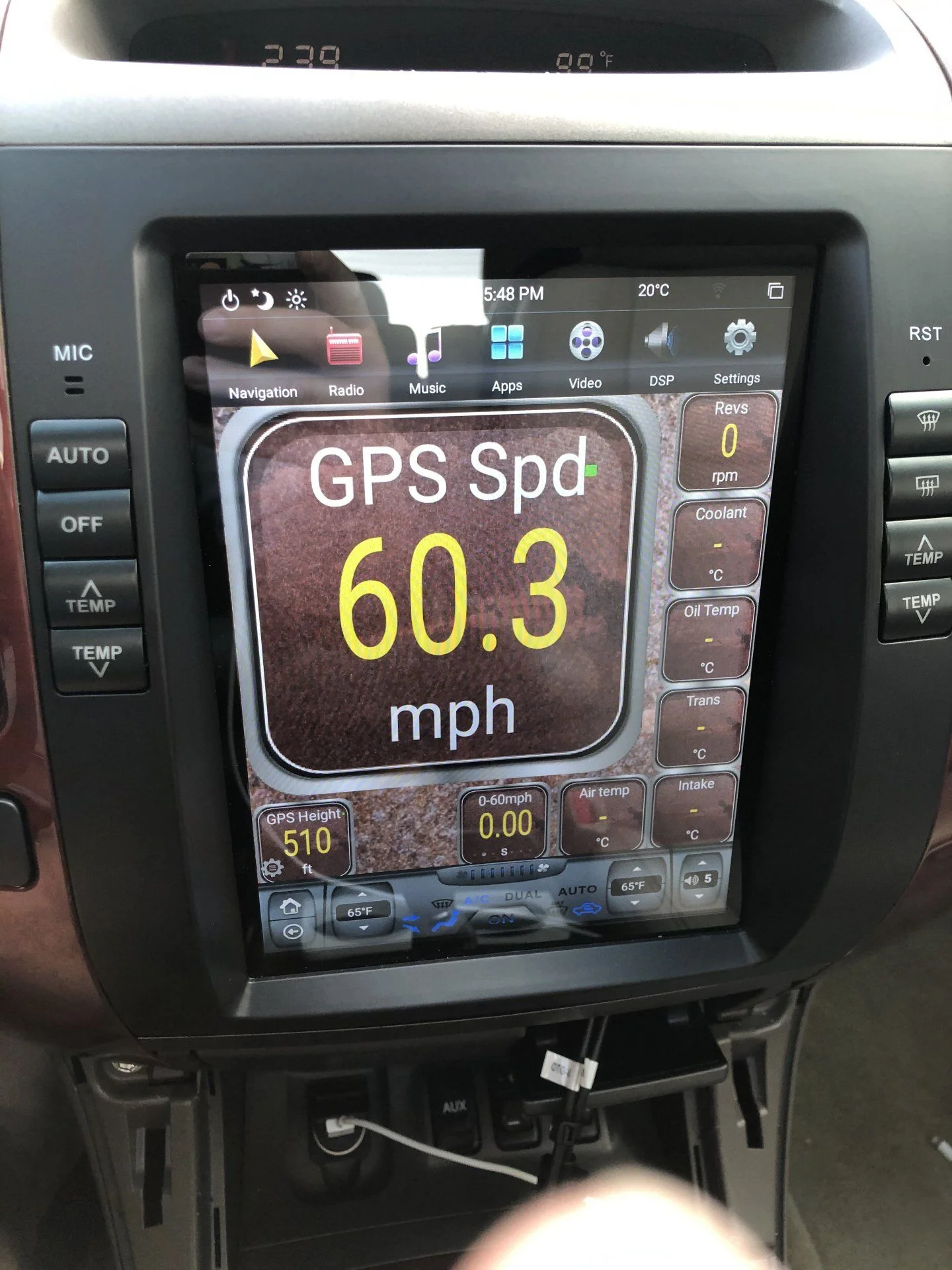

Bought the Torque Pro app today for my android radio in the GX and it seems pretty cool, but I really need the ODBII to fully use it. Suggestions? I’ve read the cheap / mini ones draw power when the vehicle is off—that true?

Bought one and I cannot get it to connect to my Phoenix PX6. I read somewhere it (PX6) doesn’t have Bluetooth capability for this. I’m getting a bit frustrated at the Android-ness of this radio.

Reviving this thread, this VeePeak thing won’t connect to the GROM either. So it’s useless to me.
Anyone have a 100% working Bluetooth ODBII dongle/adaptor that works with both the Phoenix px6 and GROM vline? The GROM has a higher priority since I’ll be going on a ~5k mile road trip in June.
