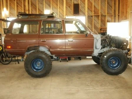

Belly height on a 60
My 60 SOA on 37" SSR's using stock 62 springs is 25 1/4" to bottom of the frame. I do have some rubbing in the front both at the front and rear of the wheelwell, but it's just slight...
Hoping to keep it with the same lift and 38" SX's with some trimming a-la Kling-on style. Trying to because lift laws in AK say 26" to the frame for this GVW of vehicle, not sure if it's possible though.
hey dylan,
how tall are your tires? Stock shackles? stock springs? I have almost the same measurements as you with 38's, stock 60 springs and shackles, and pretty short spring perches.
Ken
:D
21" to the frame on 35's with no motor/tranny/tcases...
I love short things...
Mine is not SOA tho..
