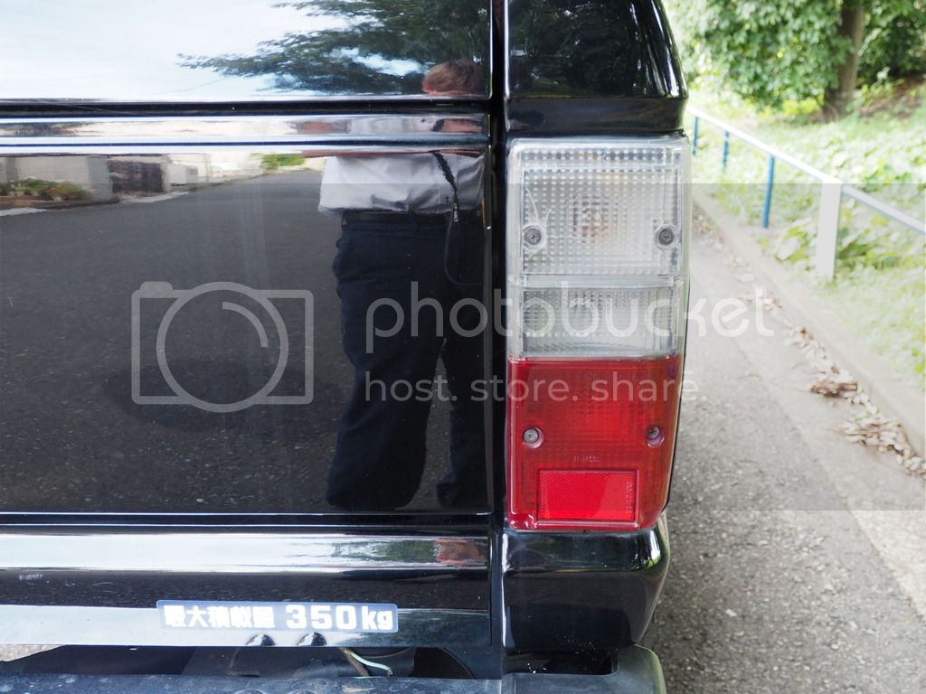

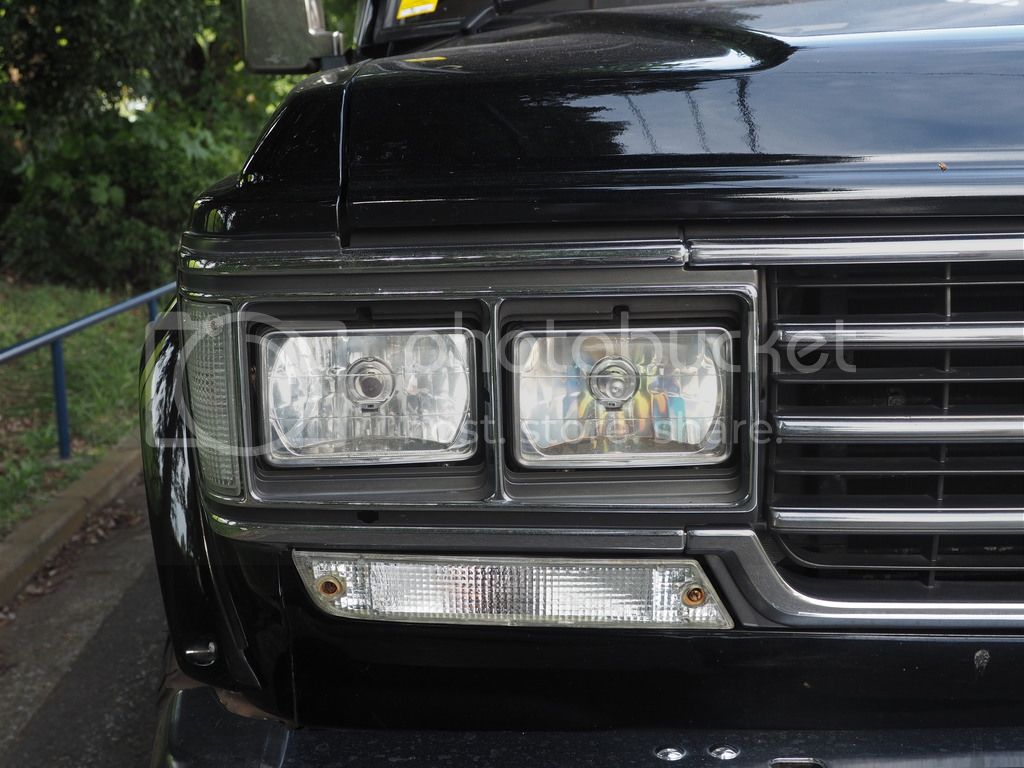

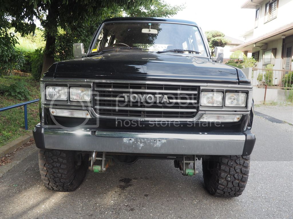

These photos were taken by my agent in Japan. These are all I have to go on at this time.
Im scared Im going to get ripped apart on the inspection. I'm almost certain these lights will not fly. Anyone have tips/experience/warnings/advice?

If the headlights are a question, I’d just replace them with standard units.
Finding replacements for the taillights/turn signals may be more of an issue. I assume it is the clear lenses you’re concerned with? If not already, I’d try using colored bulbs to see what happens. Next step would be some sort of spray tint on the lens?
When i brought my truck over, it had aftermarket headlights. This was actually a bonus because they had a SAE DOT marking on them, while the originals wouldn't. If they have a dot mark, just make sure they are aligned for our roads and shouldn't be a problem. I just needed to modify the pattern from the projectors to rise on the right Instead of left.
My taillights also had clear lenses and a yellow lamp for turning. No issue at all, but i never even checked them for dot, inspection shop passed easily. When i looked up Canada rules for automotive, nothing about clear lenses but there should be a coloured reflector of some sort.
Does it have a high third brake light? Depending on the year, that might be required.
