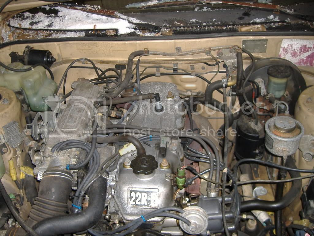

It's a 22re pickup and I would have to move the air box as well to do a dual battery there. and EFI.
Well I have this setup
If you have space under the hood, mount it there. Otherwise, mount it in the bed in a marine box. Thats where I've mounted the battery for my solar setup. In either case, get a standard battery or Gel battery. Optima's any more just aren't worth it.
