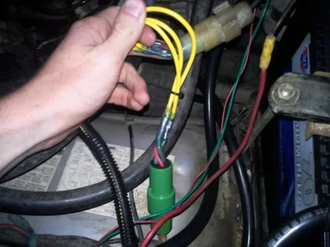

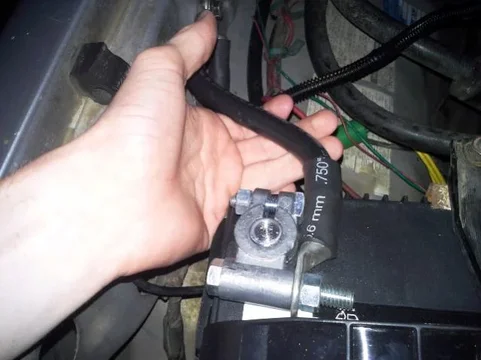

Here are some crude pics I just took on my break, one shows the cable size and terminal, and the other shows the fuseable link replacement.
This is on an FJ60 fwiw.
those things look BEEFY!! nice job.
