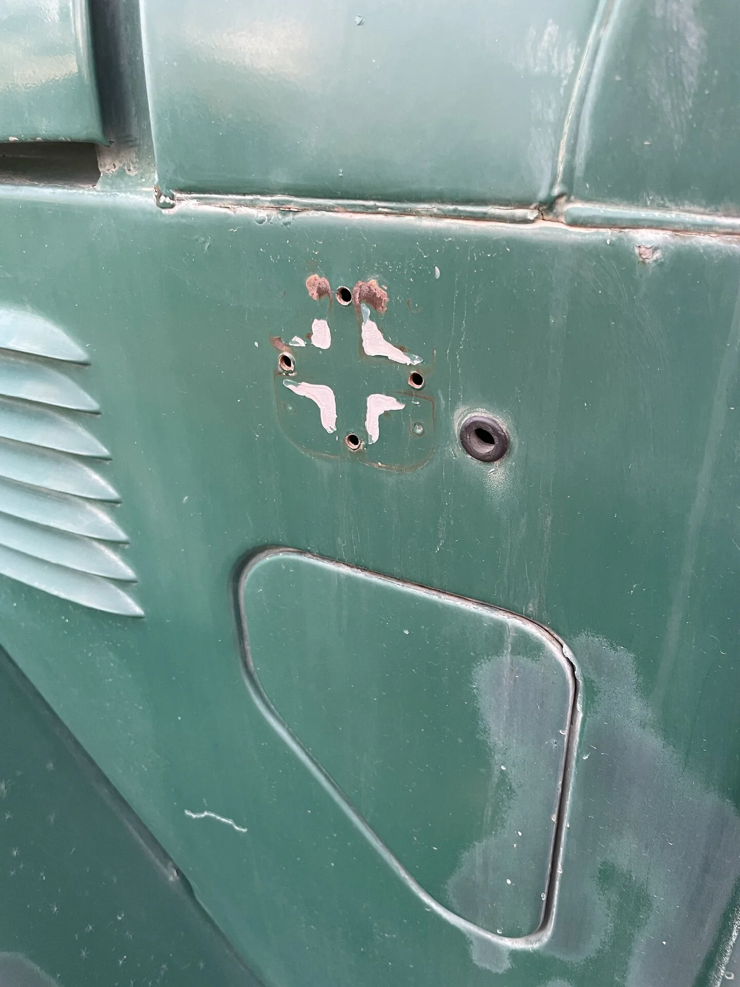

I bought a 78 back in January and it has a spot where an antenna used to be. Rather than patch it up I think I figured out what mount used to be there (Firestik K-24). I need advice on what antenna, wire and basic/classic radio would be a good combination. Nothing fancy, just something that would be able to get me on the channel our club uses. I've got my license but I don't know what to buy or how to tune anything. Thank you

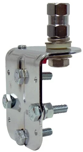

That mount is a CB mount with 3/8-24 mount for an antenna like a firestick. You've got really 2 options with ham mobile antennas, an NMO base or a UHF base (SO239). I think you could get an adapter to go from 3/8 to UHF. Associated Radio sells a mount just like that, except unfortunately the hole pattern is rotated 90° for your holes you already have. They might have what you'd need to get adapted to UHF or NMO. I'd recommend a trip by Associated, he'll be able to get you set up with what you need. If you make a custom bracket with a 3/4" hole in the top you could go NMO pretty easy.
