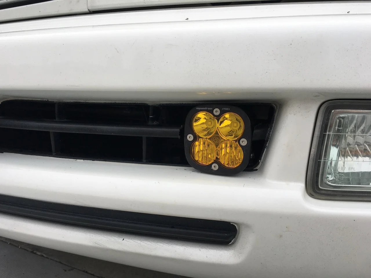

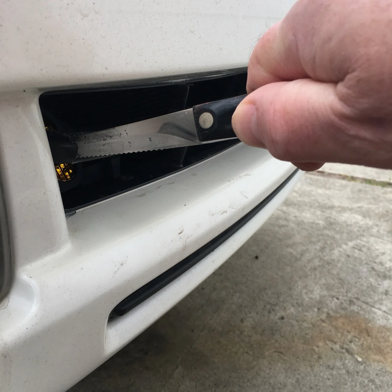

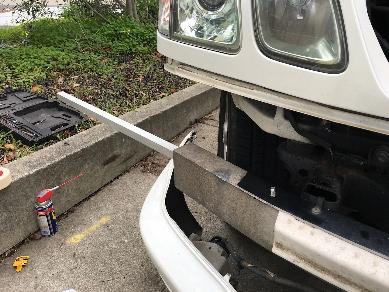

I did some rough figuring by placing the light behind the bumper than made quick work of the plastic vanes using a Sharp kitchen knife.
Time of a quick test fir from the front...

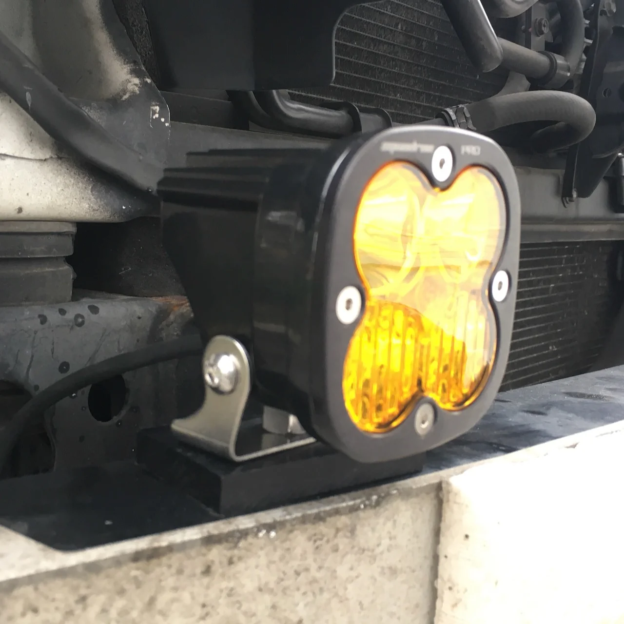

Remove the bumper cover and drill the cross beam. Note the custom wrench extension to reach inside the box-beam... a little awkward but I made it work.
Next added a 3/8" thick ABS spacer to get the bracket at the perfect height. Sorry about the bad photo..
Used a 4-foot level to line everything up since it was going to be more difficult with the cover in place.
Let the fun begin!

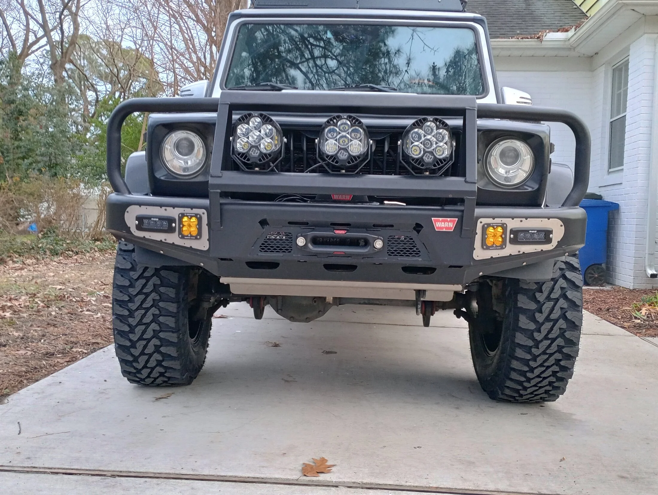

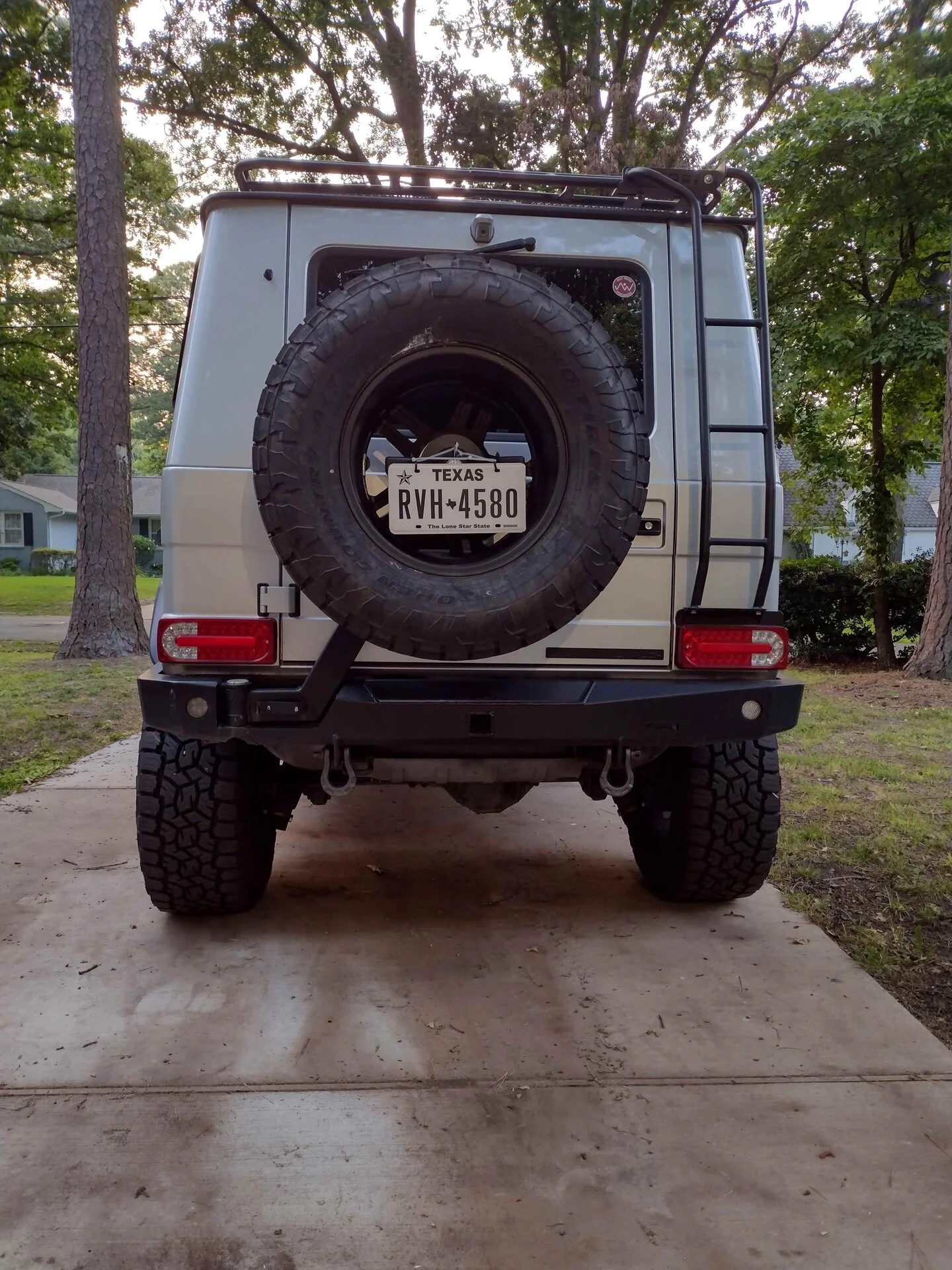

I love the Lp6's enough to put a trio on the G project.... and it'll have lights on every quadrant, as it's the expo rig now given it's ability to cover ground quickly....
we're water-jetting Alum panels today to mount the Squads and Fogs into the front bumper. - it'll have lights on the rack, bumper corners and rear.

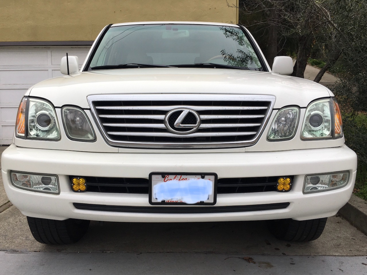

I pondered for a long time on how to mount some simple “fog” lights to the front of my LX. After a little plastic trimming and fabbing up brackets on the bumper mount I came up with this tidy solution using the S2 Sport kit. I love them so far! I could easily become a BD fanboy.

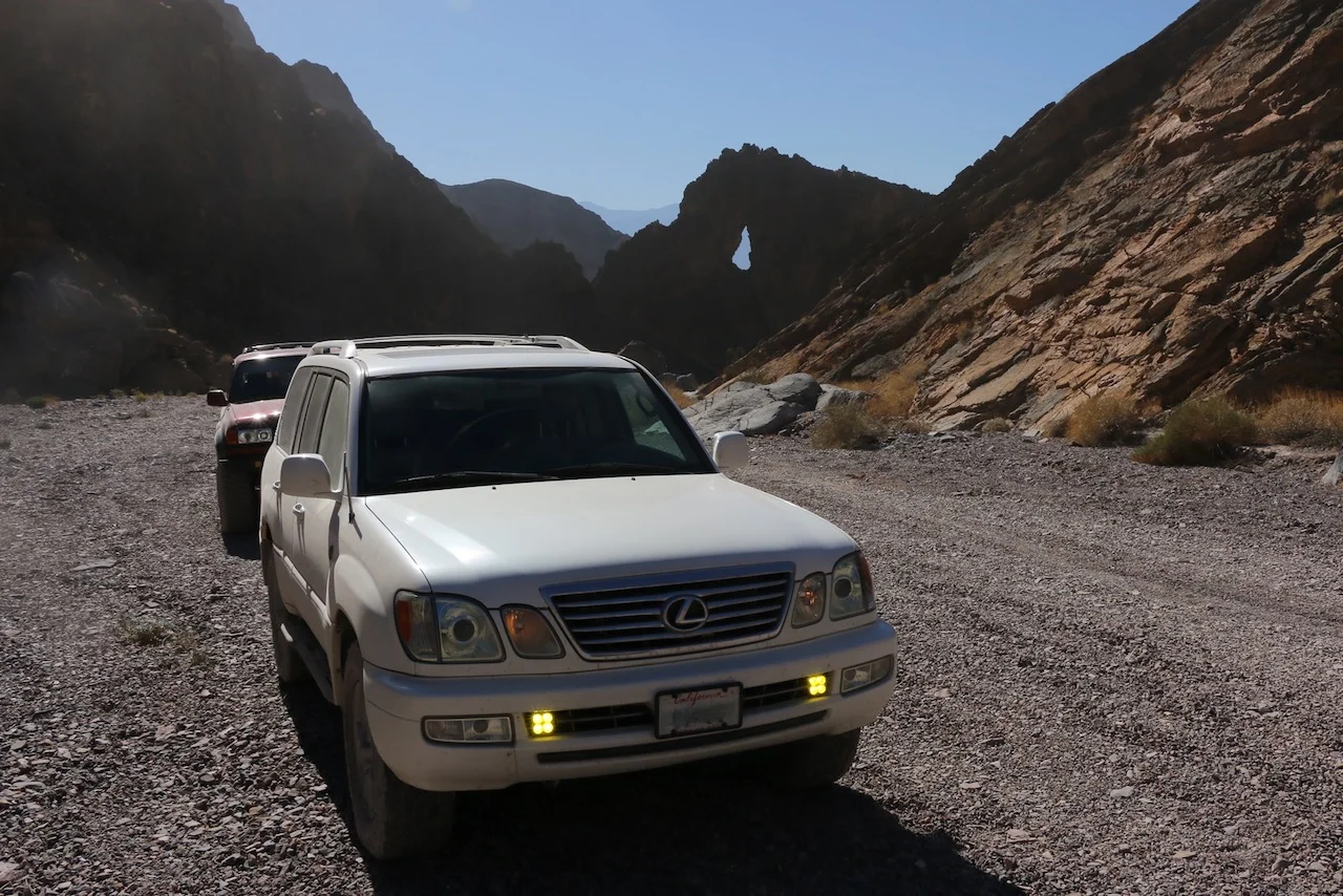

I thought I posted this photo showing the Squadron Pros with the Driving/Combo lens lighting up the Beatty Cut-Off Road in Death Valley. Note... I did turn off the pathetic headlights of my LX470 for this photo. The light output and coverage is quite amazing! Thank you for producing a wonderful product!
Photo was taken at 5:38 PM on January 4th, 2022 as we were heading to Beatty, NV to spend the night so we can be the first on the just reopened Titus Canyon the next day. Titus (and this road) are now closed because of severe flood damage and most likely won't reopen until 2025.
