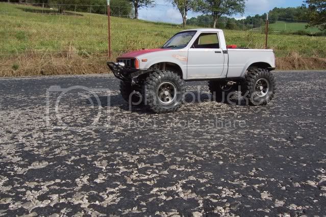

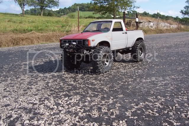

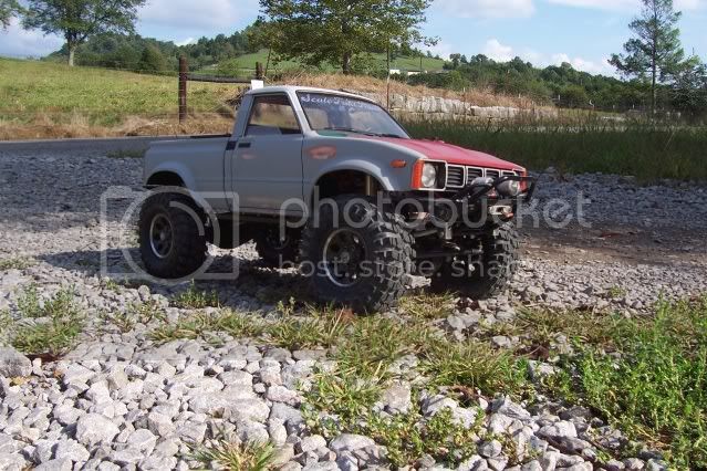

Bob's former life ..........

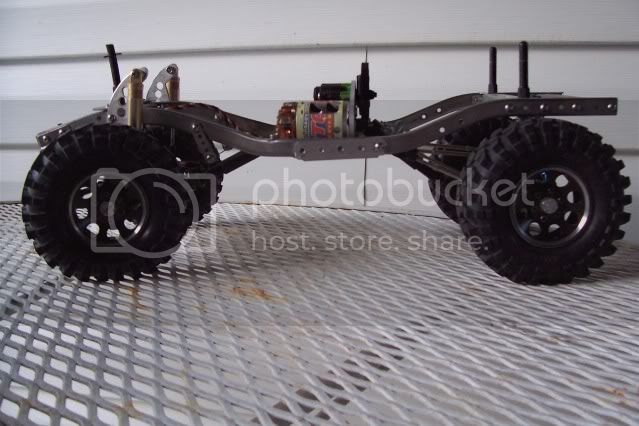

New specs (I started this build back in Augs.)
OG bruiser frame BOBBED :flipoff2:
Chino skid
Jugg leafs in front with turned down tlt shocks
RC4WD 90mm coil over in the rear
OG bed BOBBED :flipoff2:
drop bed maybe
OG seat/dash
New Hilux cab
Clear lexan glass
Reign cab back

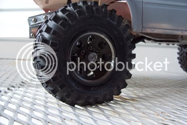

G8 Flat Irons (1 . 9)
Integy wheels with studs and lug mod .
Pede shafts with metal yokes
Sidewinder ESC / BEC
TR/TX not sure yet
Hitec 5645 steering servo Hitec 645 winch servo
3 racing winch
TLT Axles
Axial trans.

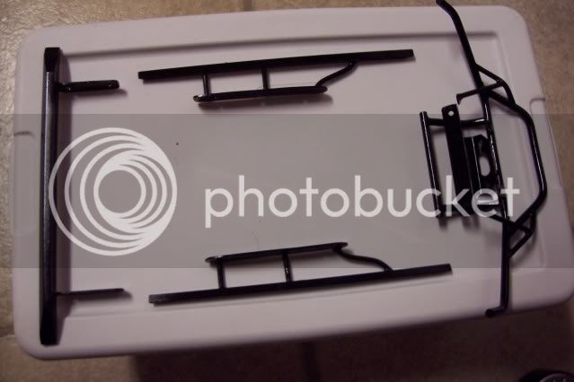

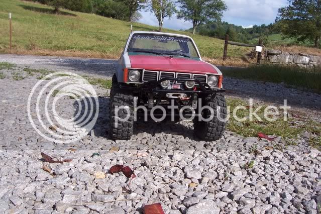

Bumpers & sliders by Mr. Mann

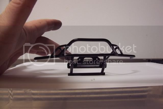

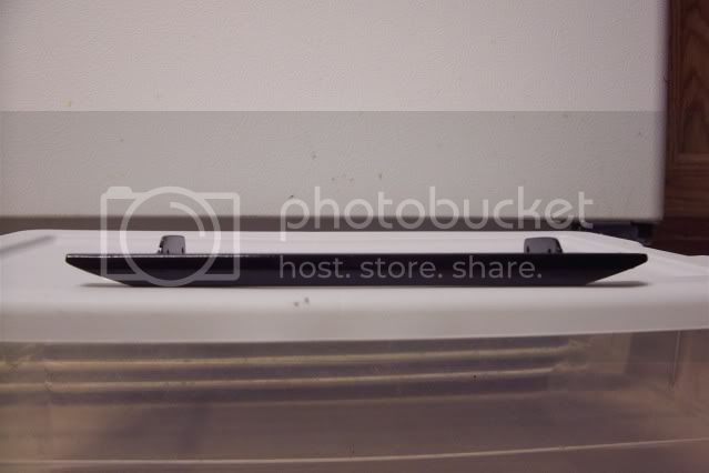

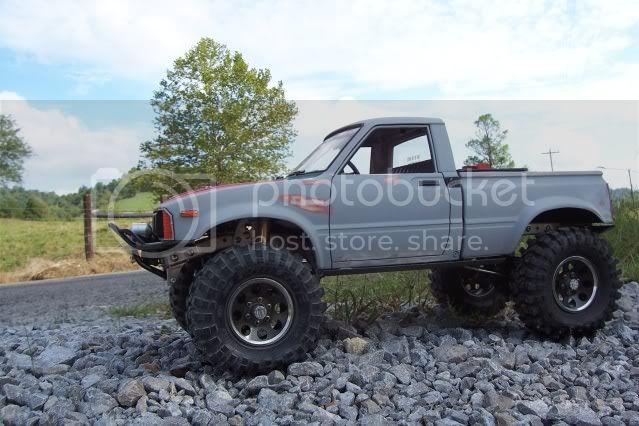

I started of by stripping the old paint off the bumpers and slides . I got them repainted this afternoon . Here is a few pics to hold everyone over till I can get more pics and stuff done .
Small update ........

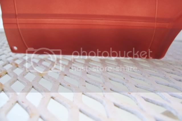

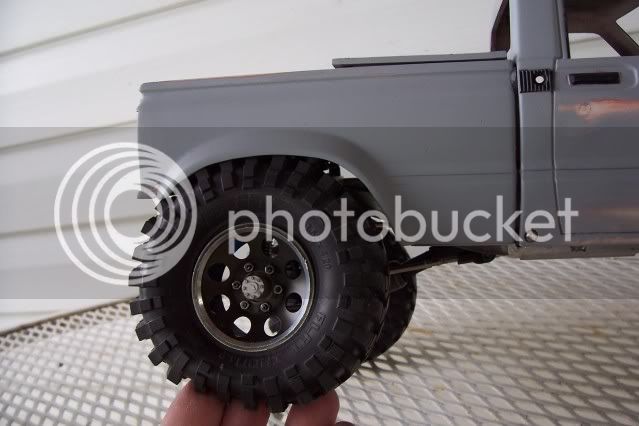

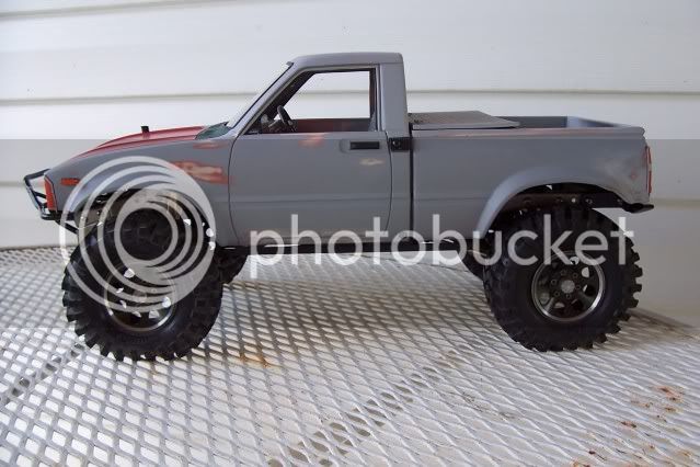

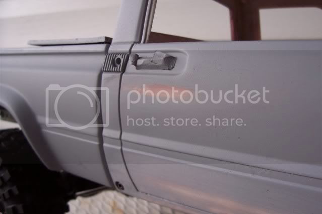

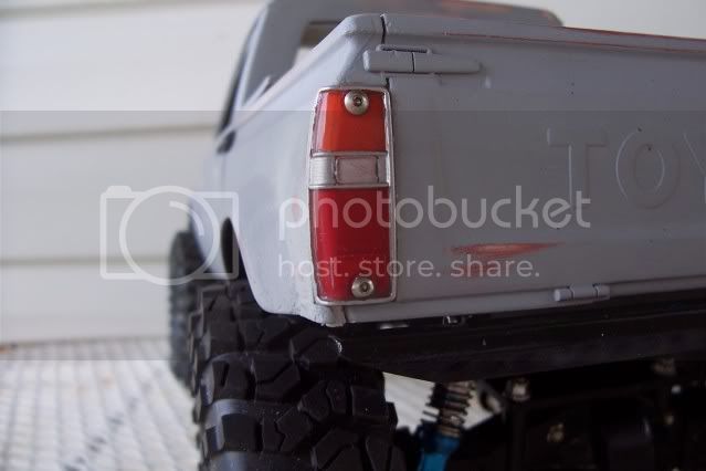

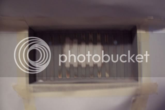

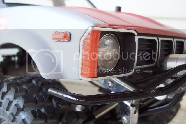

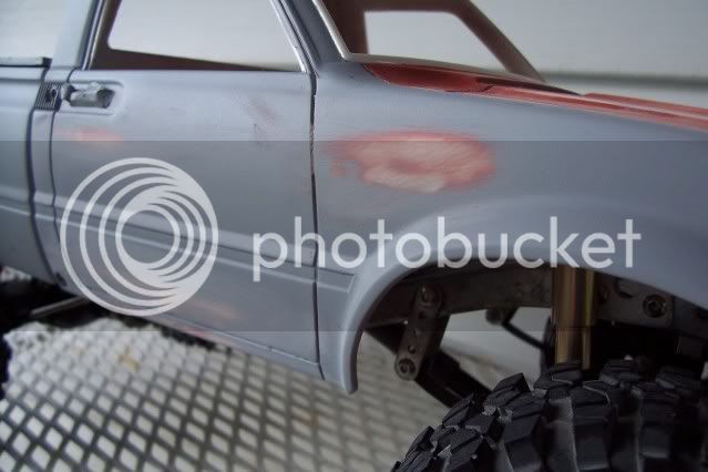

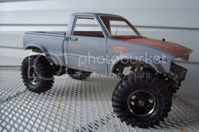

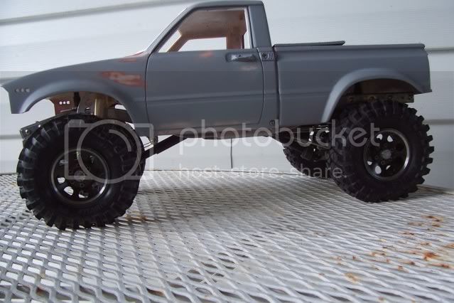

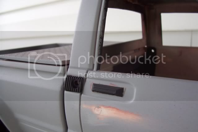

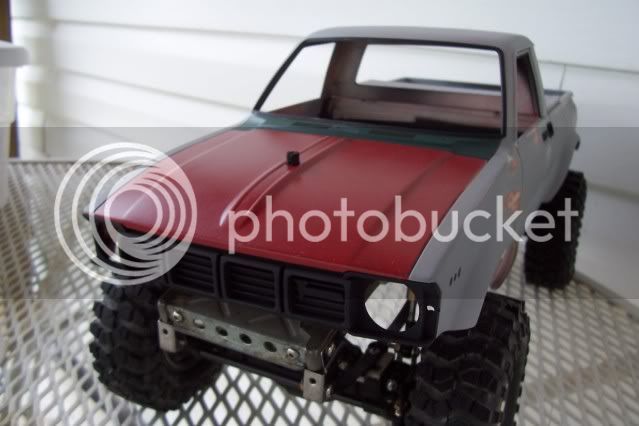

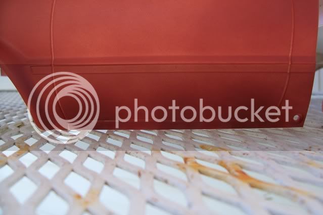

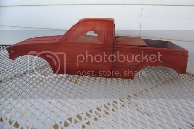

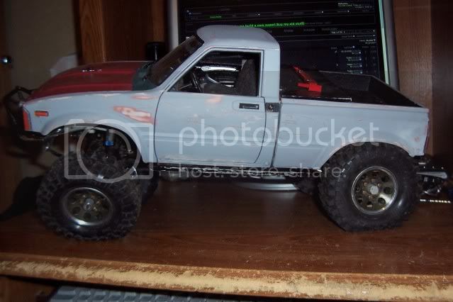

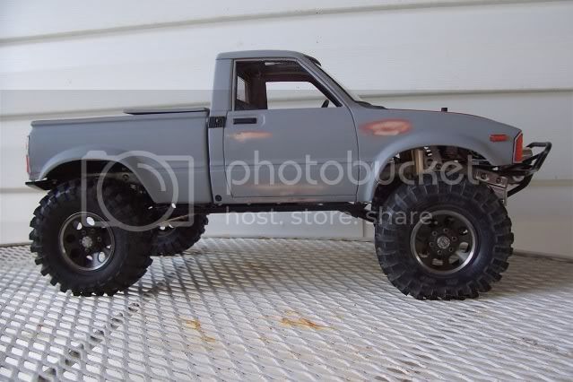

I got some body work done . I repaired 2 small cracks in the bed from where the tires stuff up in the fenders . I also removed the Hilux 4 x 4 badging from the front fenders . I fill the lower door holes that I want be using . My wife likes the look of the sanded out primer spots . Who knows I might leave a few of them . Here is a few pics of the progress .

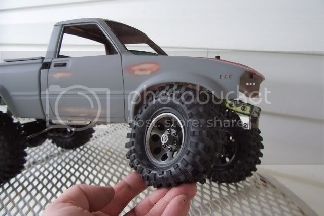

I aslo got some Flat Irons I have not glued them yet . I'm not sure they are staying on .
Here is a few body of shots .

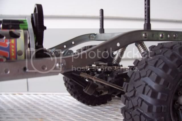

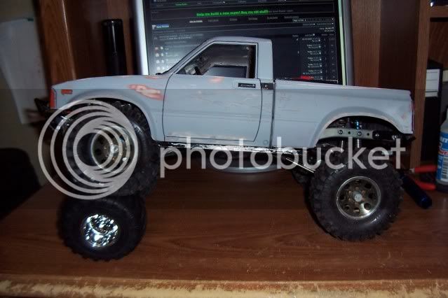

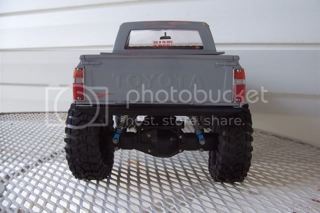

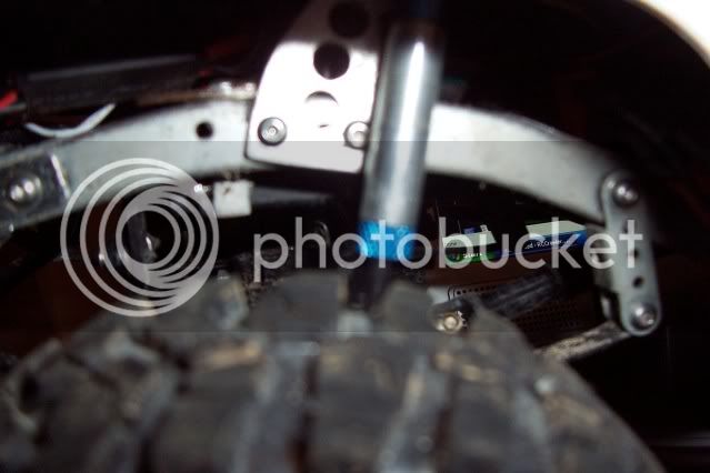

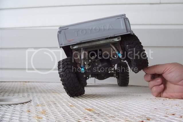

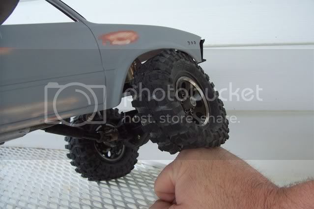

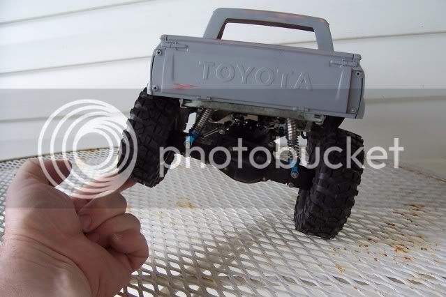

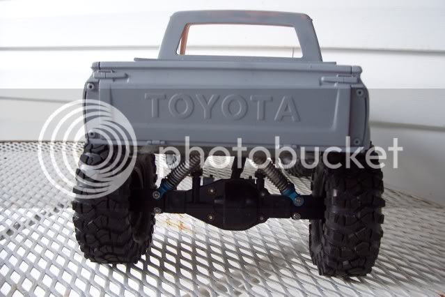

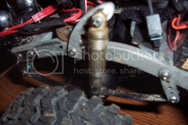

I'm working on getting the frontend slop free . It needed new bushings in the shackles . They where loose as ,well you know what I'm saying . I also worked on the rear links . As the rearend had more swang than Sally from the Valley . If you get my point . My next project will be to get the rear shocks working better . I did a e-clip and pistion mod to the one on my K-5 Blazer and they work great .
This pic shows how bad the axle swang was .
This is after the work on the links .

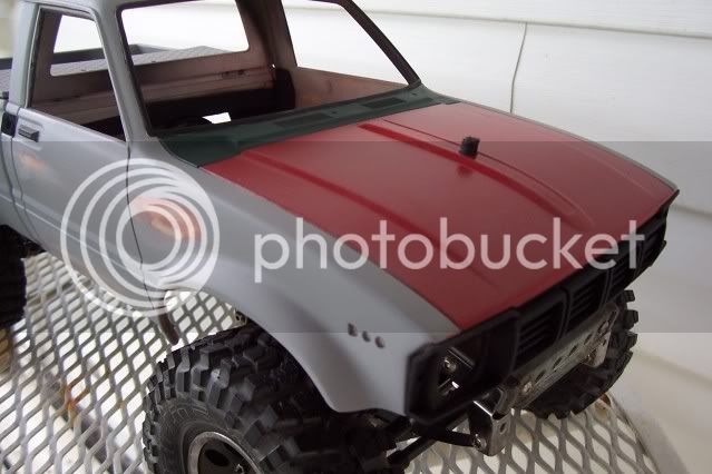

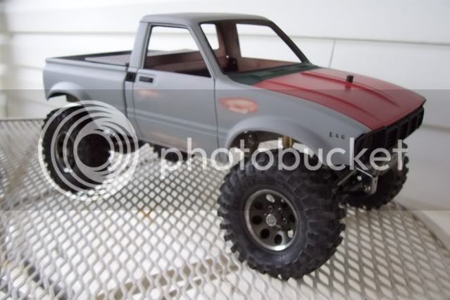

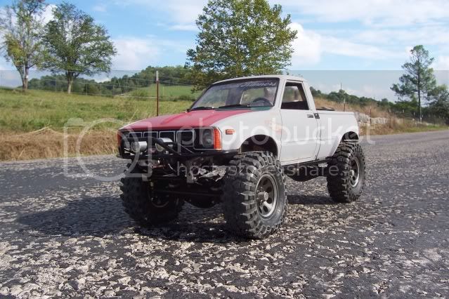

I also stopped by the Junk Yard and found a good hood and cowl . The hood was from a red Yota the got hit hard in the rear . The green cowl was from a roll over . :P
I got a small update .

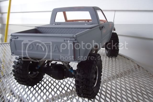

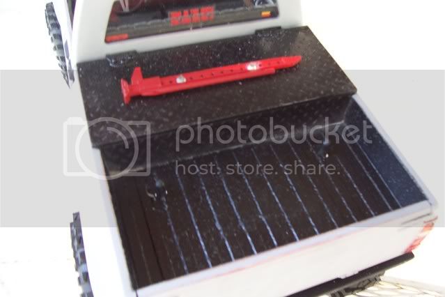

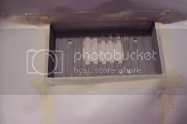

I hated the hole in the bed so I filled it in .
I then used some trunk splater paint and the some black paint over that. I also paint the toolbox gloss black .

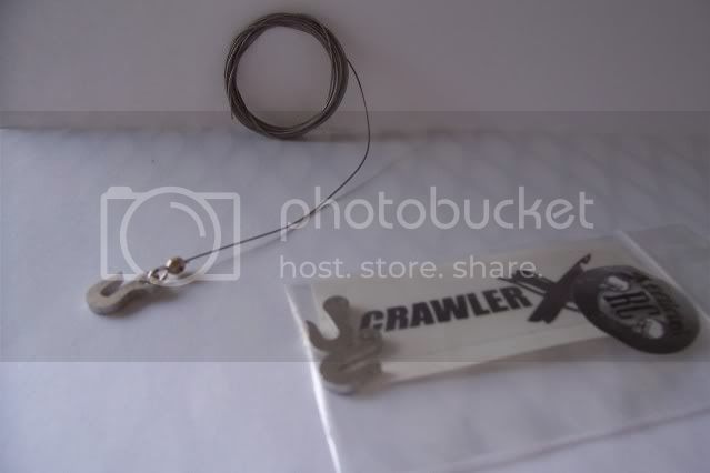

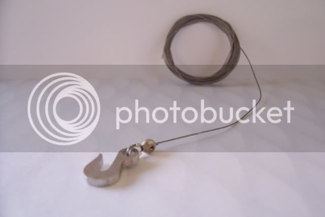

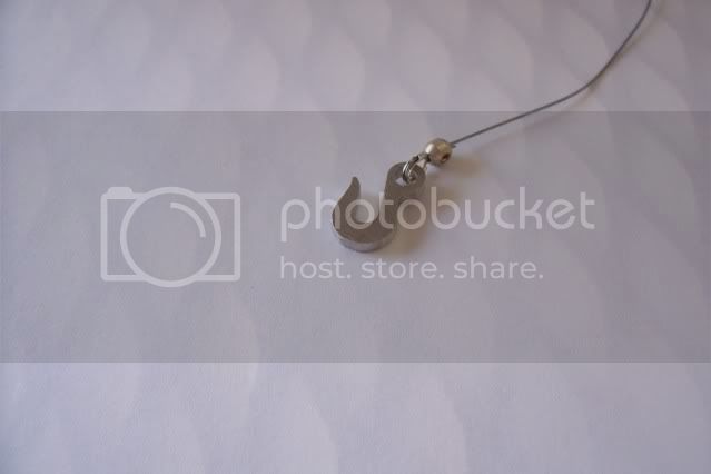

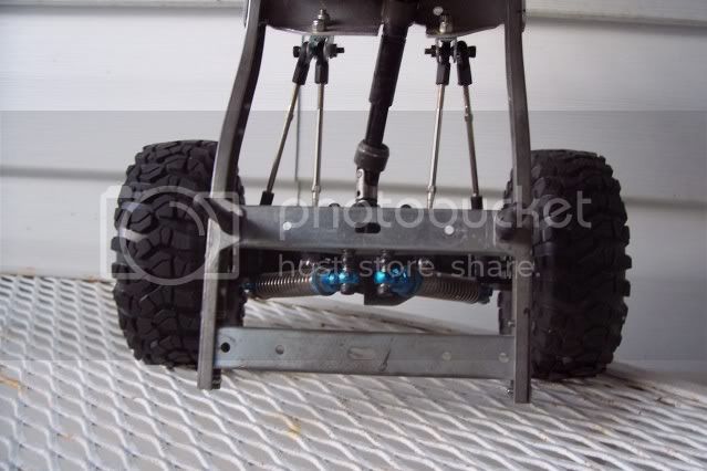

I got the 3 racing winch mounted . I got the winch cable and hook on as well . Again great stuff Kenny . "thumbsup"

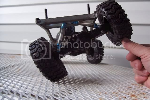

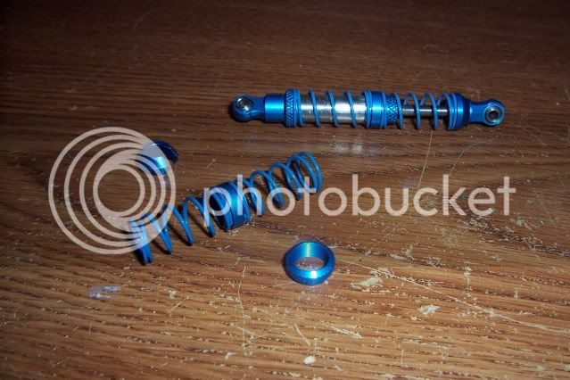

I had a extra set of rc4wd 90mm coilover shocks in my box . The old tlt shocks would not hold oil anymore . So off with them and on with the news one . I pulled the springs off and added some 15wt oil .

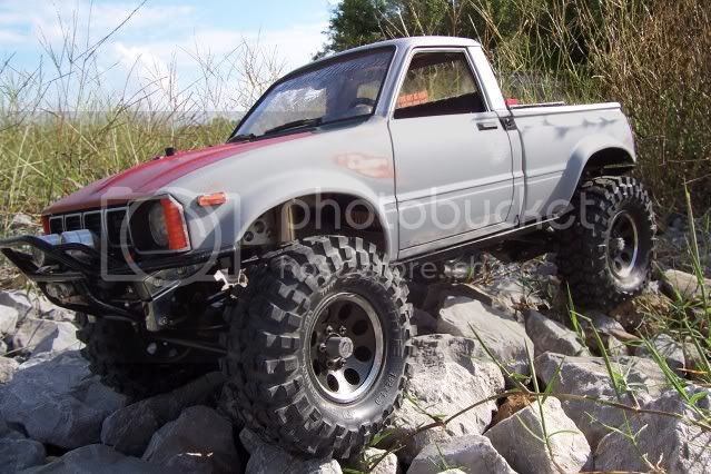

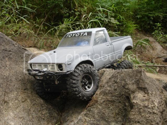

new flex shots
www.scaletrailrunners.com has a gtg this Sunday @ Little Rock City so I will see how well they work.
