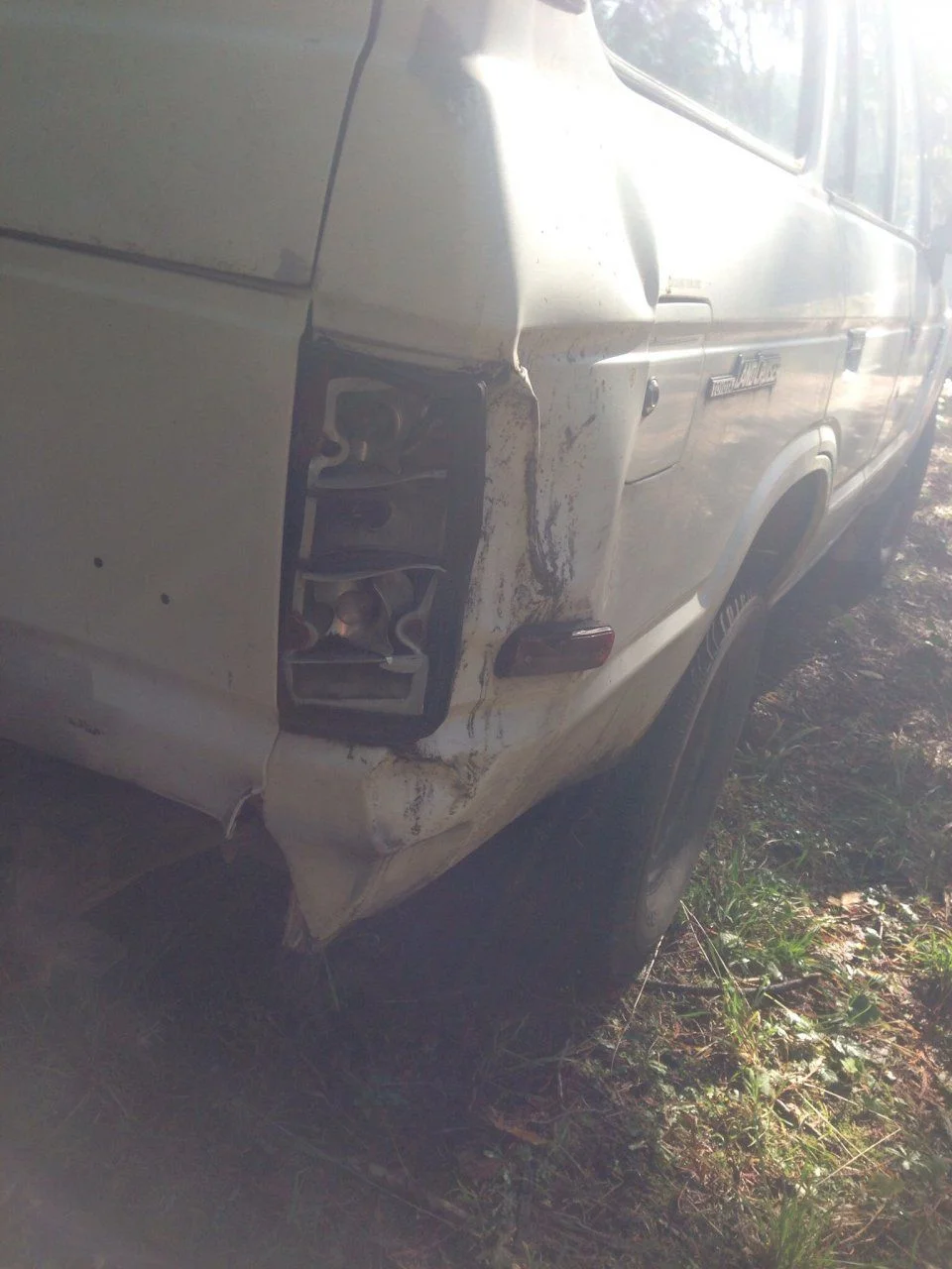

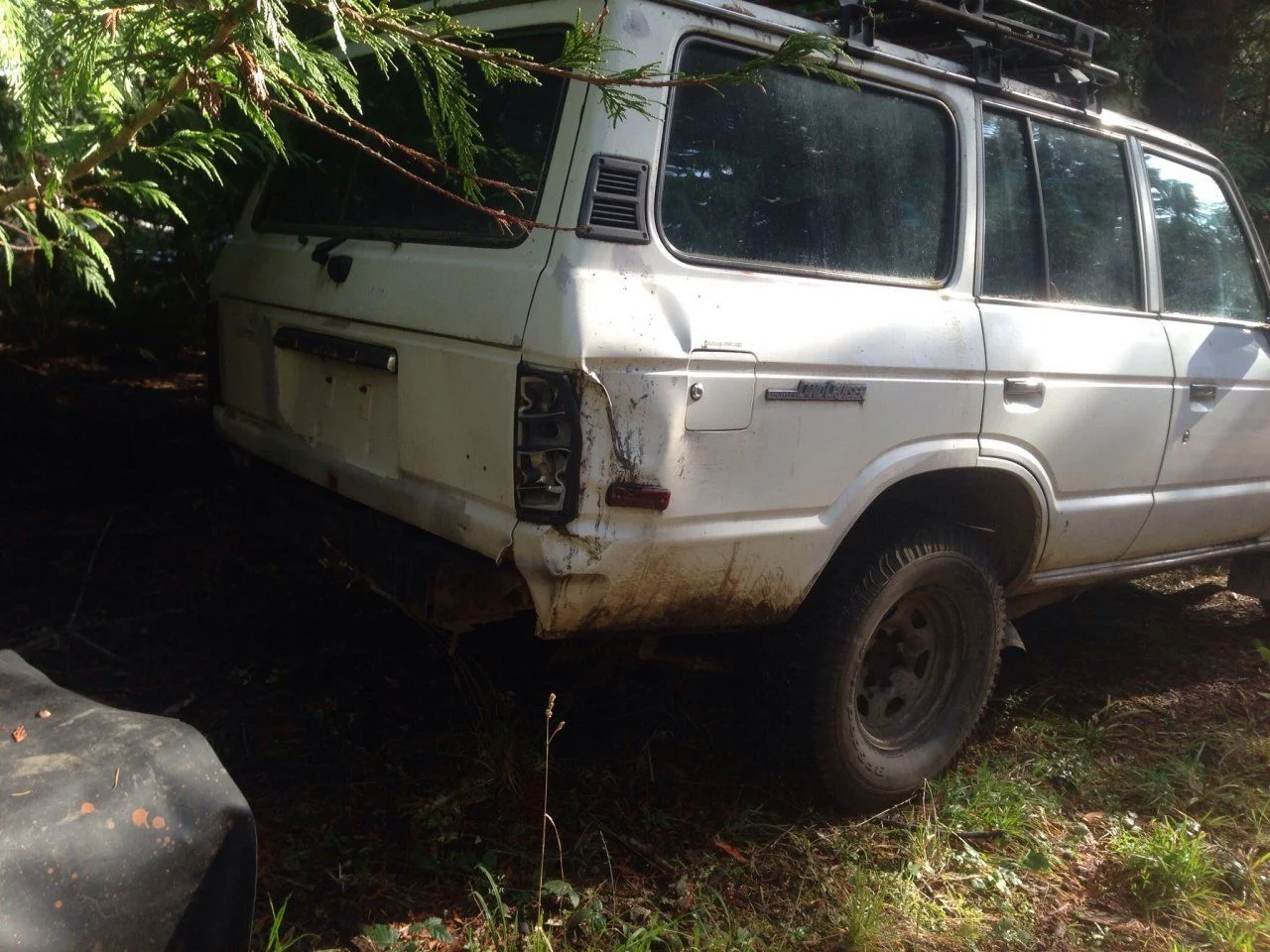

Last year I backed into a cement pole in Mexico with no bumper. Yeah, stupid to drive to Mexico with no bumpers.
I'm not a bodywork expert, but I know enough to know it's not going to be an easy fix.
Would love any advice from those who know more than me on where to even start with this. Any chance of pulling it out? Or would cutting it and welding in a new section be necessary? A combination of both?
Won't let me attach multiple files to a post from my iPad. Weird.

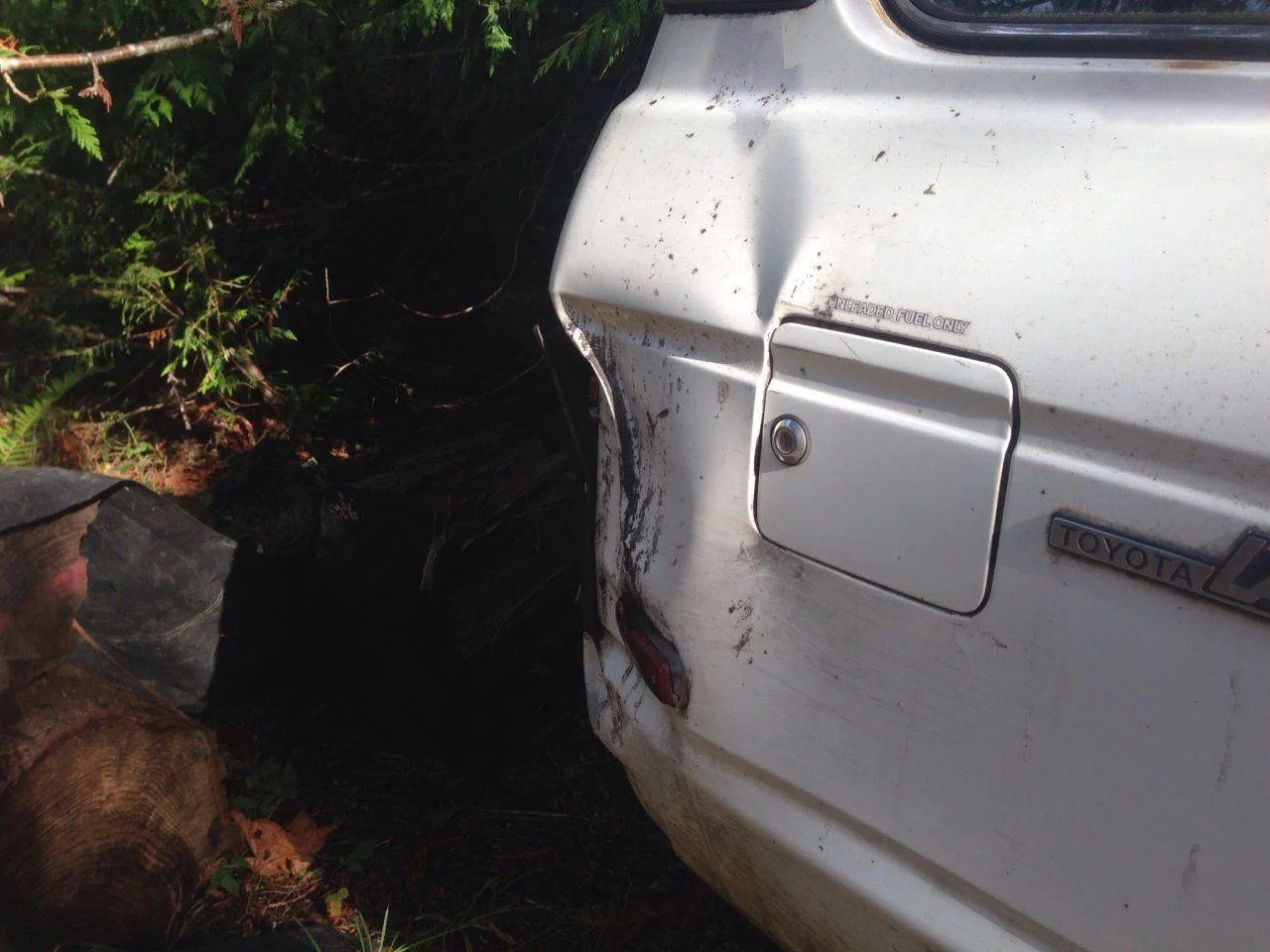

In a separate but almost certainly related issue, she leaks a bit of diesel if I fill up above 2/3 tank or so now... depending on bumpiness of roads and angle of parking.
Ok no replies yet, but my plan so far is to drill a small hole, and push through some steel cable with an anchor on the inside. Then I'm thinking if I apply enough heat, perhaps I can use the 4-low gears and gravity to gently start to pull it out.
Thoughts? Anyone tried this technique??
You're problem lies I working around that filler assy. Plus by the looks of it, you have forced the lower hinge point on tailgate.
To start remove the taillight and inner panel. Get underneath and remove the cover under the filler assy and take bright light and
look around. Drop tail gate and start measuring. Fuel leak means you have ruptured one of about 6 lines that are in there doing
emissions work. You got to figure that out before you start cutting and welding.

Yeah, you have folded the metal right over on itself. That's more that just slide hammer work. So if the truck is
in fact that rust free, my personal response would be to keep it that way and fix it correctly.
