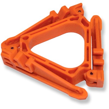

Well executed. I wonder if the Jetboil tripod stand would work. It's got stays for both small and large gas canisters.
The Jetboil tripod is meant to stabilize the gas canister on the ground. In my case the gas canister is on a flat table, but my large cooking pots are teetering on the "arms" at the top of the stove that only spread out a few inches. My stand is build to provide a broader resting surface for the pots. One could combine the Jetbpoil tripod and the homemade stand - you could be flipping flapjacks and omelettes without you frying pan falling off the stove.
