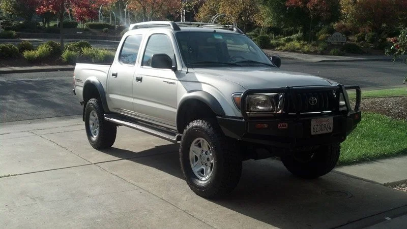

Just a wee update...
*Installed the OME front setup
*Threw on some custom Alcans on the rear
*Picked up a Front Range Off Road rear bumper from a local dude that was moving to something else.
*Picked up an ARB for the front
*Found a killer local deal on some Limited 4Runner 5-star alloys
*After stewing over which tires for a month or so, decided on 285 Nitto Terra Grapplers.
*BAMF weld-on sliders (to be welded on this weekend hopefully)
*Mercer Fab rear frame plates (to be welded on this weekend hopefully)
I'm loving it all so far, though the wheels and tires have only been on a day. :P The 285s do rub a bit here and there and are pretty close to the upper arm so I'll be pinch-modding etc etc (though the truck already had 285s and had already been trimmed a bit beforehand).
I also have to say, I'm diggin the look a lot. I've always been a blacked-out wheel kinda guy, but I'm not sure I'll be going that route with this setup.
(Sorry, lame driveway poser shot for now.)

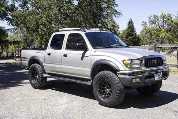

I was looking to put those rims on my Tacoma but had no luck finding a set at a decent price, thus I went with black steelies. I really like the way they look on your truck. I wouldn't change anything else.

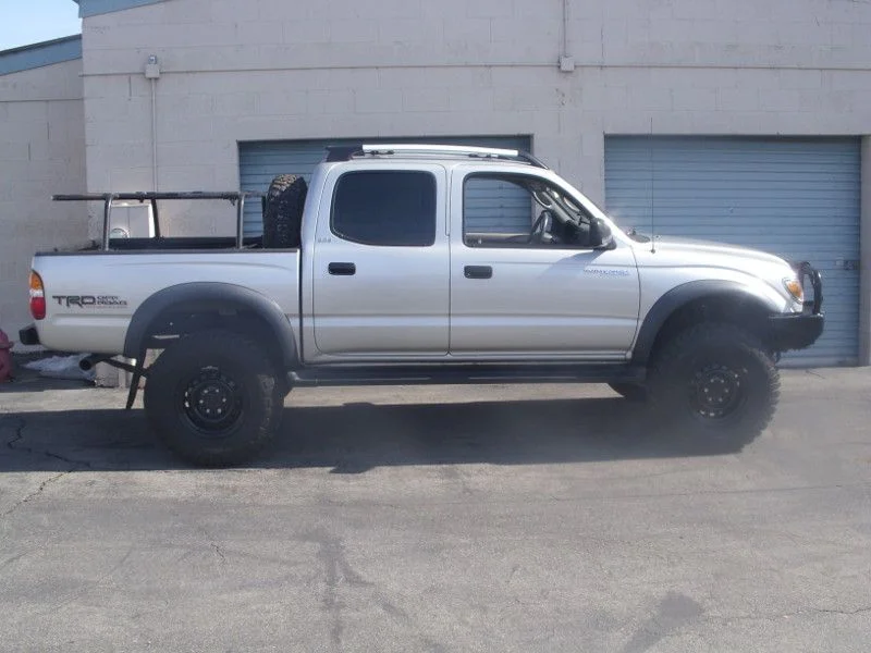

Couple of updates....
  • Had the bed sprayed with a nice liner.
  • Picked up a nice tent rack from a local guy that sold his built Tacoma (gotta repaint it still)
  • Swapped to 255-85/16 BFG KM2s on a set of 16-hole "spare" steelies

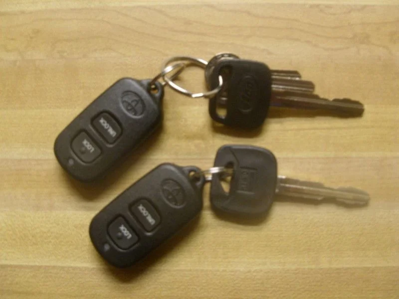

  • Added factory RS3200 keyless/alarm (my favorite mod so far :) )
  • @107K miles, Full timing belt kit done and new plugs and wires.
Also picked up a 4x4 auto tranny and j-shift tcase combo in preparation for 4wd conversion. :)
Looking good! Did you get that keyless entry/alarm at the dealer?
Thanks man.
The keyless setup is sort of from the dealer....its all Toyota and plugged right in.
Its basically 2 parts: the wiring kit and the ecu ("base") kit. The wiring kit has been out of production and unavailable for many years (I found threads dating back to 2006 where people mentioned it was no longer available).
I setup an ebay "saved search" for both and ended up finding the wiring kit on there. Then I called CruiserDan for the base kit--which by the way is also out of production now too, but Dan found a few of them.
This is only for the 2002. The 2001 is different and the 2003-04 is also different. And I think some of those are still around and easier to find.

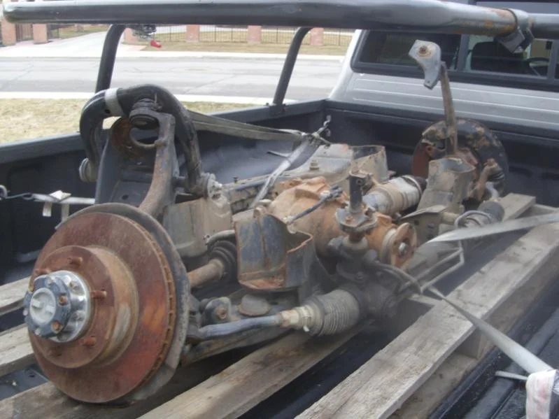

Got that sucker torn down into some manageable size pieces tonight--2 spindle sections, the diff, and then the rest. Only problem is I was in such a hurry to bust it down and get it out of the back of my truck, I didn't want to wait the proper soak time of a week or so for the PB blaster to do its magic, so I ended up breaking 3 of the 5 bolts off that were holding the lower ball joints to the spindles (lucky for me some were already gone or I prob would have more broken ones to deal with...) So thats gonna be fun trying to get those damn things outta the spindles now.
Stoked at how easy to break it all down it really was though--even by myself. Helps that I've been in these front ends a few times before though. Should easily be able to get it all in the truck in one night/saturday with some help.
So you now have the front drive train, so me being ignorant in the 4x upgrade, do you have to swap a different trans in or just change out the tail-shaft housing and bolt up a T-case?
On the broken bolts, are you talking about where they go thru the arm itself? Can you use a socket and a C-clamp or a press if you have one to just press the remainders of the bolts out of the arm with the LBJ still attached?
If my memory serves me, and it doesn't sometimes, but aren't the bolts thru the LBJ a stud that is pressed into the LBJ that then takes the nut after installed in the arm.
To the trans question, its sort of like what you said... First, it has to be from behind the same engine (V6 vs 4cyl--and i think that is mainly for the bell housing and torque converter...but im not sure) After that, the 2wd tranny is the same tranny but with the different shaft and tail housing. You can use the same tranny, but it requires the different output shaft from the 4x4 version, along with the 4x4 tail housing, then the case bolts right up. I found a smokin deal on a complete 4x4 tranny w/ tcase so that's what I'm using. If I run into any issues, I can always swap the 4x4 shaft into my original tranny.
As for the bolts I broke... unfortunately, they aren't quite like you're thinking. They bolt up through the LBJ and thread into the bottom of the spindle. So I'm gonna have to unthread them somehow (or drill and tap which I really really don't want to do). I'll be soaking them like crazy and hoping I can unscrew them somehow from the little ends that are protruding out. Might have to weld a nut or something on the ends of them...
Can you use a set of reverse drill bits to try and back them out from up top, other idea would be to cut a groove / slot in the bottom side and using a impact driver (the kind that you actually hit with a hammer) to try and break them loose. Otherwise, your welding a nut on sounds pretty easy if you have the welder handy.
