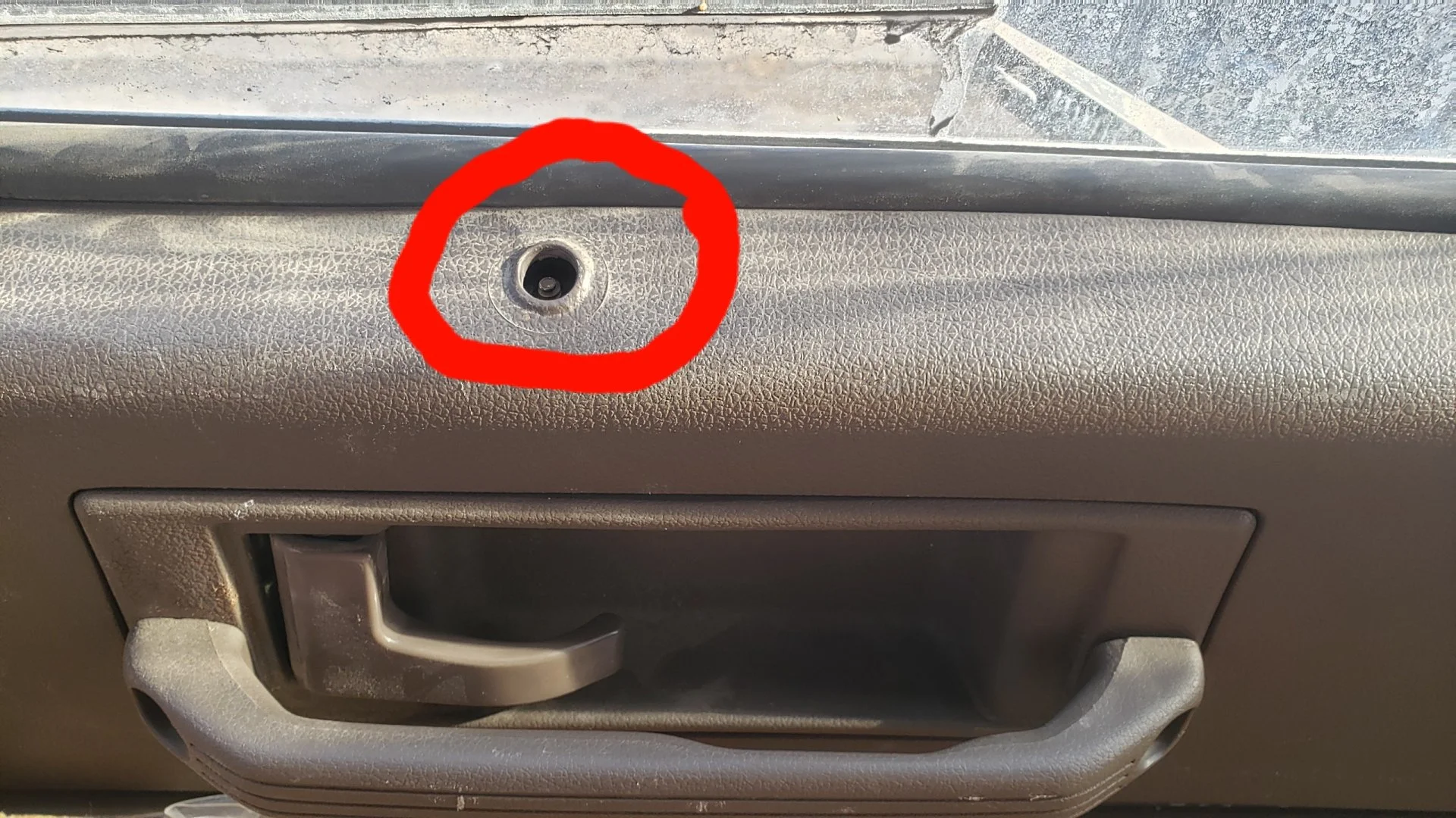

OK. So.... Maybe a year or two ago the power unlock button stopped working for the back door. It would stay locked.
No problem. Use the key to unlock it right? OK so I move to my back up plan and have used my key to unlock the back door. Except, for the last few months the keys has works sporadically.
And today it doesn't work at all. I'm forcing almost to the point that I'll break the key and it just isn't budging.
There is a mechanism on the inside that unlocks the door very easily but mine appears to be missing something. Can anyone confirm? Is there a part I can purchase that would screw right in and allow me to unlock from the inside until I figure out what to do next?
Hmm my motor in the back gave out and that was the source of my issues. I could not unlock via anything but the key. If you take of the handle and pop off the cover you can see how it all actuates. Other than that maybe your key cylinder is gunked up. That’s where I’d start!
Yesterday I opened my rear hatch up and found there was a plastic piece inside the electric door lock motor mechanism that was cracked where it wrapped around the shaft that actuates the linkage. The motor was still spinning in there when you pressed the door lock buttons but this piece wouldn’t turn the shaft because it didn’t have enough grip on it (because it was cracked). I cleaned it up and put a little bit of epoxy on the shaft and slid the cracked plastic piece back on and now it works again (for now). I also cleaned and used white lithium grease on all the linkage while I was in there.

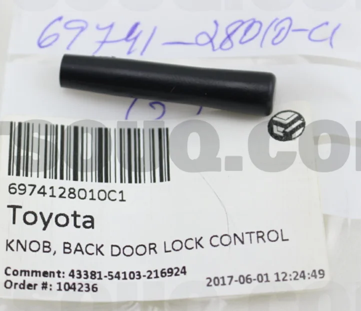

I think it's:
69741-28010-C1 Knob, Back Door Lock Control (Black)
ill take off the handle and cover eventually. gotta clear out the junk in the back first. I'll look more info on the key cylinder and see if i can find a way to ungunk it. was hoping for a cheap and easy fix. thanks again

I think it's:
thank you! some of the other parts databases i looked at didn't show this. I'll see if this is an option.
