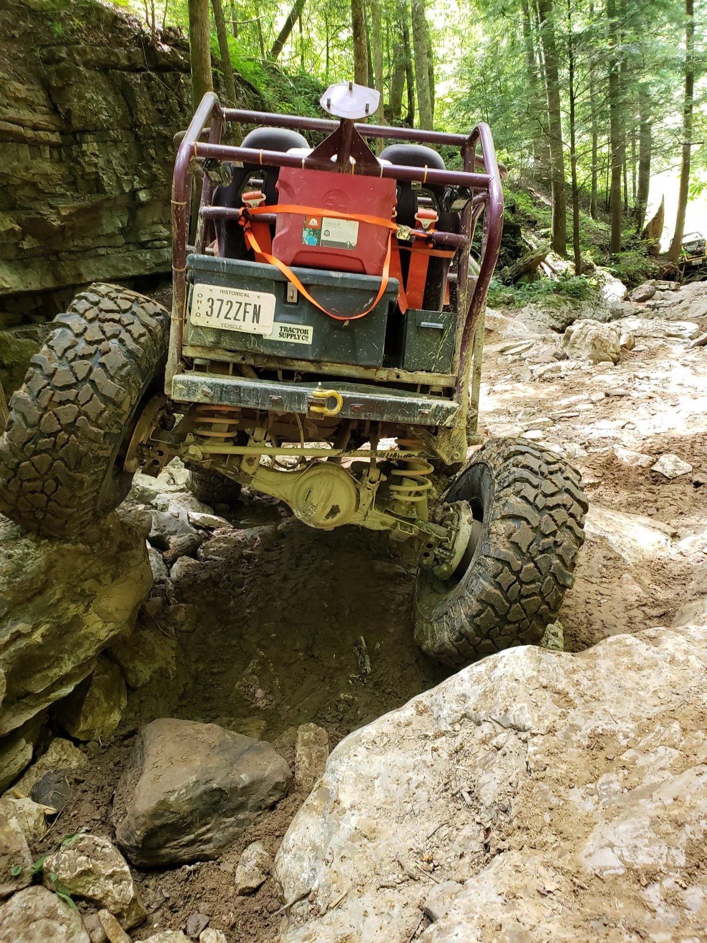

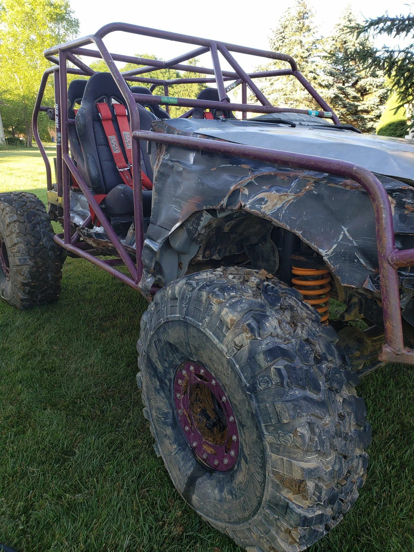

I'm at the point on my 80 buggy where I either swap tons or put more money into my axles. Plans are also to engine swap possibly to a 6.0. How far are you guys taking built 80 axles? Mine seem to be doing fine so far with the 3fe on 41.5 pitbulls but it feels like I'm just waiting for something bad to happen
