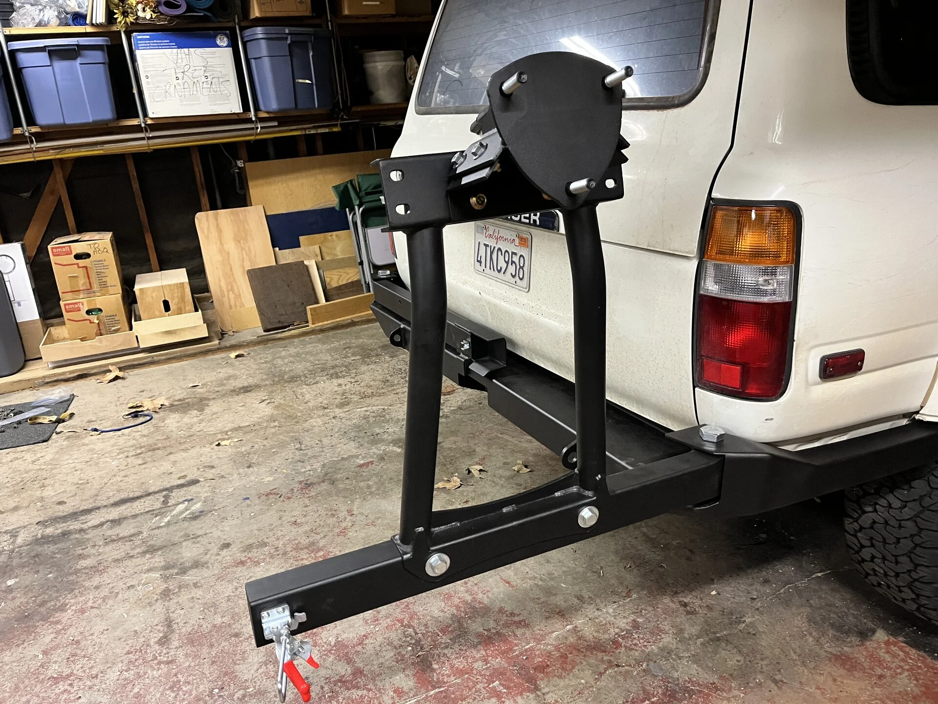

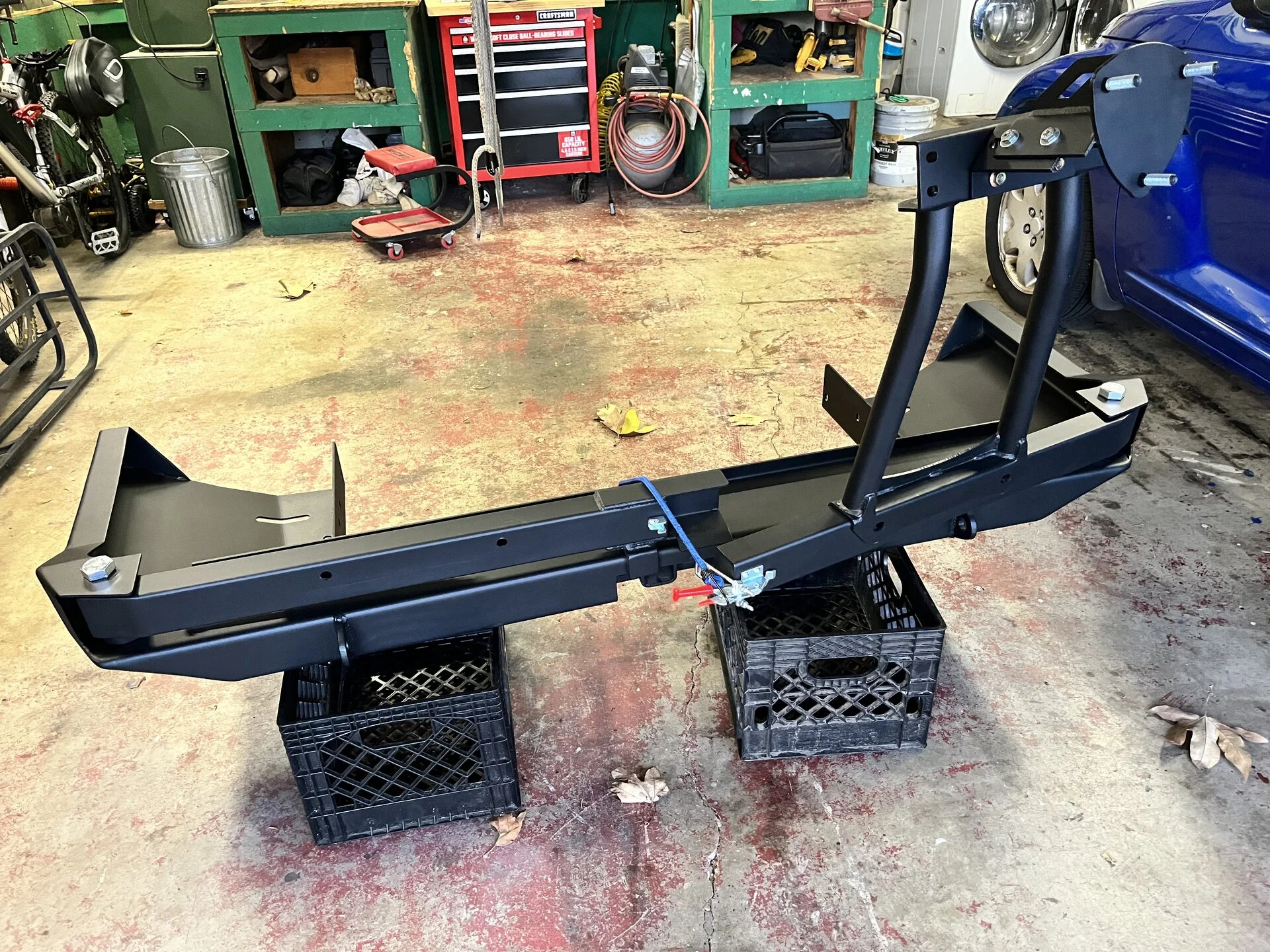

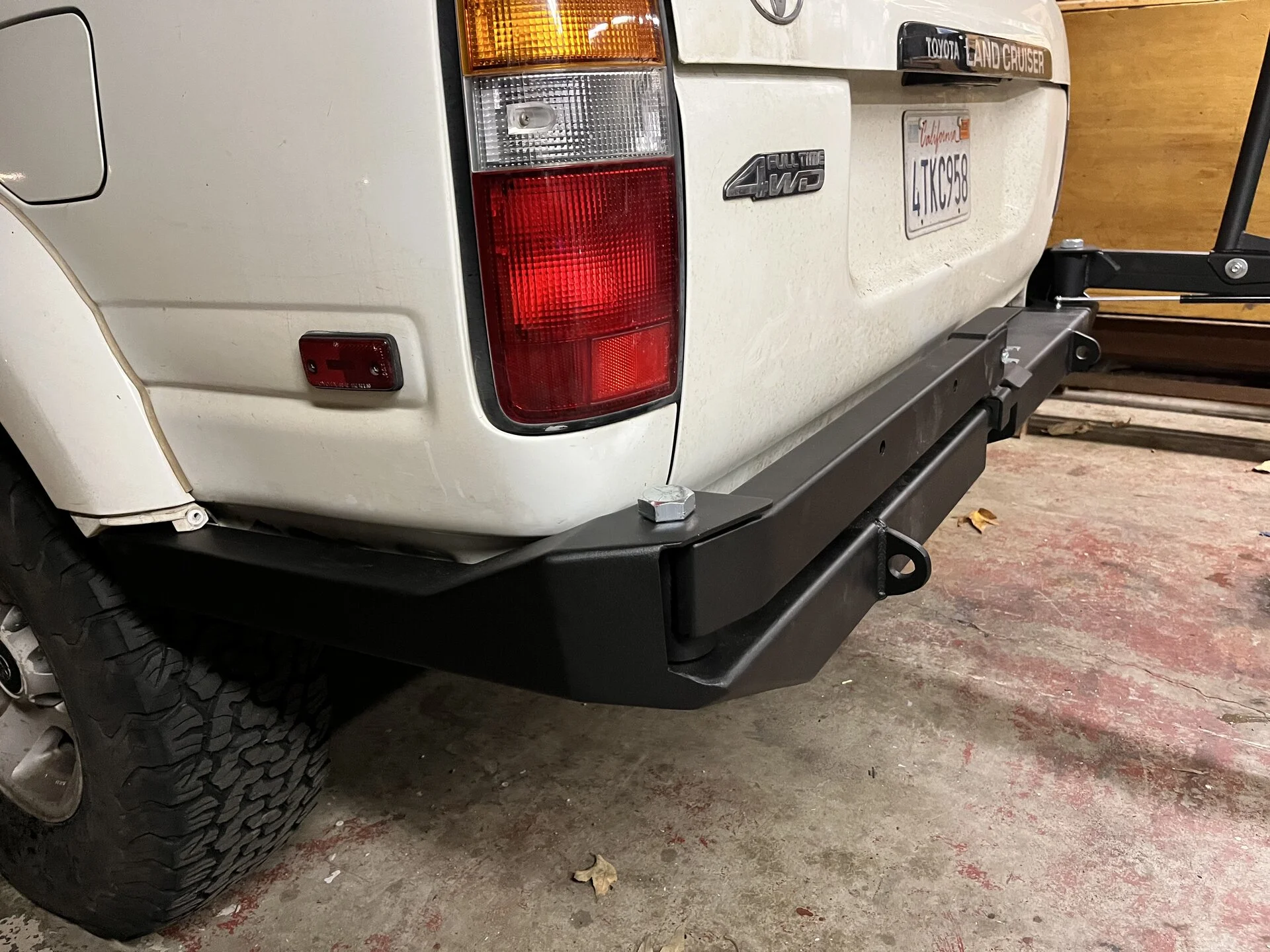

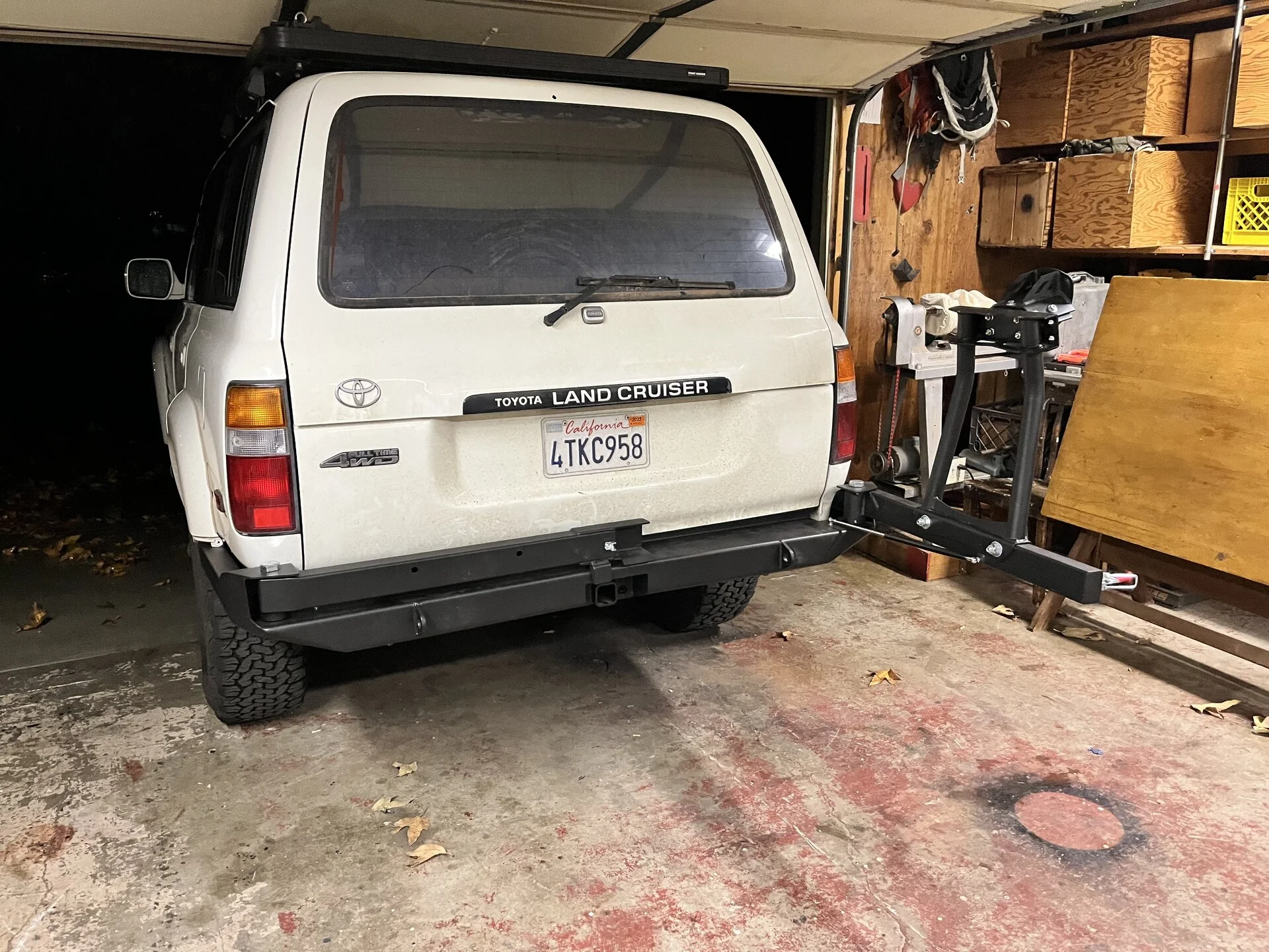

Over the weekend I installed an Avid rear bumper with dual swing arms. 80% of the effort involved removing the original pieces, cutting 3.5” off the end of the frame, and cleaning up the old weld lines. Once that was complete the installation went very smoothly. I don’t have a lot of experience with such parts, but I am an aerospace engineer, and this was a quality piece of work.
Only one mild gripe … they did not include new mounting fasteners. The old ones kind of work but they really should have bigger heads and beefier washers. I found a great selection of such stuff at Belmetric and will swap them into the vehicle when they arrive.

No turning back when the angle grinder comes out... :clap:
The bumper looks good.
Too bad to hear about the 2" receiver hitch issue.

How much does it weigh?
Not sure exactly. I think that FedEx had the pallet at 180lbs. I would guess the bumper with the swing arms is 120 to 150 lbs. Enough that it feels heavy when two decent sized guys lifted it into place. The mounting fixtures for the spare tire and the Jerry cans are probably 20 lbs each. The sheet metal is 3/16”.

What were the bolt patterns that you ordered from Belmetric?
I've been waiting for over a year now and it's starting to get frustrating. I was originally told 4-5 months, last May.
I ordered hardened, flanged bolts. I think they were 13mm? My memory is that I replaced only the larger bolts and used the smaller ones (8mm?) from the kit. The mounting holes in the bumper are somewhat oversize to accommodate variations in the hole locations and help get everything aligned. I thought the flanged bolts were a good call to avoid pulling the washers into the holes. I saw deformed washers when I took out the previous tow hitch.
