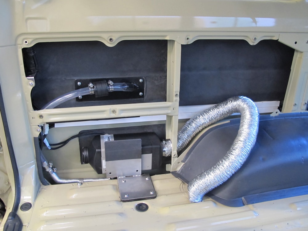

I had a Webasto Airtop 2000 in my trailer that worked very well. It'll heat a 60 interior easily. Looks like this guy installed his under the hood. There are a bunch of knock-offs that van folks seem to be happy with.
That looks awesome. Does it have its own diesel fuel line to the fuel tank or is it tee’d off the fuel line to the motor?
They come in both diesel or gas. Mine had it's own fuel tank but download the installation manual. There are several ways to install it. I would also consider installing it in the rear quarter panel.

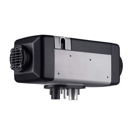

Webasto Air Top 2000 STC 12v diesel with temperature controller rheostat
Includes controller, 1m of hot air ducting and 1 outlet! (not shown in pictures) - please refer to description
A compact, quiet, and economical heater. The Webasto Air Top 2000 ST C offers optimised fuel efficiency, This is the most compact Webasto heater with a heat output of 2 kW. It has an impressively low level of electric power consumption and low level of diesel consumption of just 0.12 - 0.24 litres per hour of heater output operation,
whisper quiet heating.. This air heater can be installed in addition to conventional heating systems for optimum comfort.
Webasto 2000 STC 12v Heater kit contains:
  • Webasto Air Top 2000 STC 12v diesel heater
  • Temperature controller rheostat
  • All electrical harnesses and connections
  • Black Webasto Air Outlet - 60mm / 90deg
  • 1 Meter of APK Ducting
  • Stainless steel exhaust pipe
  • Combustion Intake pipe
  • 1 x 60mm Air outlet
  • Fuel system with 8mtrs plastic fuel pipe
  • Fuel metering pump
  • 1 metre 60mm flexible ducting
  • 1 x Air entry grille
  • Kit supplied with 8mm fuel t-piece
  • (does NOT include fuel standpipe – please enquire if required)
  • All necessary clips and screws for standard installation included
Made in Germany
Found a quarter panel install for you...
