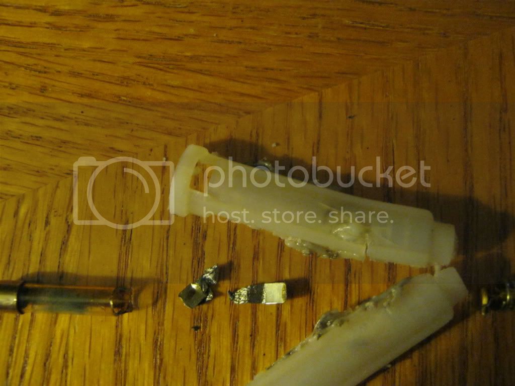

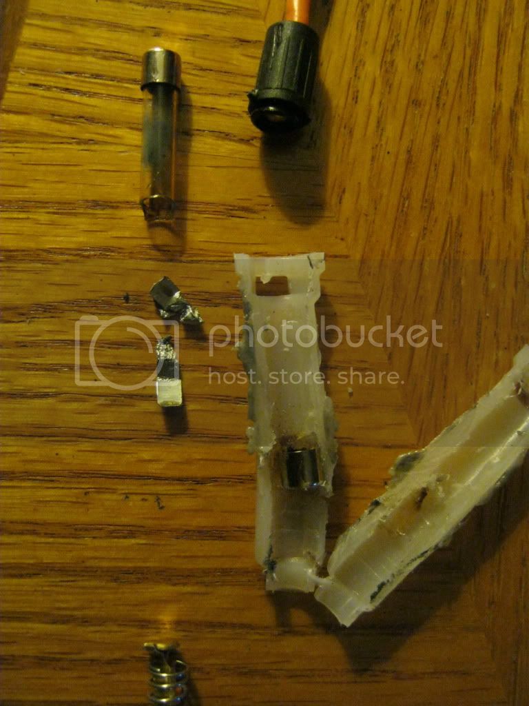

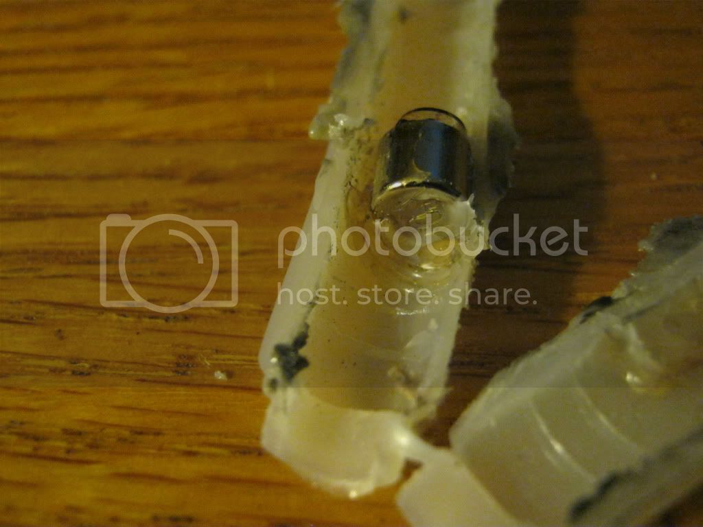

When or if you install aux lights that don't come in a kit that you buy at a store, don't make the mistake I did. You might think that an in line fuse holder would be sufficient to protect your equipment. Well, most plastic fuse holders are good for 5 or 10 amps, maybe even 20 with a quality design. They have a max rating which you should be aware of when you buy it. Putting a 30 amp fuse in a holder that's cheaply built or not designed for the current will result in this:
I cut the fuse holder open with a Dremel tool to discover what I could. The fuse holder came with 12AWG wire attached to it, so I figured, it would handle the current; wrong :rolleyes:. The internal spring is not sufficient to prevent the ends of the fuse from heating up and melting the fuse holder and, thank God, blowing the fuse, before starting a fire. Look at the remnant of the fuse, melted to the white plastic holder and the cap contact that I'm holding in my hand:
This is what you want to use for high amp protection:

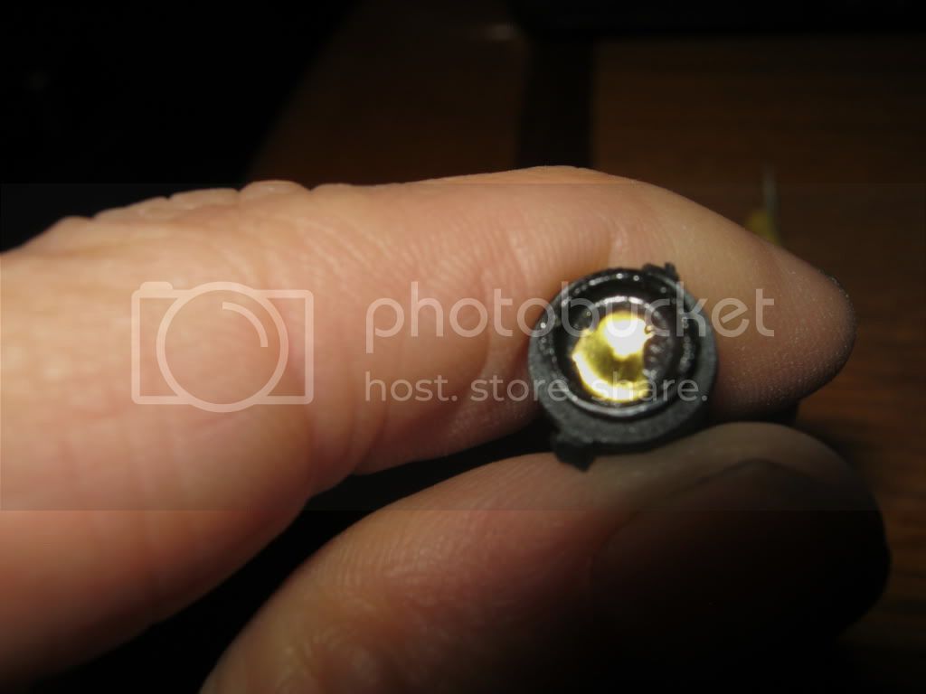

Available at auto parts stores or electrical suppliers. A circuit breaker. The current type 1 CB will cycle between open and closed until the load drops below the rating. (EDIT: I recommend using a type 2 or type 3 CB instead of a type 1 since operator intervention is required before power is returned to the circuit. Reason being that it was brought up in a later post in this thread that if there is a short, and it goes unnoticed, the contacts inside the CB could "weld on" rendering the CB useless and causing a potentially dangerous fire hazard.) Make sure you get the correct size and use properly crimped terminal lugs to terminate to it. Any loose or bad connections will heat up and become a problem to other wires or components around it. If you look closely at the holder in the following pic, you can see the evidence of overheating, which was my 1st clue that my problem was more than a blown fuse, when my aux lights failed their 1st test:
That's why I cut the ***** open with the Dremel.

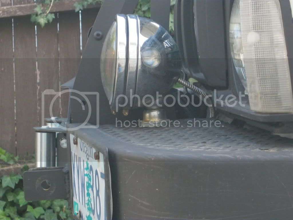

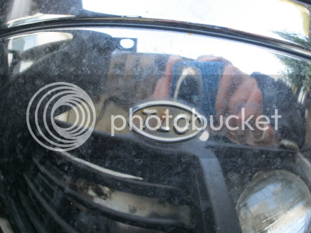

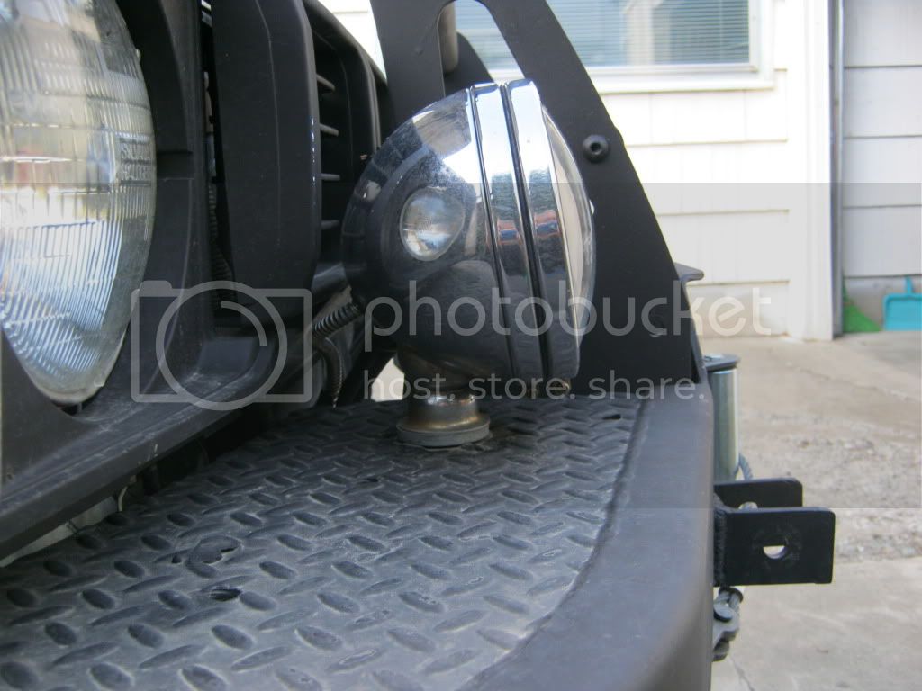

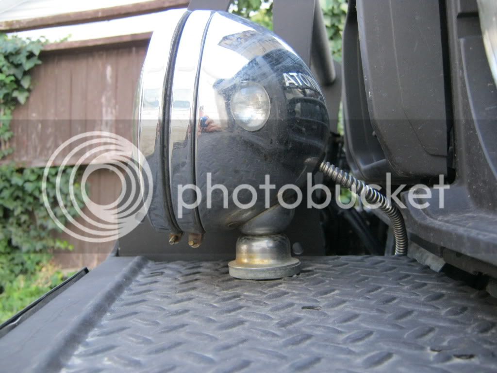

Thanks. They're 6" and have a TLC logo on them. They were on my rig when I bought it, just not hooked up. Chrome housings, kinda remind of the KC Daylighters. I'll try and post pix of them later, I'm at work now. But, they're bright. And they get hot, too.
Here's a pic of the logo on the light
That's all I know on the brand or model. Tried googling TLC lights without much success for ID'ing the model or candlepower.

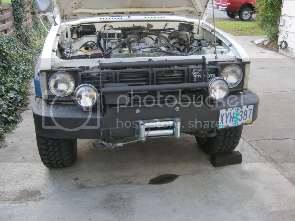

Some more pix on the looks on my rig:
I like the way they mount - solid and easy to adjust.
And are they bright? Wow! On the 1st test the other night, the fuse lasted about 5 minutes. When it died I thought I was going blind:rolleyes:. You get spoiled easy. I'll try to get pix of the difference in illumination when I get the chance for another test.

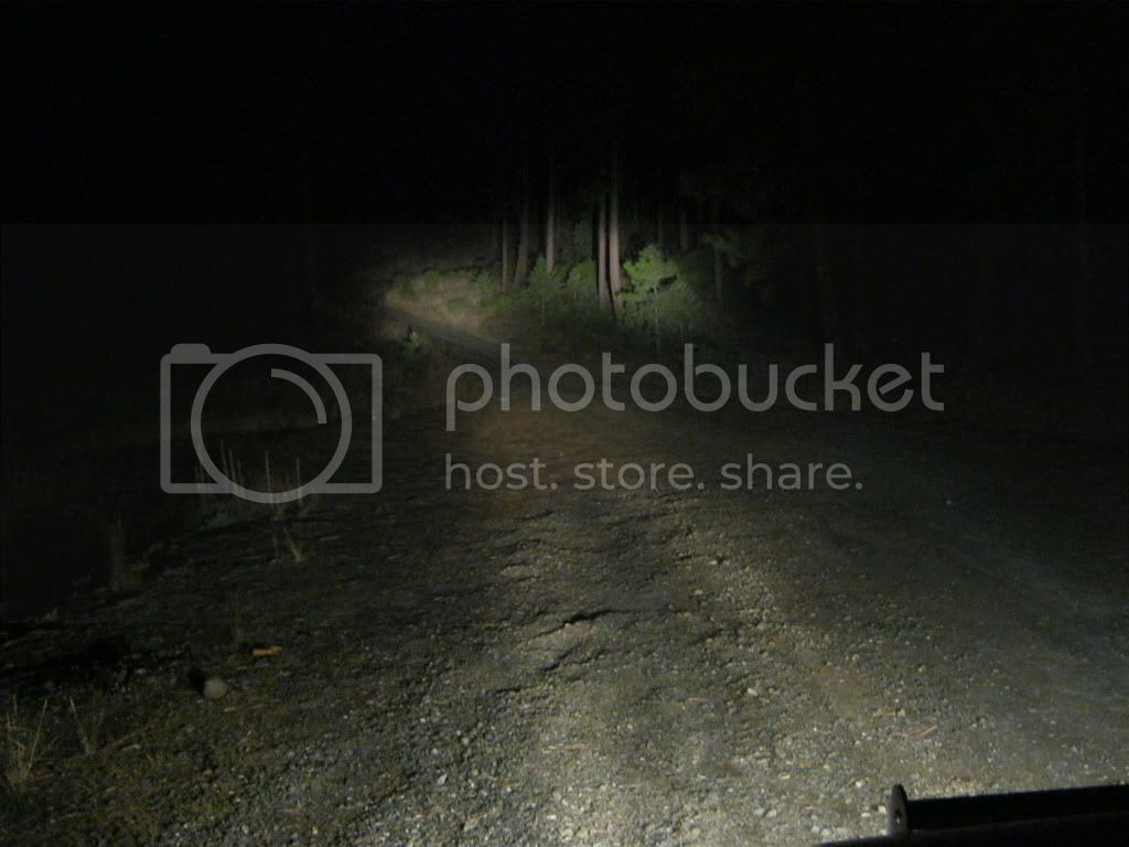

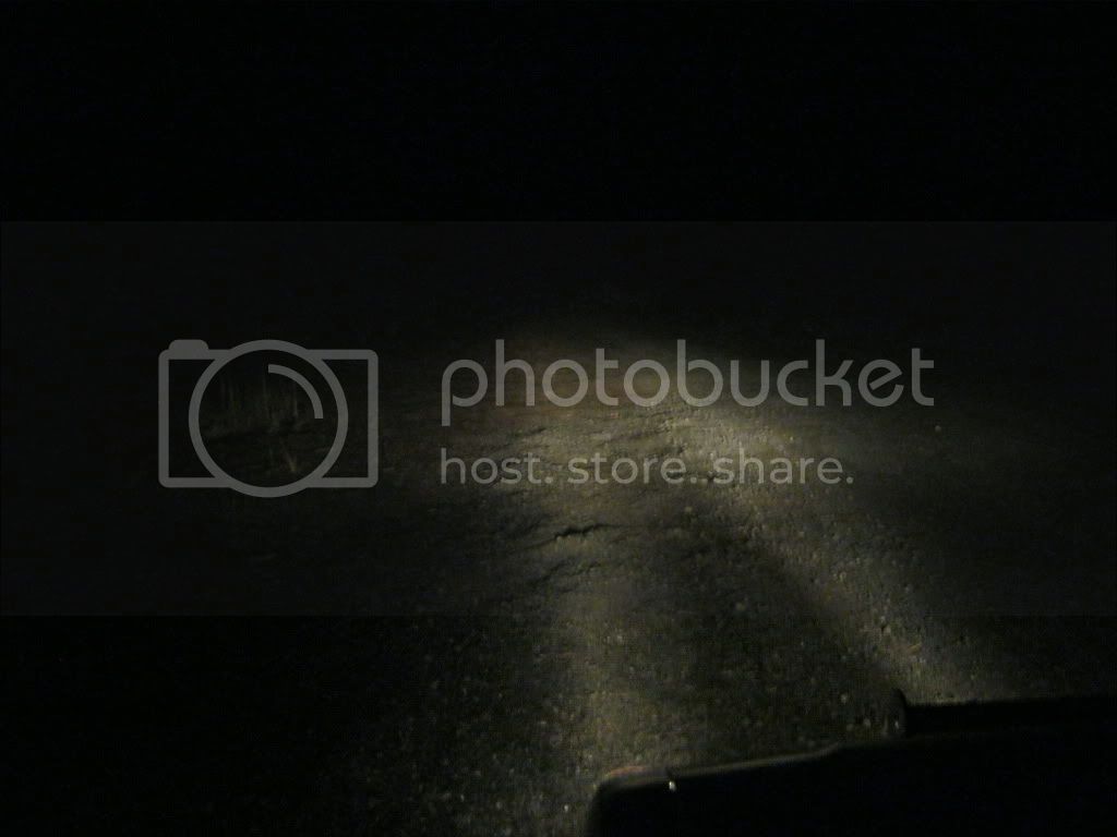

This is low beams:
High beams:
TLC aux lights & high beams:
