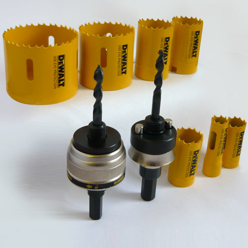

I bought a firewall boot to make the install perfectly clean. Now i'm wondering:
What sort of drillbit would you use to drill a 1.25in hole in the firewall?? A stepped bit? I have no clue..
