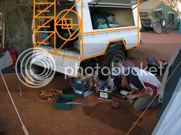

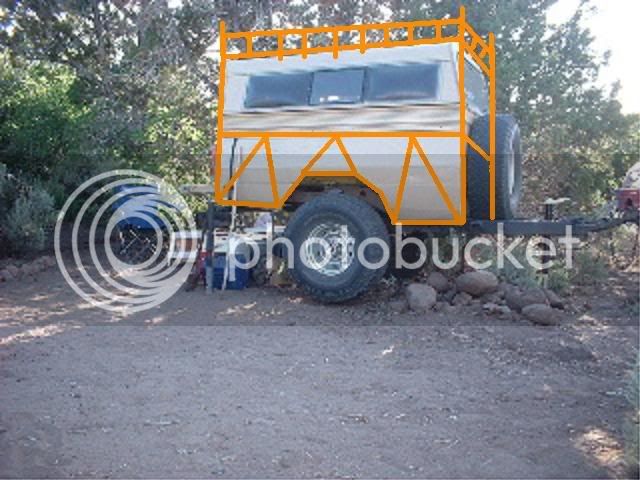

ok heres some horible pics but i think u can kinda get the idea, basically i plan to get a contractor style camper shell with the actual door style rear door so it's easier to get into and out of
so i know the pic of the rear is kinda confusing but the plan is to have like a swing out style bumper but it will be doors 1 to open to either side and lockable in the open and closed positions (in the open position im gunna make a canvas auning to give a porch for if its raining) tire carrier on 1 side and water or jerry cans on the other the top will be taller than it needs to be to give a full lenght basket (im debating on this if i do it it will probly be removeable so i can take the shell off and haul something tall if needed) and the points above the basket will be to act as a lumber/ladder rack so i can tie off whatever i might need to put up there.
ill probly trim the lower parts of the pannels and make some kind of sliders cause my trailer should match the tow rig right.... any way well see how it actually come out but, what do you guys think other than that i need to get a real photochop program?
