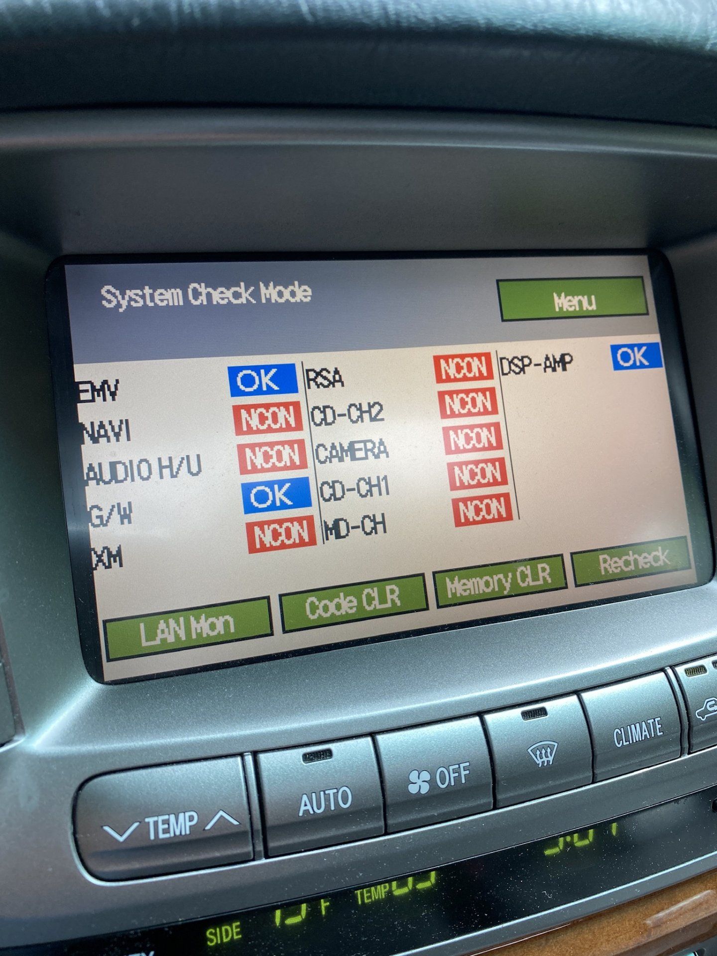

Hey there, 2006 Lexus LX470 - was driving the other day listening to music via Bluetooth when all of a sudden the audio cut completely out. The stereo does not respond at all, no maps pull up, no backup camera - but AC control still works. The only screens that work are Trip Information and Climate. I have tested fuses (all ok) and even disconnected battery for a while in hopes of a reset - no luck.
I have read about a bad amp but that seems odd given problem with navigation. Got into Diagnostic mode and basically most systems show not connected (pic below).
Any ideas appreciated; taking to dealer will be last resort!

“Listening to music via Bluetooth” would imply that an aftermarket “box” (Grom/USA Spec/Vais) has been added to the stereo/nav system, to allow Bluetooth streaming. I had similar issues when one of my add-on boxes quit working. I’d suggest temporarily disconnecting the aftermarket “box” while you troubleshoot this issue.
I do have an aftermarket Bluetooth device but I’m embarrassed to admit I missed the one 10 amp radio fuse under passenger dash that was causing the issues. Thanks for jumping in to help!
