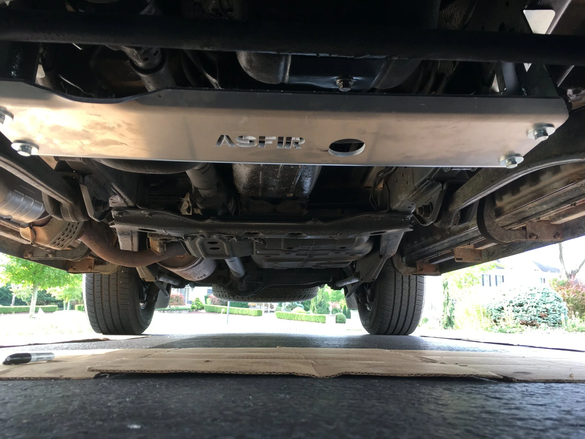

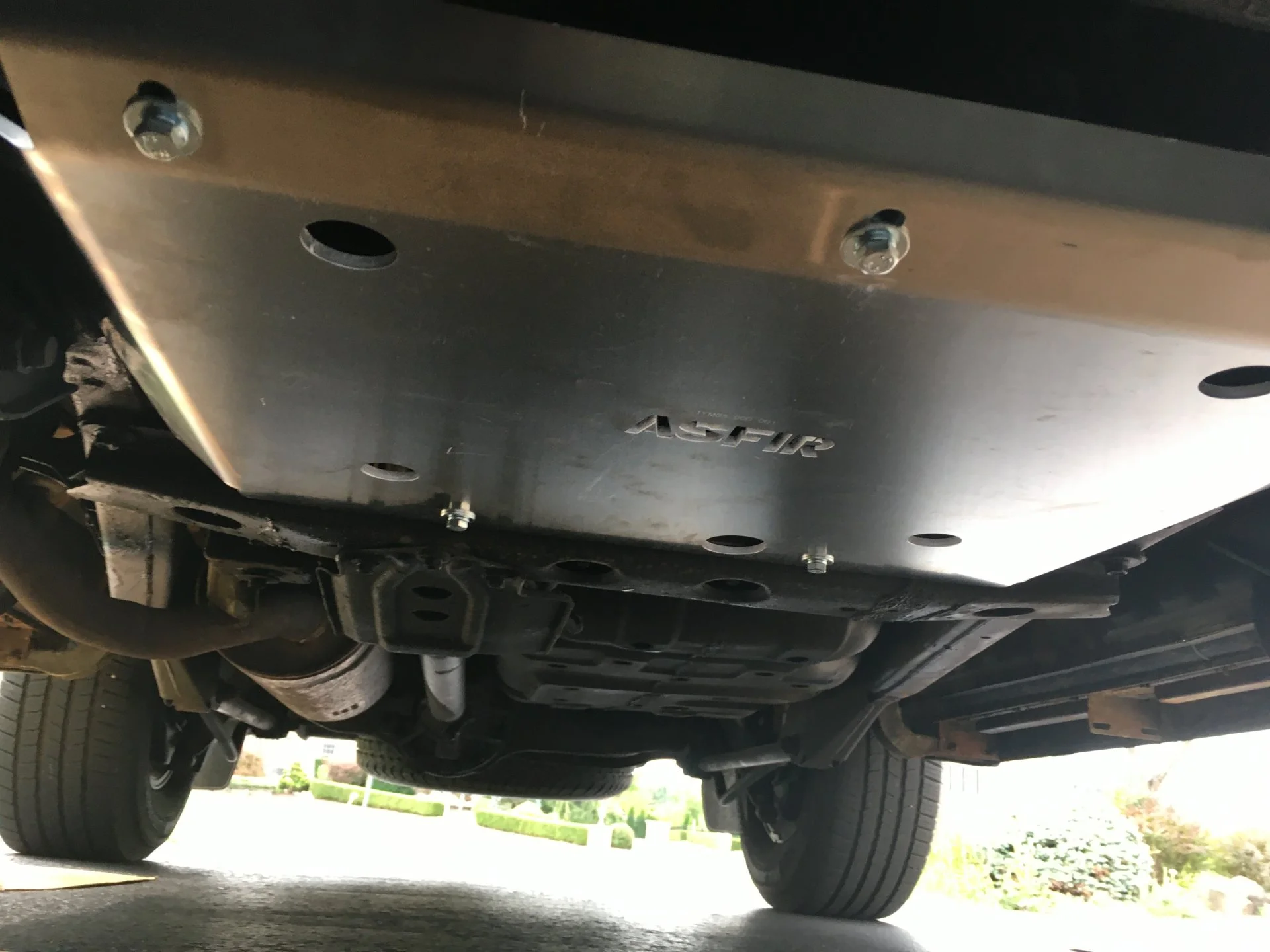

Just to provide an update. I finally decided move forward with the 3 pieces Asfir kits. The shopping experience was pleasant. The sale team was very professional and straightforward about untested fitting for LX450.
I can confirm the bolt patterns are the same for LC and LX, so the fitting isn’t an issue.

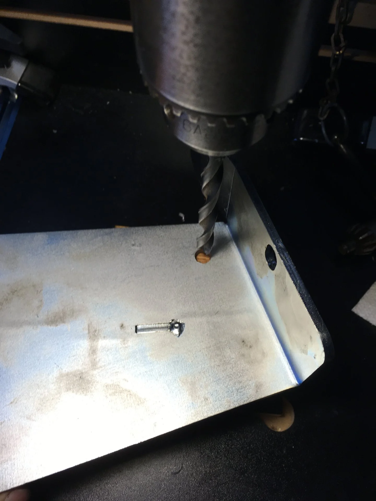

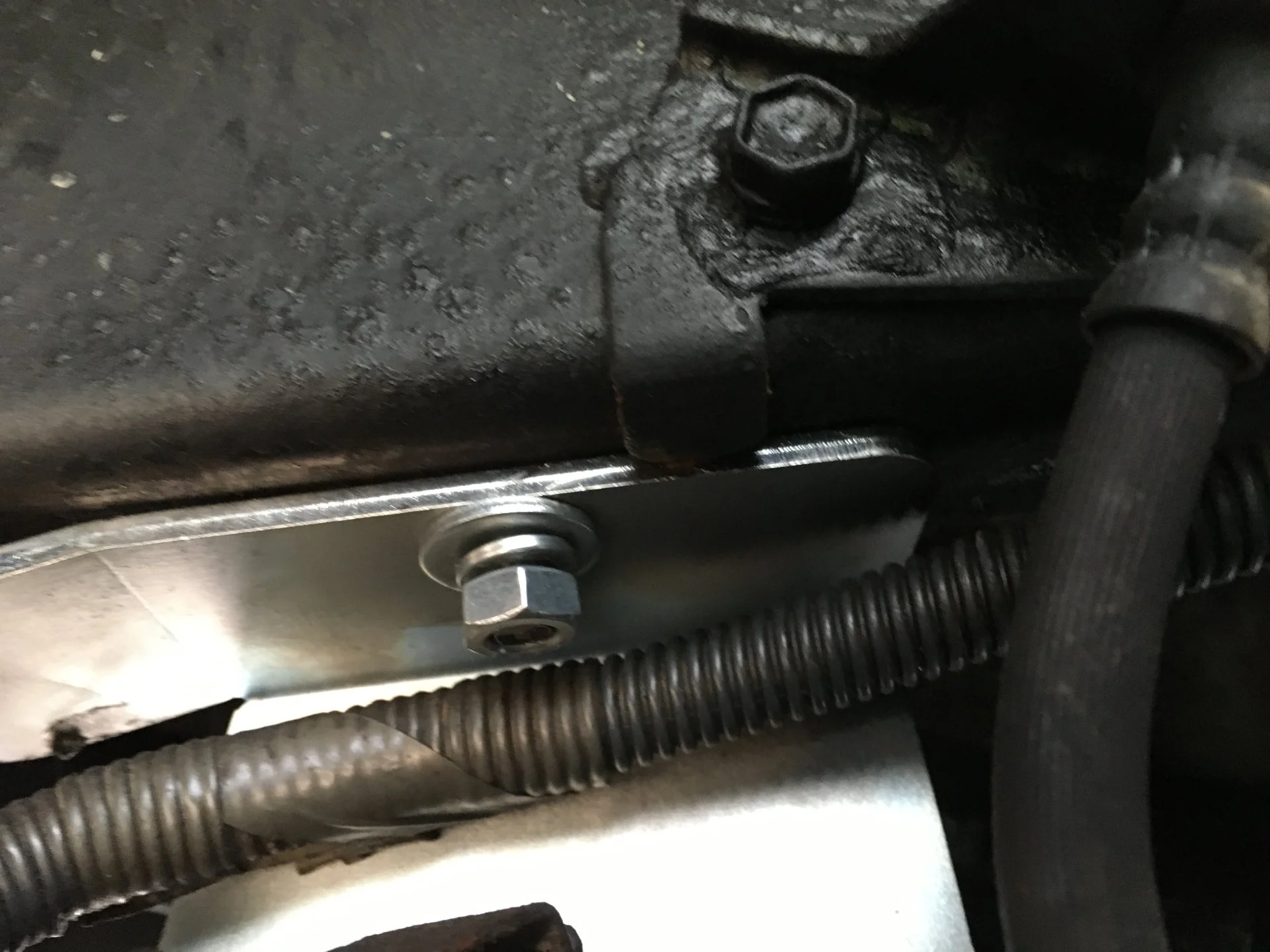

The middle Asifr piece for tranny cover bolted right on with nearly no effort. I did clear the threads of the nuts behind the frame with an m10 re-threader. The front one (for oil pan) took a bit effort, as one of the wire was anchored using one of the hole. I did not want the wire hanging, so I drill a same size in on Asfir’s mounting bracket and mount the cable tie into the new hole on asfir mounting bracket. It came out really nice.

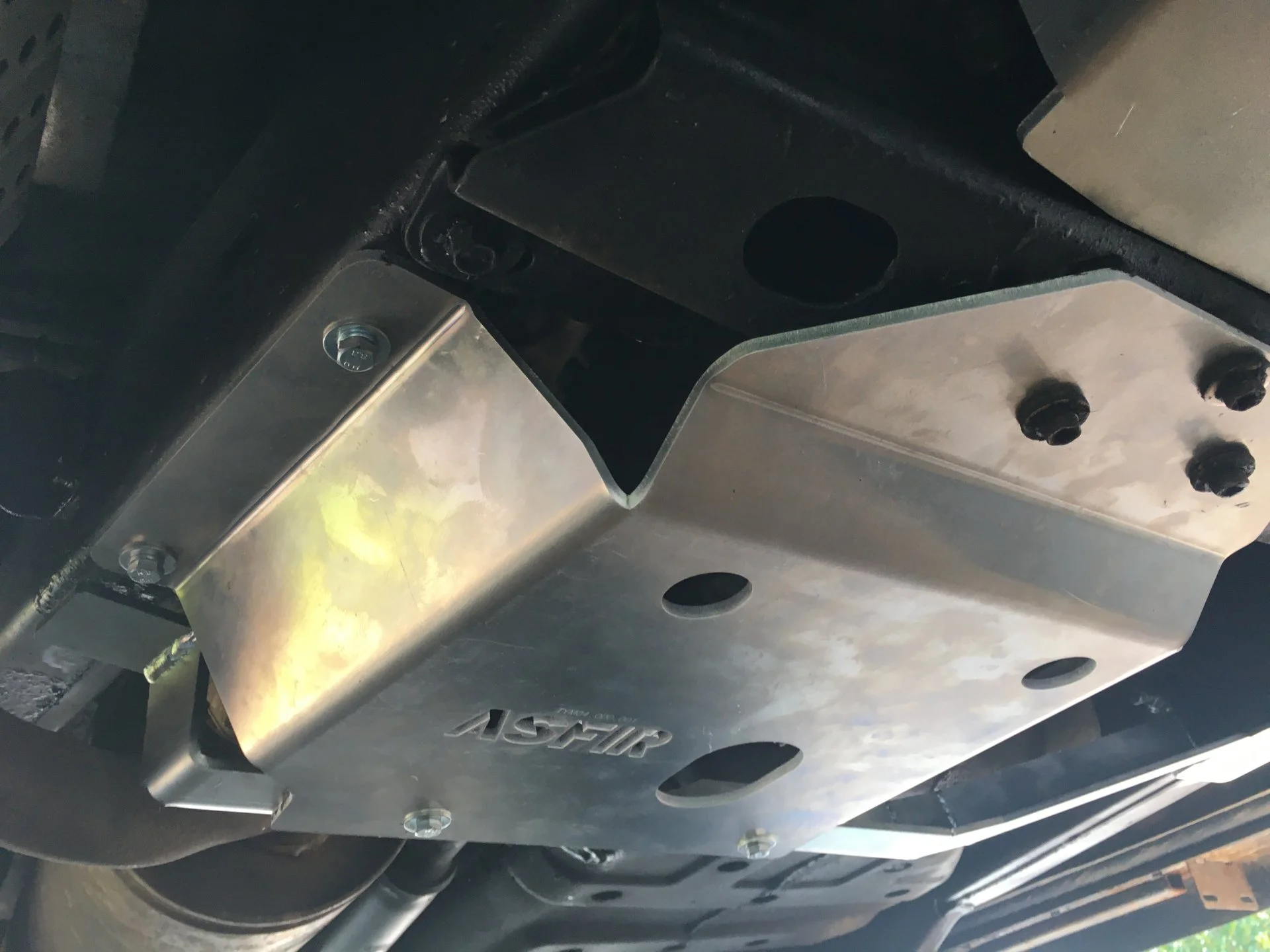

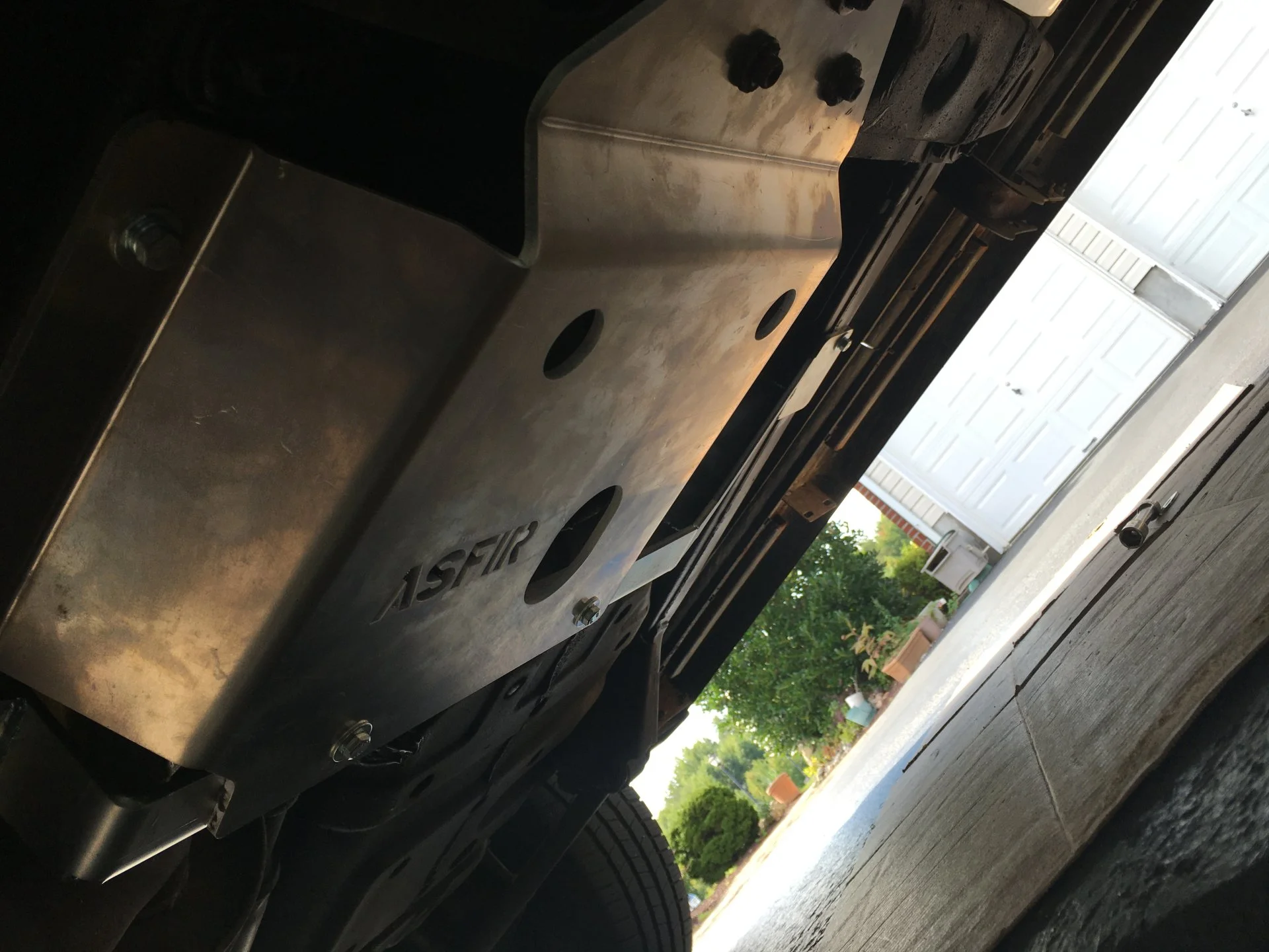

The installation of the asfir rear plate (for the transfer case) was nearly a nightmare, the frame bracket was a bit too wide, I had to bent it inward a bit to make it fit. Ok still not big deal, then for life of me that I could not figure out how the m12 bolts on top of the bracket could fit into the holes on the side of the frame. After more hours trying and fitting, i the end I concluded the bolts were not meant to fit inside the holes, and I don’t like to pinch them on the frame which may result long term rust, I just left them out. If there were some instruction, it could be a big help.
If it comes around again. I’d definitely get the middle plate and possibly the front one as well. If your truck comes with the stock transfer skid plate like mine does, I would probably just leave the stock plate and skip the rear Asfir plate to avoid the all the fuss and expense.
