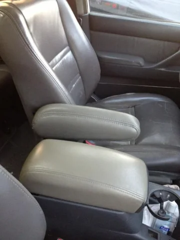

New cruiser = new armrest mod. This one came out even better. It's even more sturdy and did not require me to destroy the leather like the last one.
If you have power seats, it's a lot easier to do this mod.

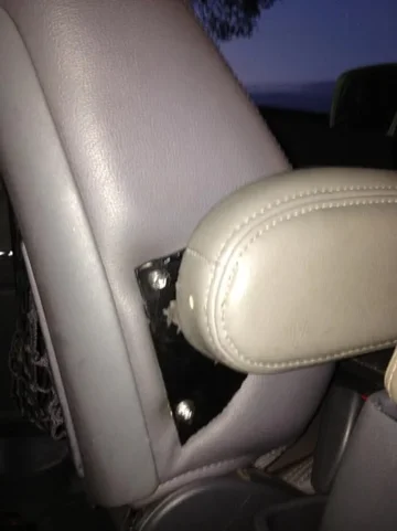

First you have to cut into the leather to expose these two bolts on the back rest and remove them. You will be replacing them with longer bolts. 1.25 in length should do.

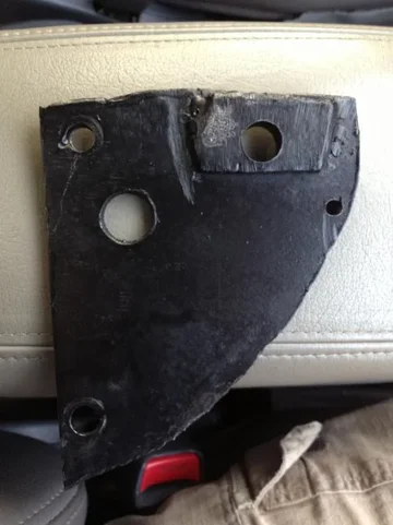

Now you have to fabricate a bracket that will hold the armrest and bolt to the seatback using the new longer bolts.

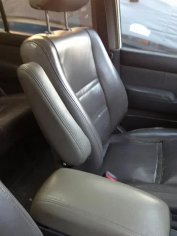

Now attach your armrest to the bracket and bolt the bracket with armrest onto the seatback.
Now you're ready to ride in comfort!
