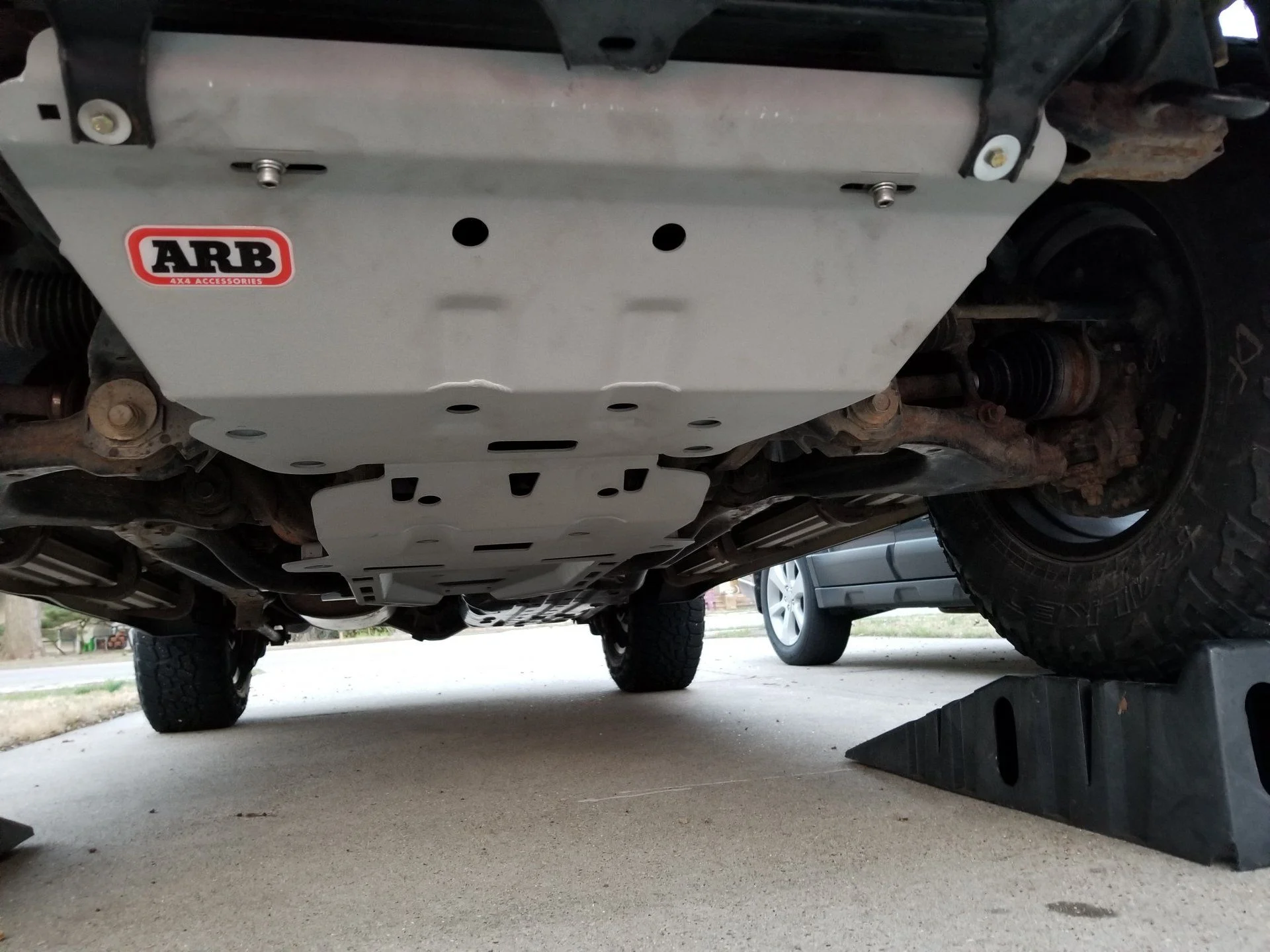

Ordered a set from Amazon (free shipping) on Monday and put them on tonight. Wrenching is always a good Friday afternoon stress relief.
Overall, they are much thicker, stiffer, and beefier than stock. Protection for the transmission and transfer case are greatly improved. Fitment and instructions were so-so, and the powdercoating was chipped in a few places. I was able to get the front, middle, and rear skidplates in without any adjustments, but had to partially install the small transfer case skid and then hit it a few times with a 5-lb BFH to get all of the bolts in. Luckily, these allow for oil changes without dropping the front plate (not the case with the factory front plate), so I won't be taking them off very often. I also had to trim the front plastic splash guard.
See the picture below. Ignore the rusty underbelly, that's the next project after rock sliders and headers.

One thing I forgot to mention is that the two forward-most bolts (front plate into the radiator core support) were M6 in my GX, but the bolts provided by ARB were M8. They are relatively long bolts (70 mm). I ended up drilling out the factory core support and tapping it to a M8x1.25. Alternatively, you could find some M6x70 mm bolts and retain the stock threading. Those bolts were broken in my GX when I bought it, and I subsequently broke another one tightening it with a 1/4" impact driver, so they were too small and had already been drilled out and re-tapped twice, so it was time to upgrade to larger M8 bolts that hopefully won't break off.

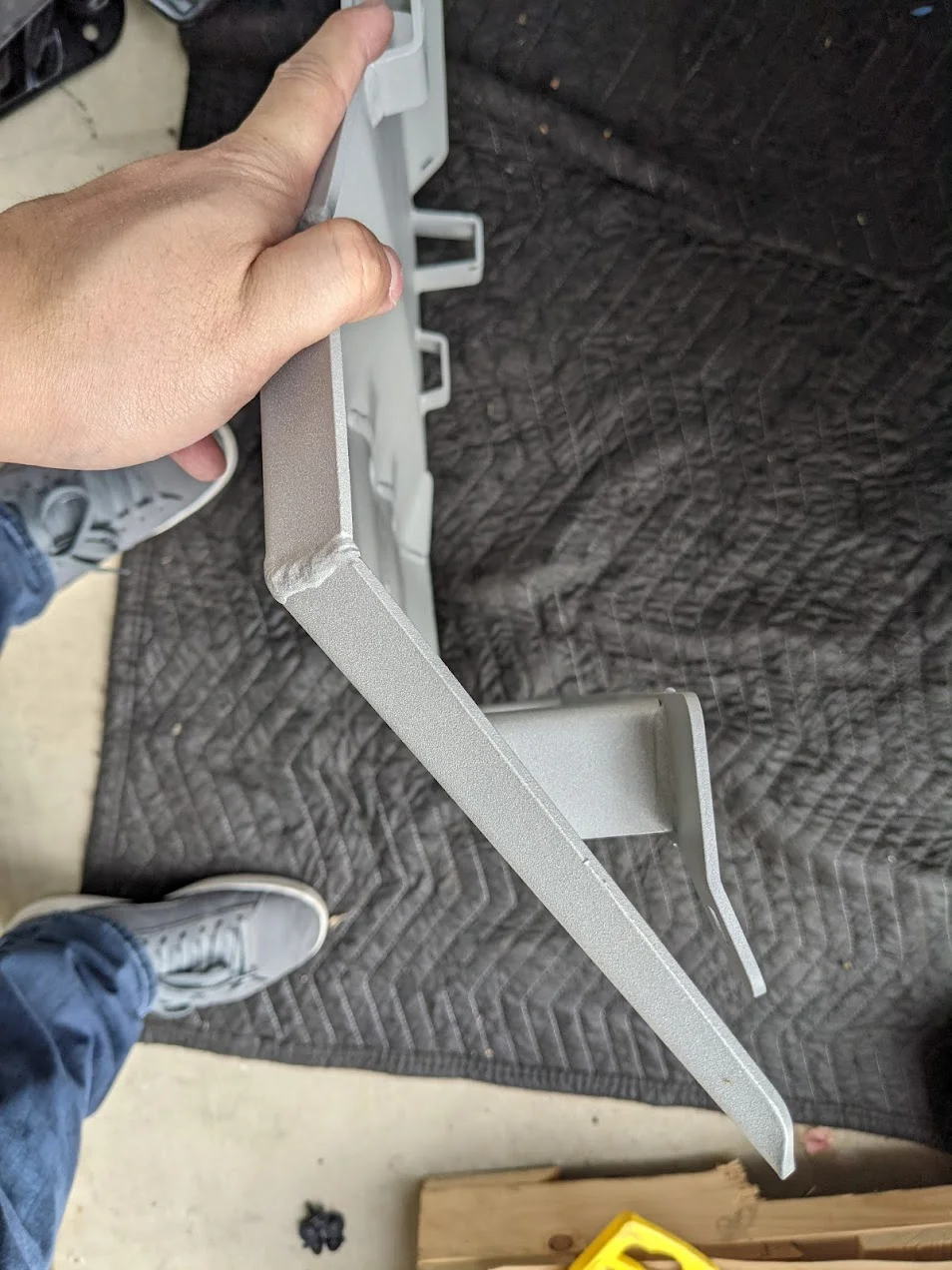

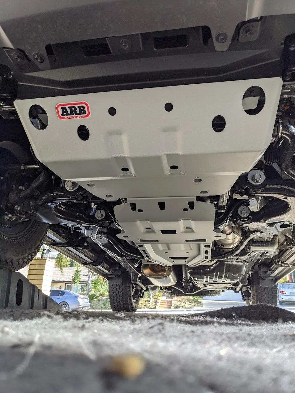

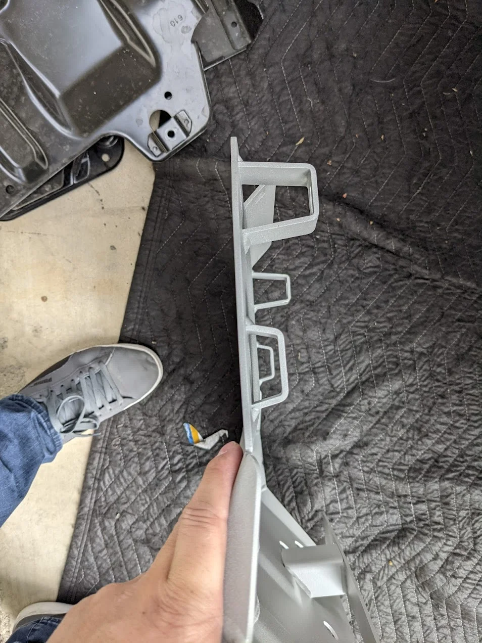

This is on a 460, but I think the skid sets are the same between all the 120s/150s with KDSS. Wanted to show the thickness compared to stock. While they're definitely not as robust as a BudBuilt skid or an RCI skid, they're definitely thicker than stock and offer a bit more coverage down the length of the vehicle.
I had similar experiences as the others noted. Not all the bolts fit in the holes without reaming/adjustment (two, one on the front skid and one on the transfer case skid), and the paint? (I think it's paint) was scraped away in several spots due to shipping. The box wasn't great. That being said, I paid $630.49 shipped to Nevada, which to me is good value especially given I don't plan on bouncing the thing off rocks. I'll replace these when I do.

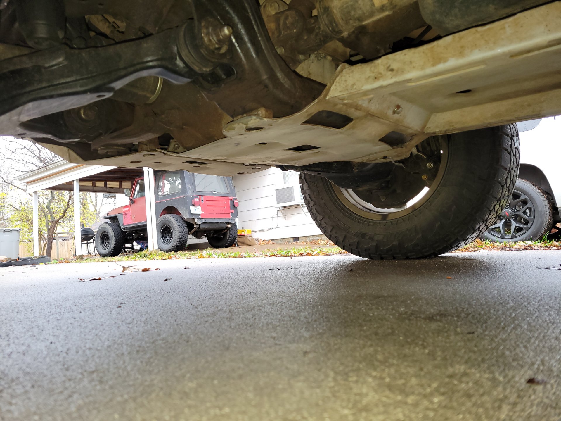

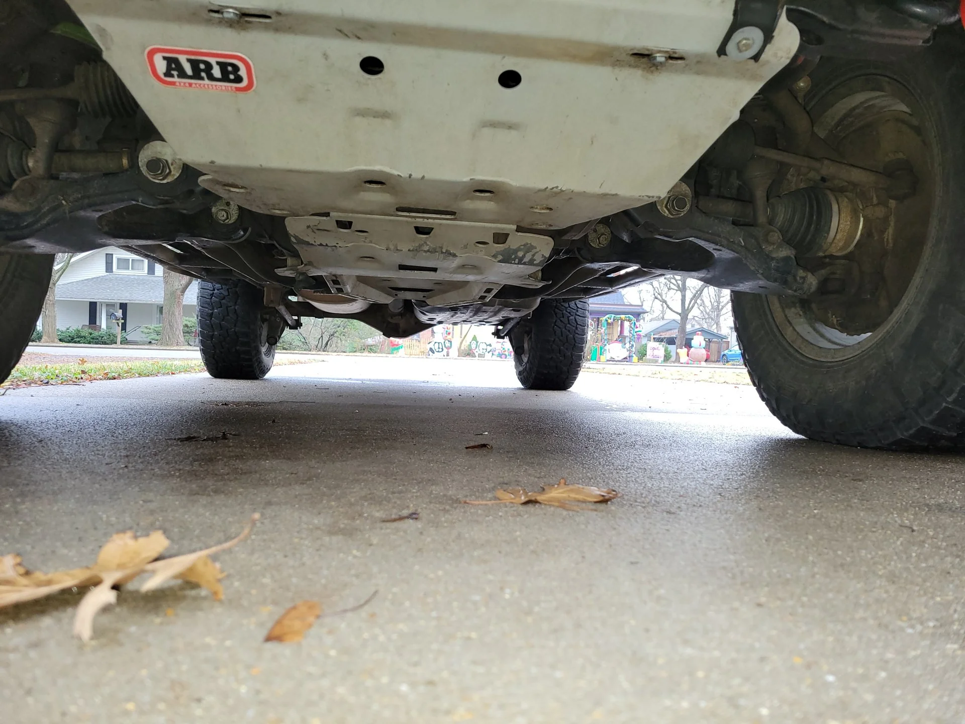

Here are some pics after mine. Prior to getting the lift, I hit these HARD on some rocks, both locally and out in CO/UT. They definitely got bent up but did a great job of protecting the underside of the GX. They also let the GX slide over stuff really well. I've only hit them a couple of times since lifting, and it's been sliding over steep soil slopes, rather than banging down on a rock. I really don't care that they are bent as they still function just fine. I would get them again. They were only ~$450 shipped when I bought them.
