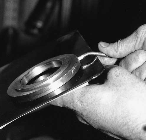

So my ARB locker has been leaking for some time now. It leaks through the air hose meaning the oil travels through the hose and spits out through the solenoid when the locker is disengaged. The locker functions flawlessly and my compressor "does not" cycle frequently. So that (to me) means it is not an "O ring" issue rather might be due to a bad "air collar/seal housing"? So, has any one has similar issue and did replacing the air collar/seal housing fix it? I read about adding additional breather but it does not make sense to me. How adding additional breather would fix a bad air collar/seal housing, if indeed that part is bad.
Here's a link and picture of that part
P71824 Image Large Photo
Thoughts? :cheers:
