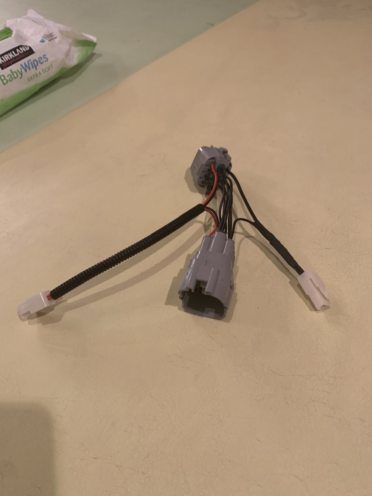

I dislike taps as well. When I installed a set of aux driving lights on my Tacoma, I created a short jumper harness with a male/female H4 connectors. The jumper harness had both hi/lo leads running out of it to the three way switch on my dash. The 200 headlamp connectors seem to be less standard (when compared to an H4) and harder to source.
I modified this
the piggy tail is setup for high beam. Terminal 3.
LO beam is terminal 1.
I created a similar pigtail but this one with no ground. And plan to run it back to LINX.
for rev….not sure.
I bought 2 piggy tails from STEDI.
One as a backup and and I case I was going to install some lights to the other headlight. But most likely I’ll run it through the LINX.
I might sell it.
The one on the left is the STEDI pigtail that includes a ground
the one on the right is mine just pulling off pin 1 and it’s a single connector.
FYI taking the factory plug out of the headlight is a monumental undertaking. I think I struggled with it for over and hour. So tight to get a grip and push and pull at the same time. Omg.
I zip tied the pigtail to the factory bracket cuz I didn’t want it dangling and swaying around.
If you go this route you might want to make the accessory connectors longer. Maybe double the length. If you do the connectors will be sitting in the engine bay so easy access. If not you have to take the fender liner out to get access….but I figure I should ever have to unplug those wires.

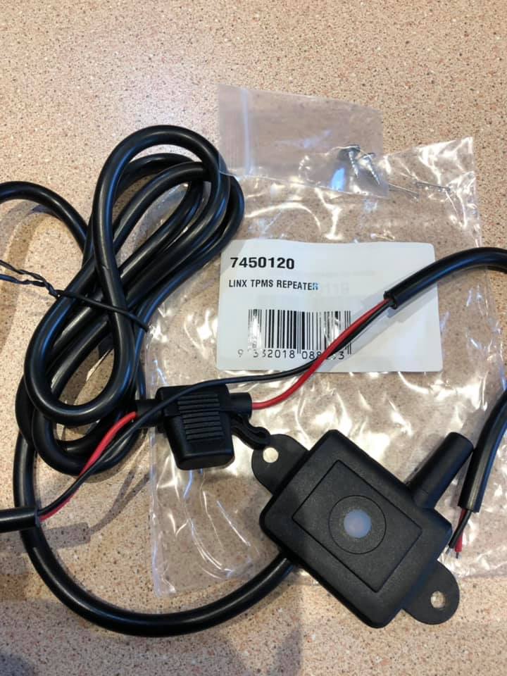

Is that the same part as this TPMS repeater?
I am not sure the repeater is what you need. I believe this is for situations where you have a very long trailer and the rear wheels are many feet from your TPMS comm module and it lets you extend the signal.

I’f you have a long trailer many guys are adding the repeater to help the signal from the far tires reach the comms sensor.
