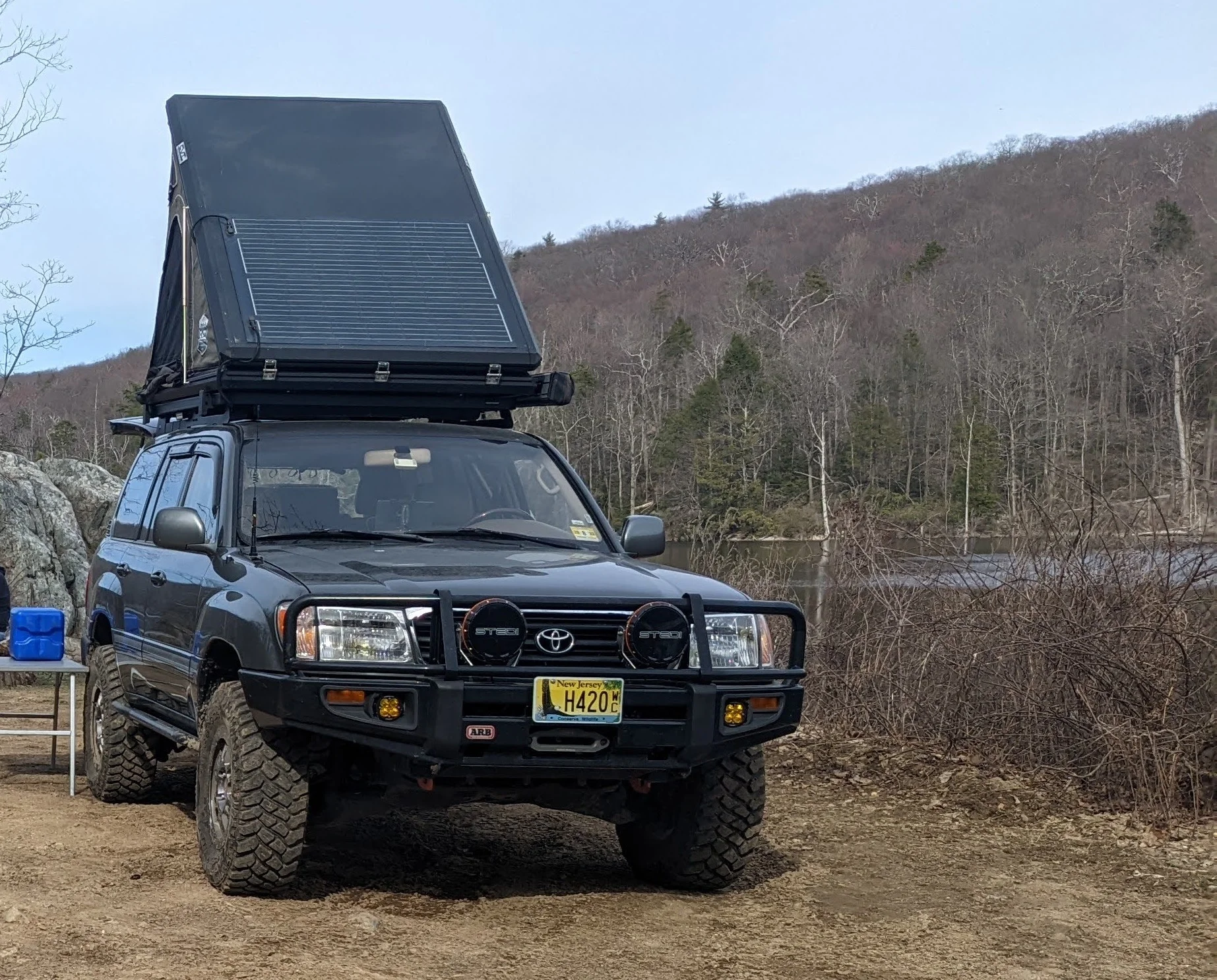

I tried these after making a top mount bracket. They are completely crap though and have zero sealing. There are amber versions on ebay.
Also got in a pair of triple LED that I think are 30W from ebay. Quality is promising but they are larger and require more clearancing before they'd fit. They also are more of a flush mount so to adjust them would require a new way of mounting as well.
I've had the same issue with the marker/turn signals and found that the 84-89 Toyota pickup turn signals are almost the exact same size. I've had them in my truck for a few years now and with the exception of 1 burned out bulb, they have been flawless. When I changed the bulb, everything was still clean on the inside. They are a mm or 2 longer than the arb ones, but the screw holes line up and tighten down fine, only difference is they are not dual filament bulbs, so you have to choose if you want them as marker lights or turn signals. I chose marker lights.
