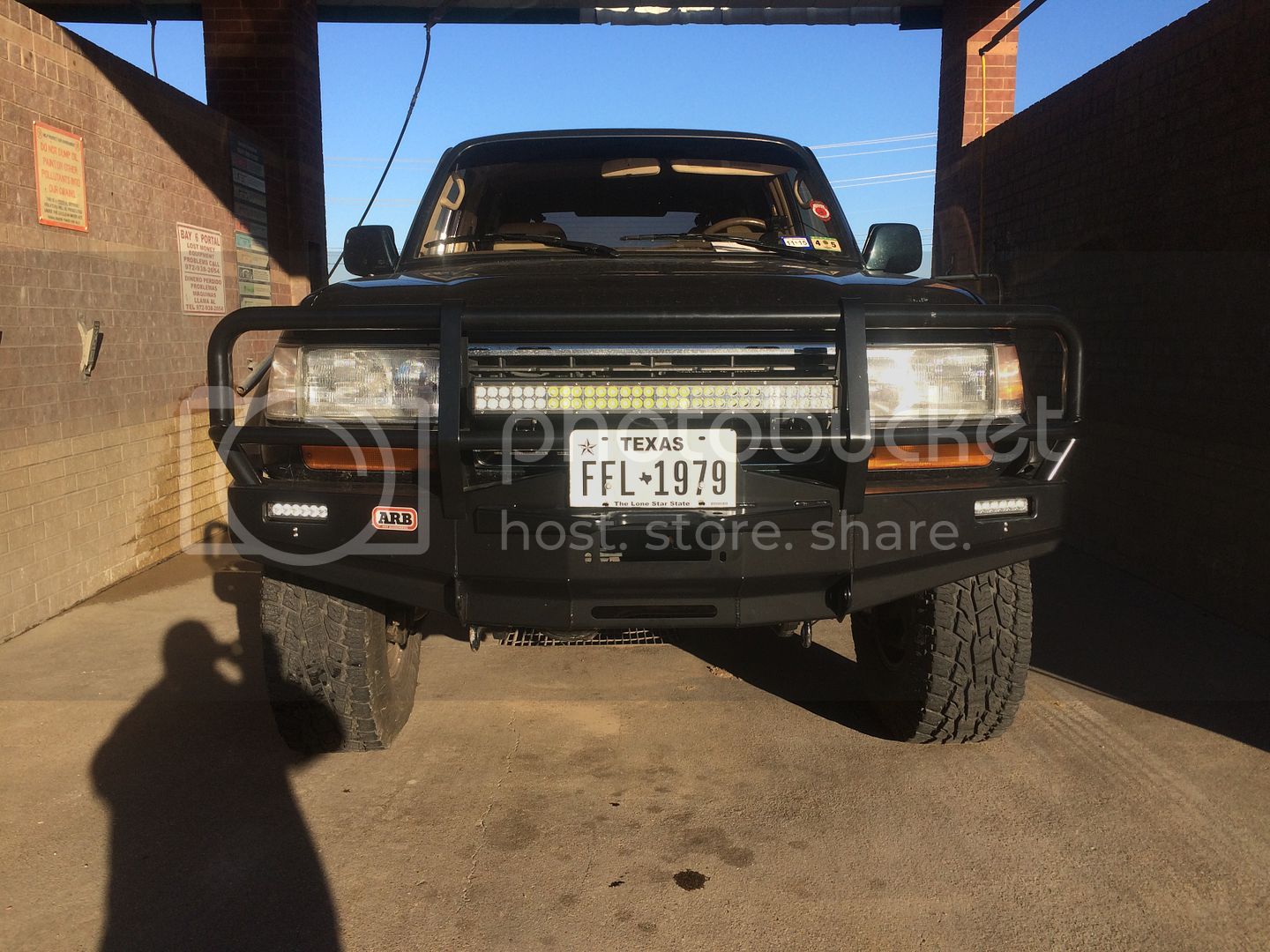

6" LED's where the running lights were supposed to go and 28" LED light bar in center.
I like your set up a lot. I was thinking of mounting the 28" light bar upside down on the top part of the ARB bar. I think it will not impede the air flow to the radiator so much. I did not get one yet, so I don't know if my theory is right or wrong.
Regarding the 6" lights inside the bumper, there's no other way of installing them without drilling the bumper?
I was going to mount it like you're thinking but for now I'm happy with it like this. I couldn't figure out another way to mount the 6" LEDs without drilling. I was hesitant as the bumper was brand new but saw no point in having the running lights that are supposed to go there. These light up the sides of the road very nicely and were only $36 for the pair delivered.
Yes but it was simple. Took a flat piece of 2" wide by about 4" long piece of flat 1/8" steel, bent it in an L shape, drilled some holes.
Thanks. I think I got some L-shaped brackets somewhere around here. I'll see if they fit.
I assume you had to cut the tabs too. Is there a need for a relay for the 6" and 28" bars?
Probably not a 'need' but a safe bet to say the least.
