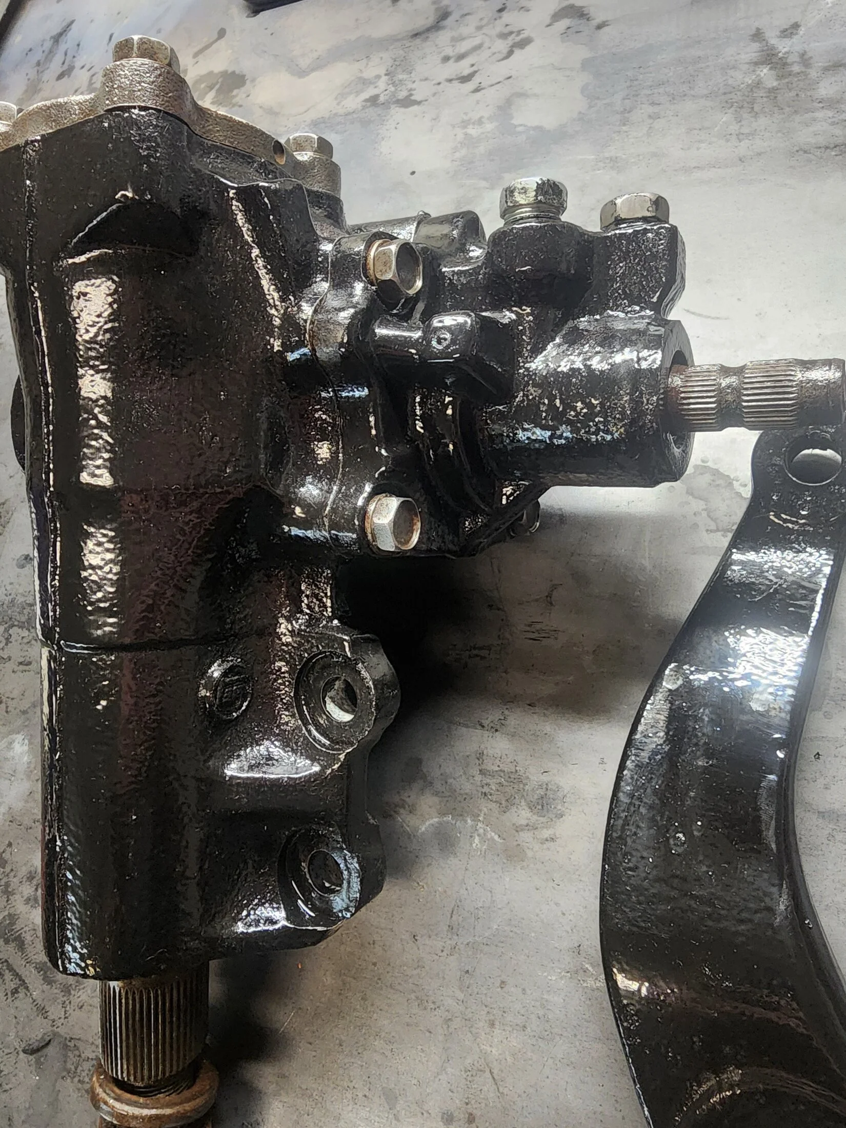

My steering box has developed a leak which I am struggling to pinpoint. All the hoses are new with no signs of leaking. Same goes with the input and output shafts which are dry also. PS fluid appears to be coming from under the box which really only leaves the area where the 2 sections of the box join.

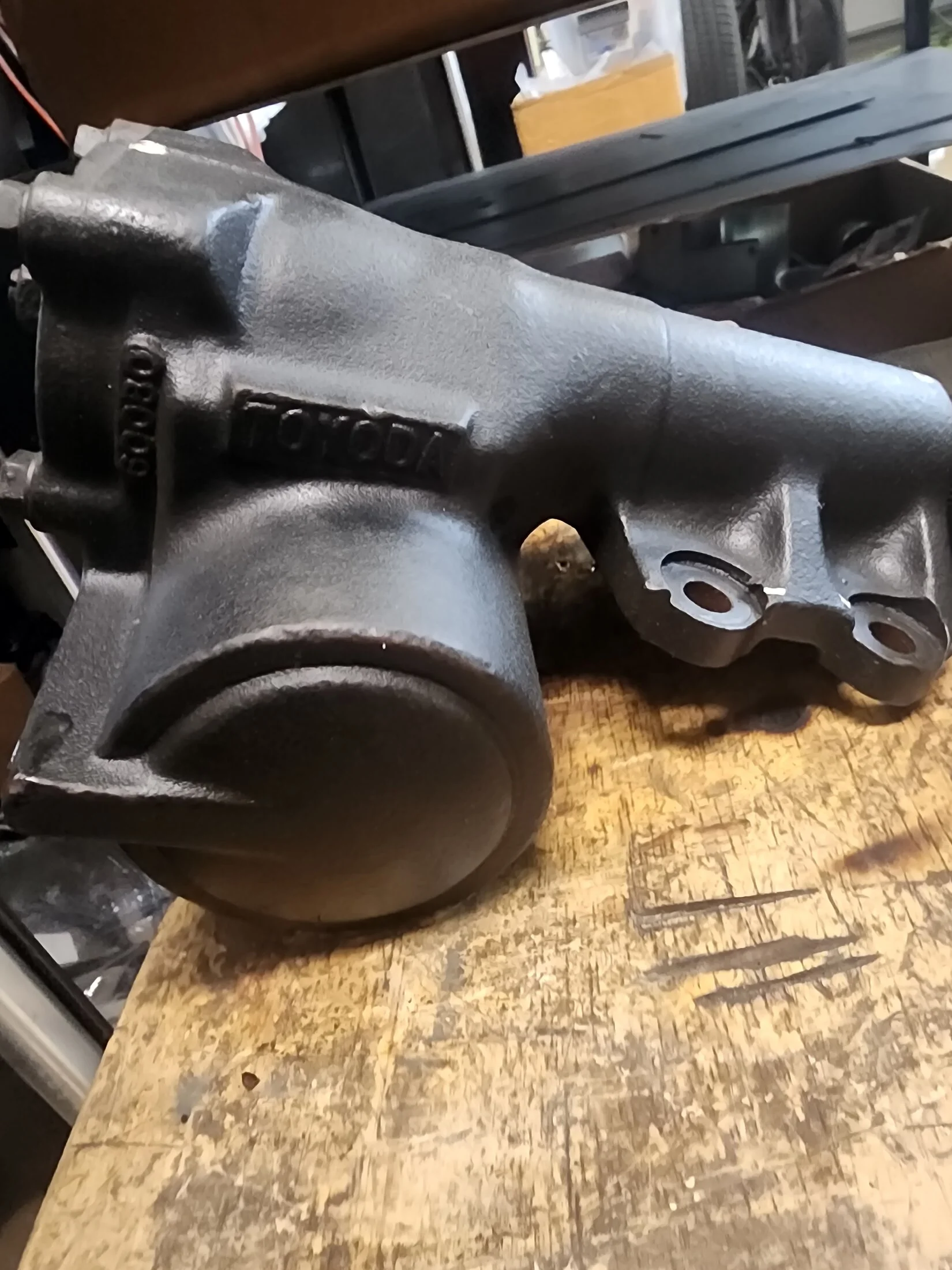

I happen to have a spare box that was gifted to me a number of years ago. I have no idea on the providence of this box other than someone has marked it with "Reman" - see photos.

Like @andersonoverland suggested, do it yourself. There are countless threads here and videos on YouTube. Might as well drill and tap it now if there's any possibility of running ram assist down the road. Pull the one apart that you have laying there first, so your truck isn't down for any amount of time. If it looks good, swap it in and then rebuild the one that you pull out so you have it on the shelf, drilled/tapped and freshly rebuilt for a later date.... Looks pretty clean/Rust-Oleum restoration already. Does it say "Renman", not "reman", like someones name maybe?
Thank s for the feedback. I always thought the rebuild of the steering box was a 5 :banana: job and required a Phd in mechanical engineering. Also you are right with the Renman thing, I read it and saw"reman" :hmm:
