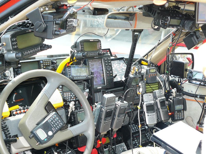

No offense, but having another screen to deal with reminds me of this...
Heh. Nah. ;) Reality isn’t nearly so crazy...
The “visual mess” I mentioned was a reference to a problem I have with triple vision...not the dashboard view.
