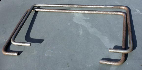

It's just some scrap 3/8" steel plate and 4 legs welded on. A mate has a similar setup but 4 welded nuts to screw 4 long bolts in as feet - the problem with that is losing the bolts...
I'm actually looking at a new design (after 20+ years) so that the legs fold flat using 2 long 3/8" rods bent to form folding legs. I'll weld 4 3/8" ID tubes to the bottom of the plate to catch the rod ends and cut to form limit stops (maybe at 120 deg). Not rocket science :)
