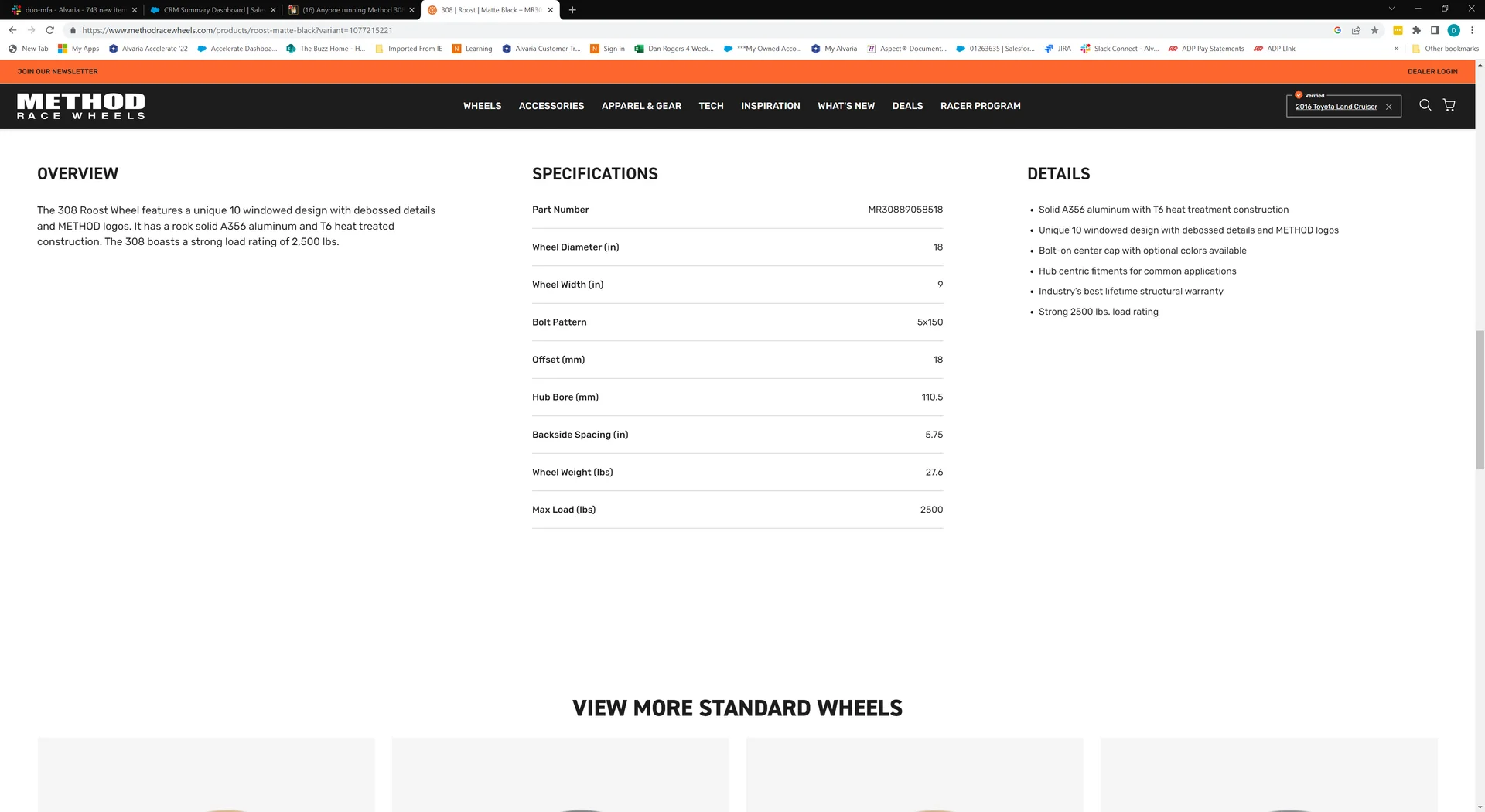

These used to be called Method Roost before they went to the numeric naming system. Seen a few 200s with them. 18mm is a pretty aggressive offset and will require some fitment remediation depending on tire & size.

I would consider 0mm to be the limit. That setup would be -7mm. You don’t need the spacers.

18mm will be flush. Dont stack a spacer on anything other than OEM offset.
