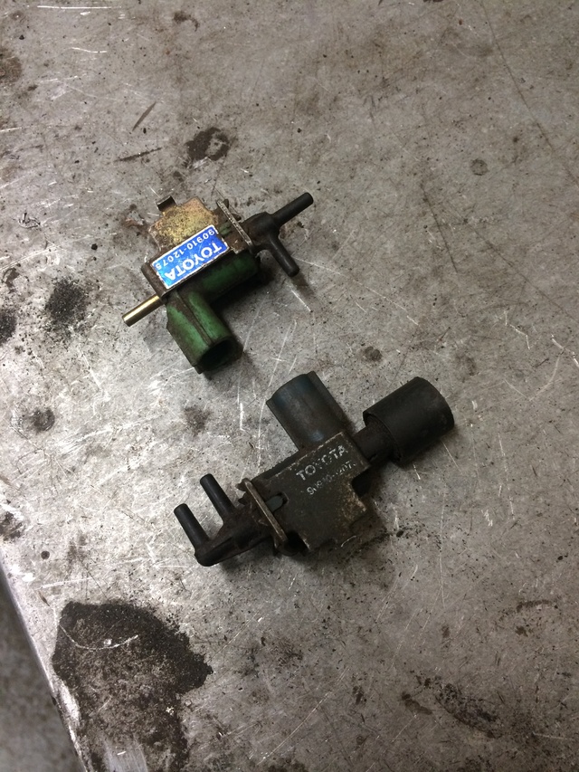

These are the 2 I have.
Thanks for digging those up Graham! Top one looks nearly identical. Trade for beer? :hmm::beer:
