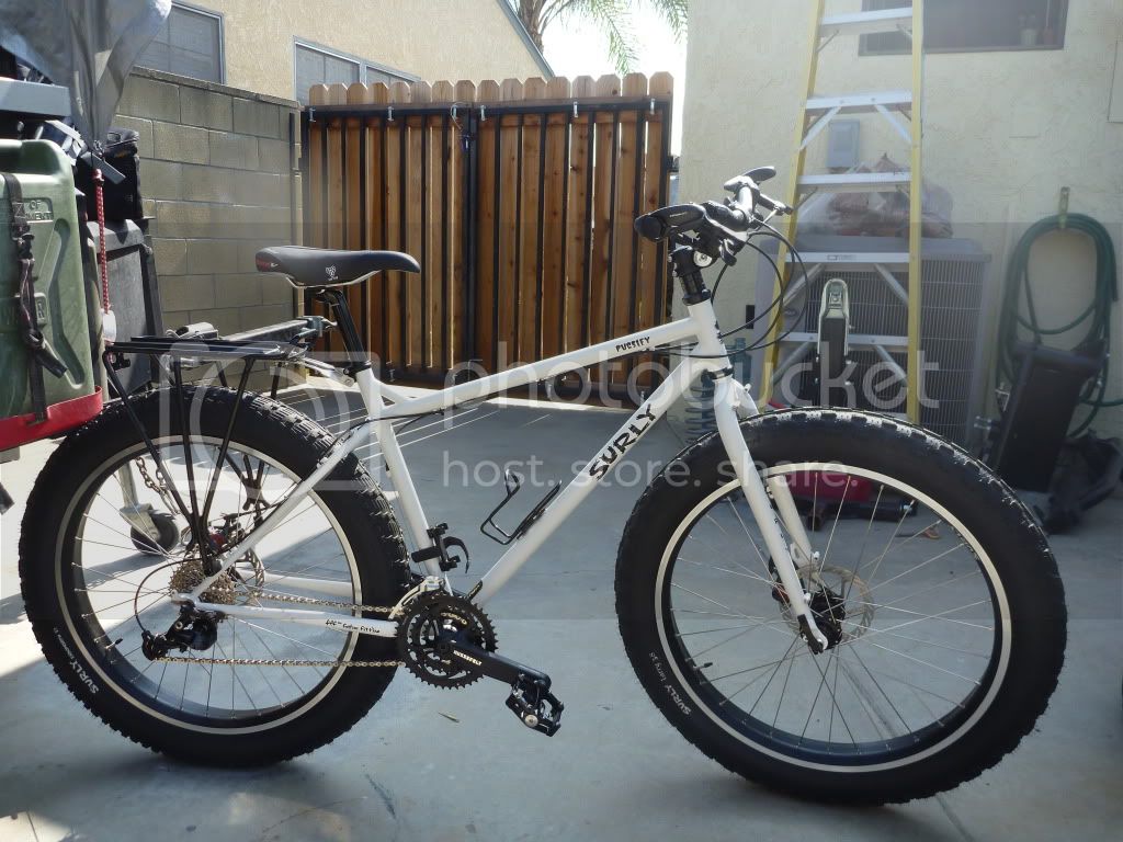

awesome bike. how much extra work is that thing compared to a regular xc bike?
I'm guessing you mean to ride, not to build? Design was tougher, build was the same. Riding is an "it depends" answer. On smooth pavement it is ridiculously slow compared to an xc bike. Places where you'd need to get off and walk the XC bike, it is a bit easier (no walking required). Through tall, thatchy grass, soft sand, or through smooth mud, it is faster (no idea why, but the type of mud where you'd pick a 1.95 over a 2.25 to get down to the base and displace less width, the 4.3 floats over and is even better than the 1.95). On rough, loose gravel, they are about even. On smooth-ish trails, the xc bike is substantially faster. In babyheads or through serious exposed roots, it is substantially faster.

that was the question. i definitely want to try one.

mudbay: Surly Pugsley $1300
