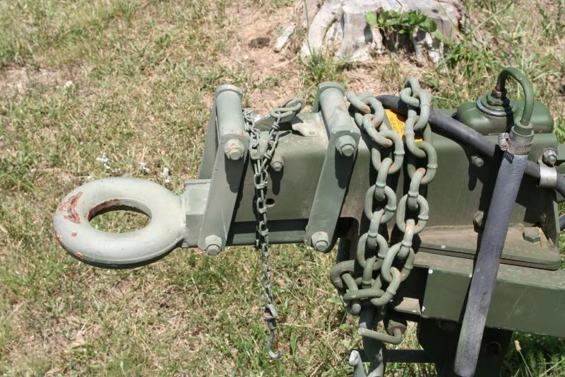

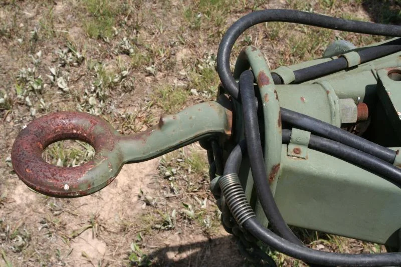

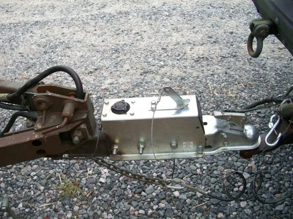

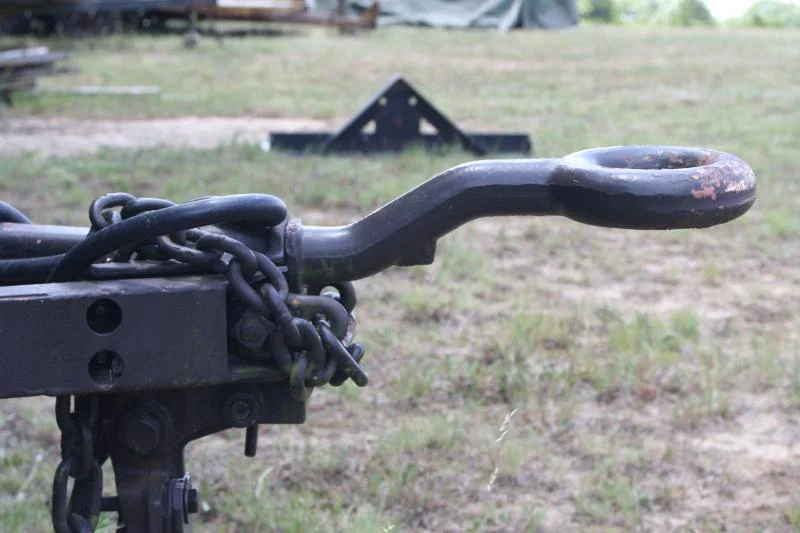

Okay, I've posted some different shots of the lunettes.
First one is a M101, from the 50's, it rotates 180 degrees. The length from the tip of threads to the stop is @ 6 1/8 inches.
Second one is a M101 A2, newer style, it does not rotate. It has a surge brake system.
Third one is the M105, also rotates and is huge compared to the 101.

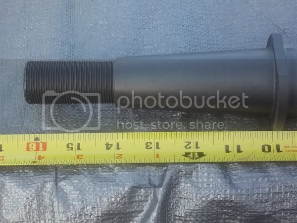

Thanks for posting that info. I have what i thought was a spare M101 offset lunette, but measuring it seems to indicate that it's am M105 lunette. :frown:
Shank length: 8.25"
Ring inside diameter: 3"
Thread length: 2-5/16"
Taper length: 5-7/8"
Thread diameter: 1-1/8"
Ring outside diameter: 6.25"
