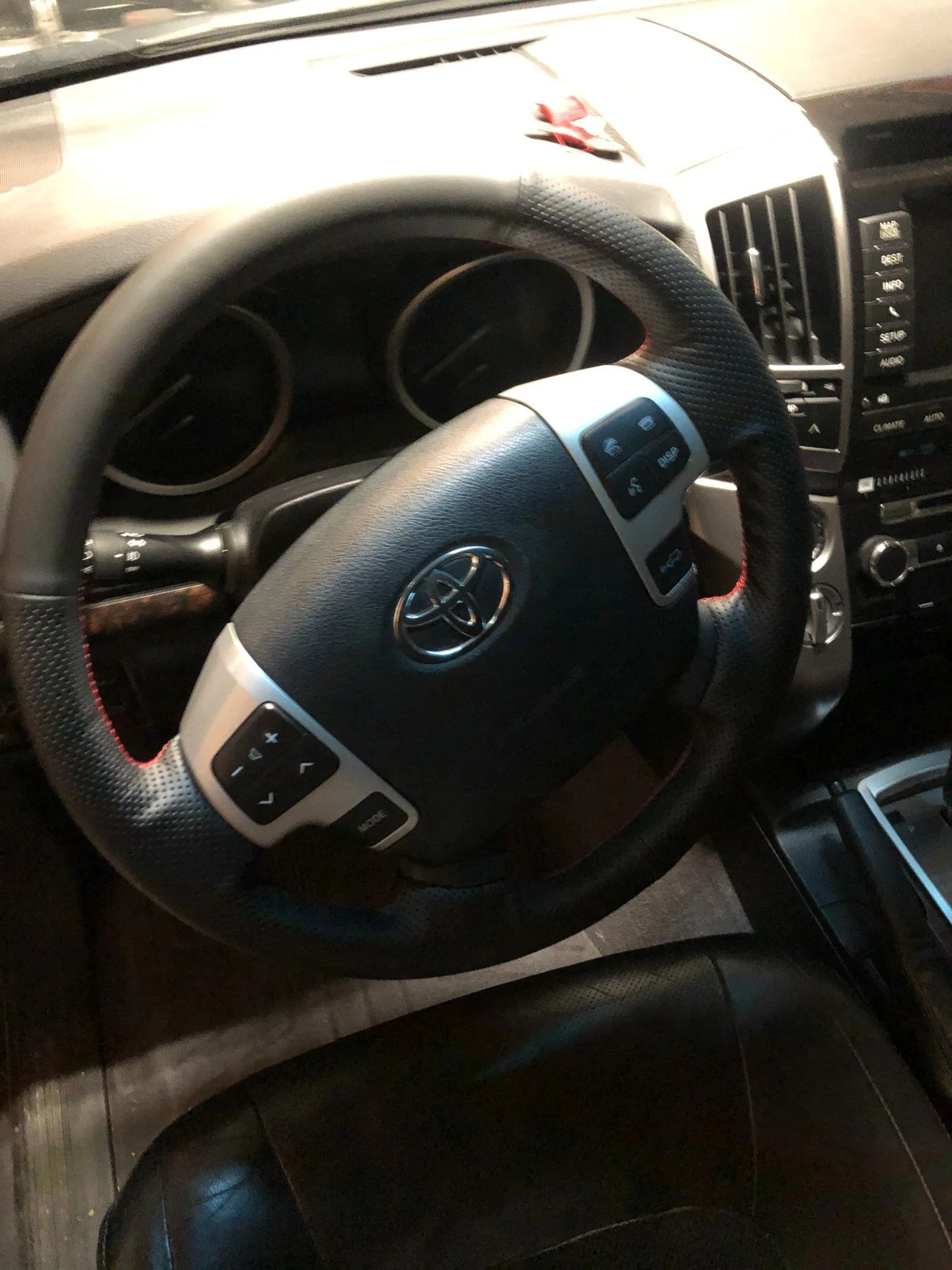

I did mine and I *REALLY* like it. Sooo much better than that phony plastic wood.
Take your time, it will take about 1.5-2 hours. There will be plenty of string for sewing. Maybe wear some thin gloves to keep the string from cutting your hands as you tug on it. Pay close attention to getting it perfectly centered on the wheel, use the double-stick tape. Once you start sewing, it can't be moved.
I didn't take the switch panels and air bag off, but I wish I had. They do give you a plastic tool for tucking the leather, but having them off would make it much easier. Make sure you disconnect the neg terminal from the battery before you mess with the air bag, wait a few minutes. I think @Taco2Cruiser posted in one of the threads how to get the airbag off.

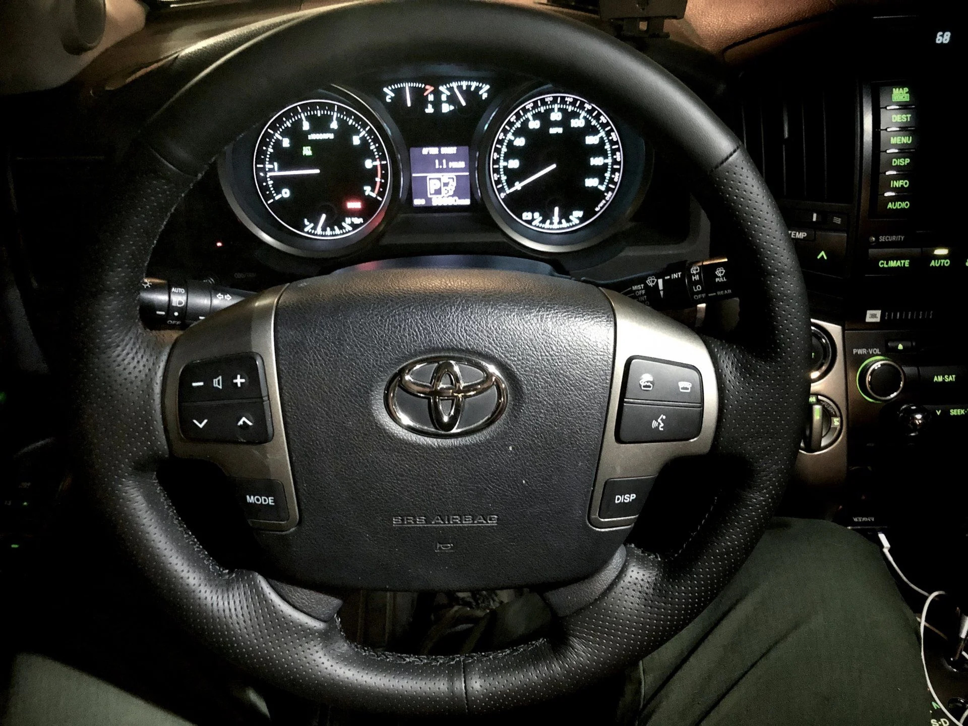

Took me a good 3 hours doing mine.
Maybe I’m just slow...but I was being crazy-careful on the stitching to make sure it was tight, even and following g spoke countours. Also slower because I did it with the wheel center fully intact.
**Before you apply the adhesive strips, make sure to pull it fairly tight all the way around the wheel to be sure it’s evenly spaced—specifically matching up the edges of each “spoke” on the wheel.
**The adhesive is not what attaches the leather, of course. It’s there only to help avoid any rotational slip/movement when the weight of your arm hanging off the the wheel.
One NOTE post-install...
The FEEL of the leather is perfect...but when new, it might seem a bit slippery. This
improves big time with use though. It’s just like high quality leather baseballs or American footballs. Players or officials spend time rubbing the leather with their hands until the surface becomes more supple/grippy.
LOVE this mod & I forget how much I hated the original plastic wood top...

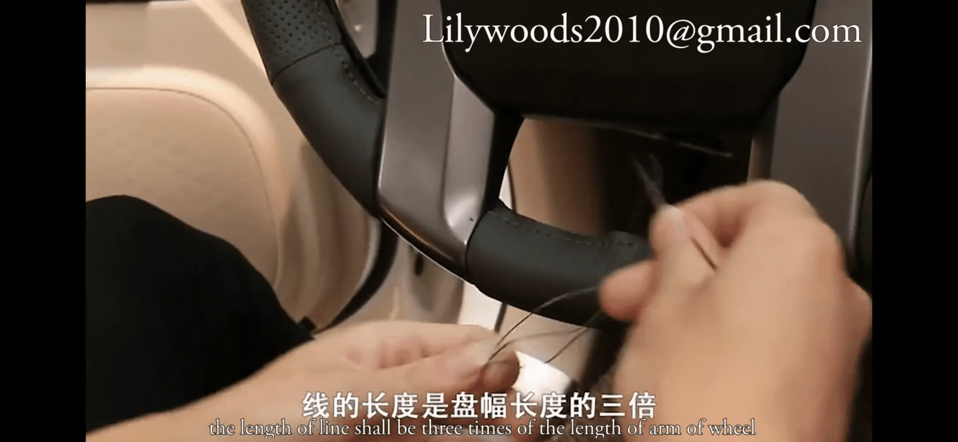

I am ready to go for it, but I have two questions, first:
1) how long does the string need to be? If I need to stitch 10", do I need 10", 15", 20" or more? Edit: 3x the length.

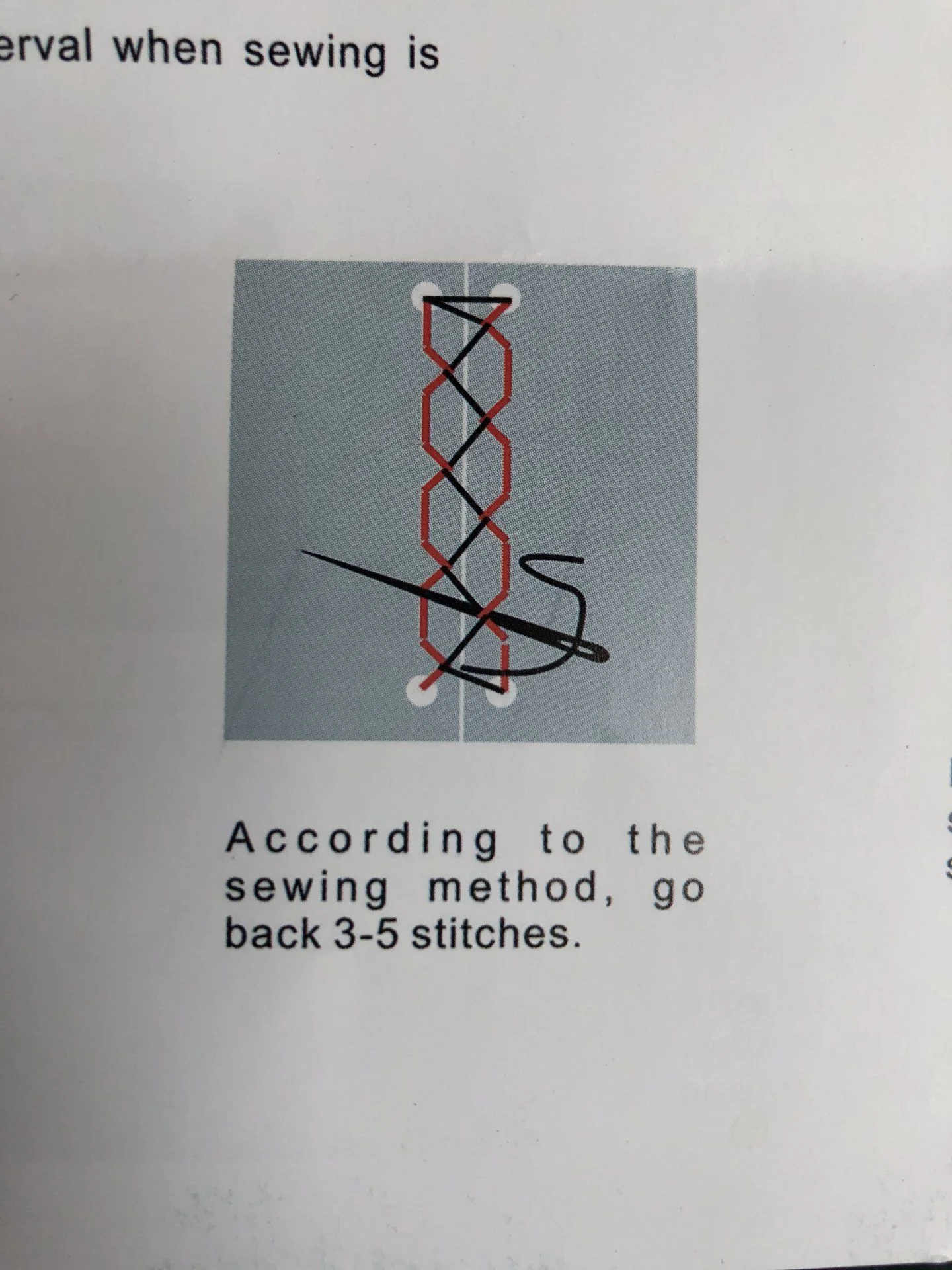

2) can someone help me understand this instruction for finishing each segment?
