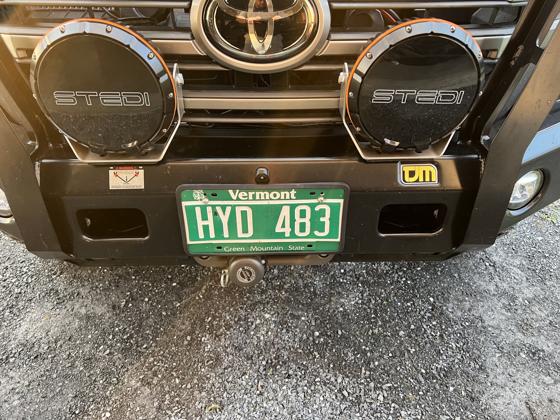

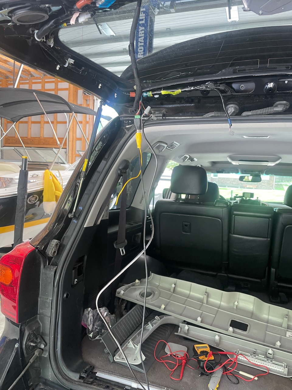

So I pruned the wiring harness back and it is working. I drilled a hole in the bumper and put the camera there, so it isn't blocked by stuff.
After removing the RCA plug and about 25' of camera wire, the yellow wire was the video signal and the shield around it was the video ground. Red must be the trigger wire (unused in my application).
The wires could be shorter, but are serviceable like this.
It has a wide angle view that I think will come in handy on the trails.

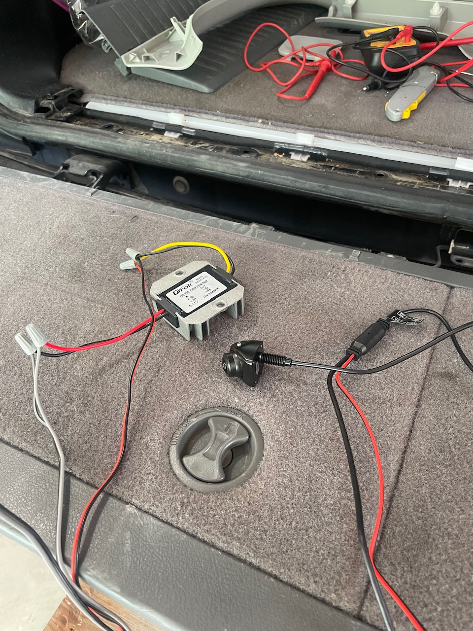

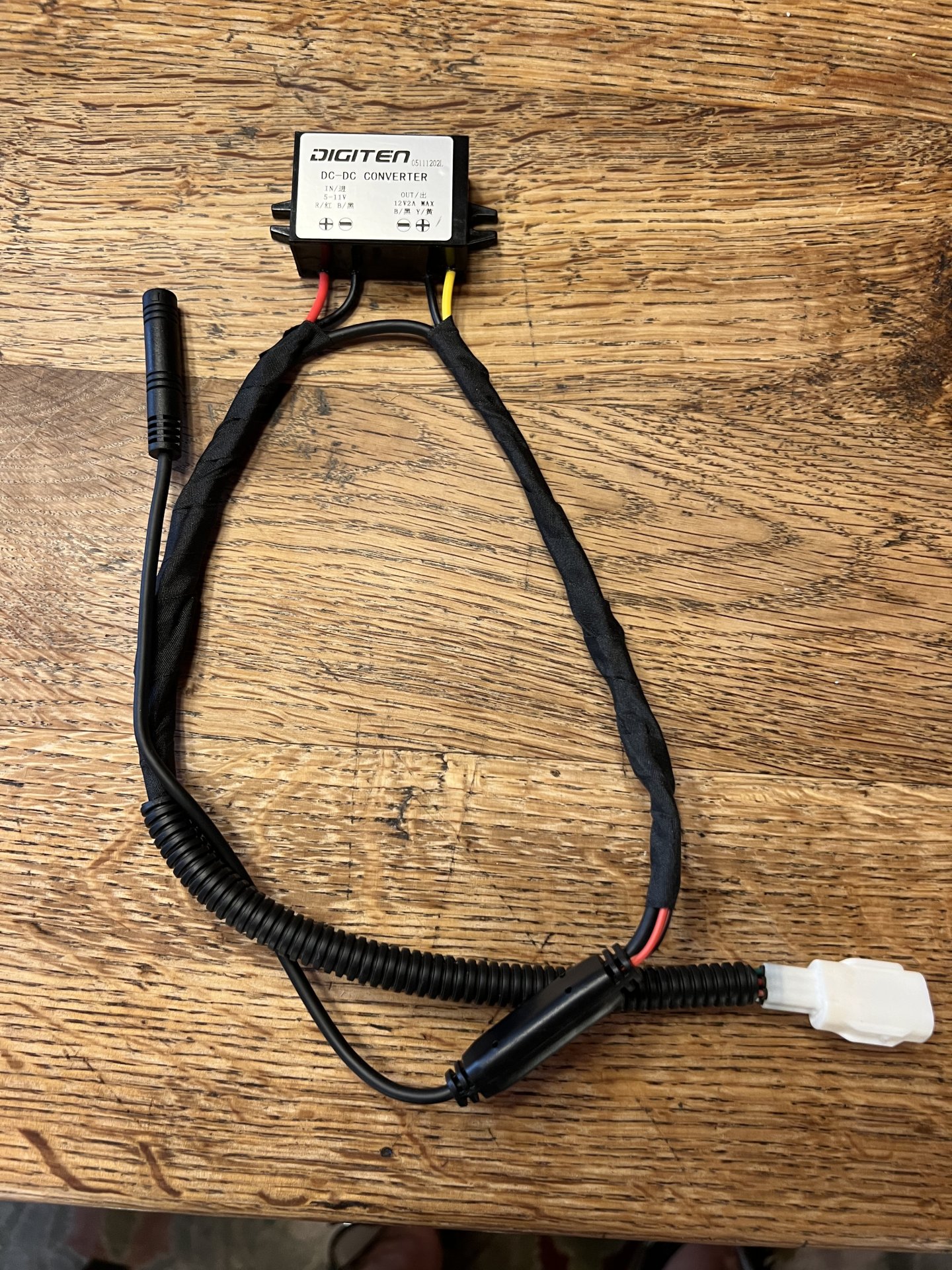

As I now have to redo my camera relocations on the new 200, I’ve decided to do the camera upgrade at the same time. I’m in the process of collecting parts. The step up TX linked above in this thread was out of stock so I bought this one:
Edit: just realized that what they sent is a step down TX but what I need is to step the 6V line in to 12v. Back to Amazon, try again.
We’ll see if it works. The instructions talk about the necessity of a fuse on the input wire and I’m assuming they mean don’t just connect the TX directly to a battery. As the camera 6v wire is already on a fused circuit, I don’t believe I need an additional fuse. Do you electrical gurus out there agree?

It works. I temporarily did this on my 2013 rear camera. Because the screen was my limiting factor I decided to just revert to the factory camera. But it did work. My only caveat is that I found I needed to attach the shield in the shielded Cat5 cable I used to the ground wire, otherwise the video would scroll. But if you are using factory wiring with a different camera it’ll likely be fine
Edit: this is the one I used:

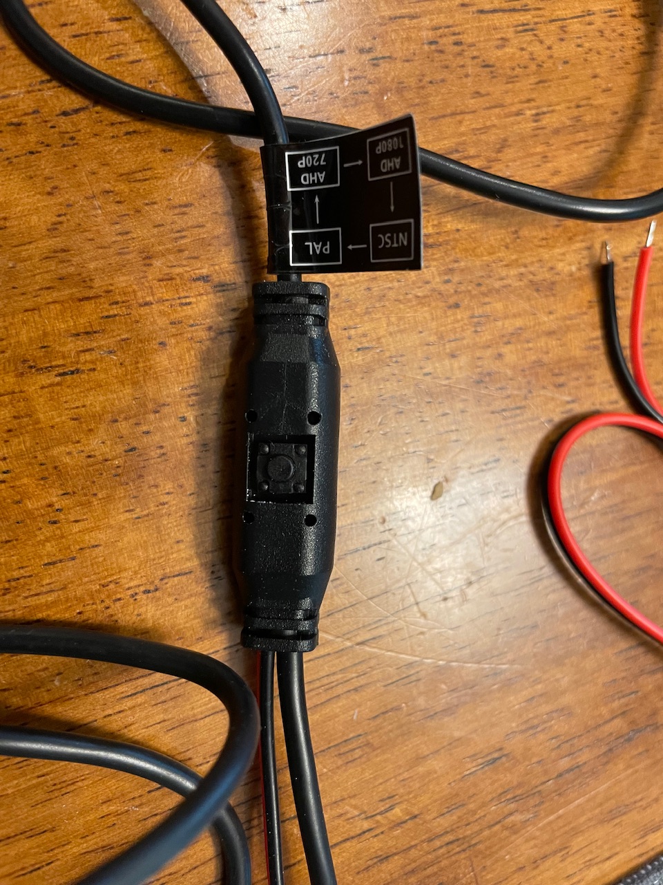

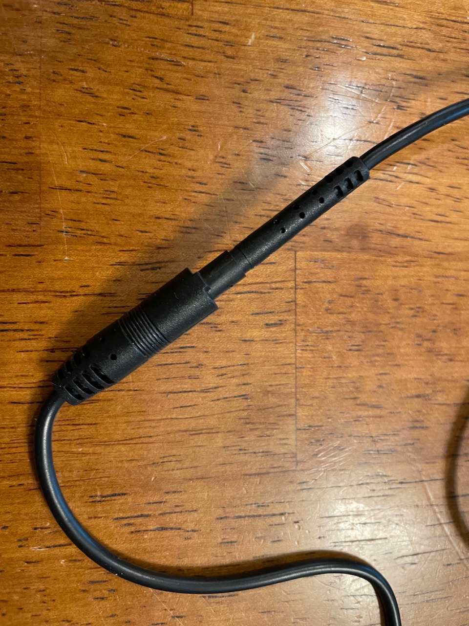

Hey @CharlieS , I've purchased a similar camera and was looking at the connector that goes to the camera and the button thing that allows you to select image format. Both these things are nearer the camera physically and will send up behind the bumper or grill or in the engine bay and be exposed to the elements. I don't think they are water proof. I was thinking of just heat shrink wrapping them. Did you worry about this or do anything? Have you had any issues?
Whenever I have something like this I wrap the connecting area in 3M Super88 tape and then heat shrink it. I've used Super88 without heat shrink and once it's adhered properly I've never had it come apart, but I still prefer to heat shrink as you suggest as well.
Butyl tape is better than Super88 for sealing but much less forgiving about removal if you ever need to disconnect
View attachment 3630985View attachment 3630986
Mine is still working. I sealed the connection with adhesive lined heat shrink tube.

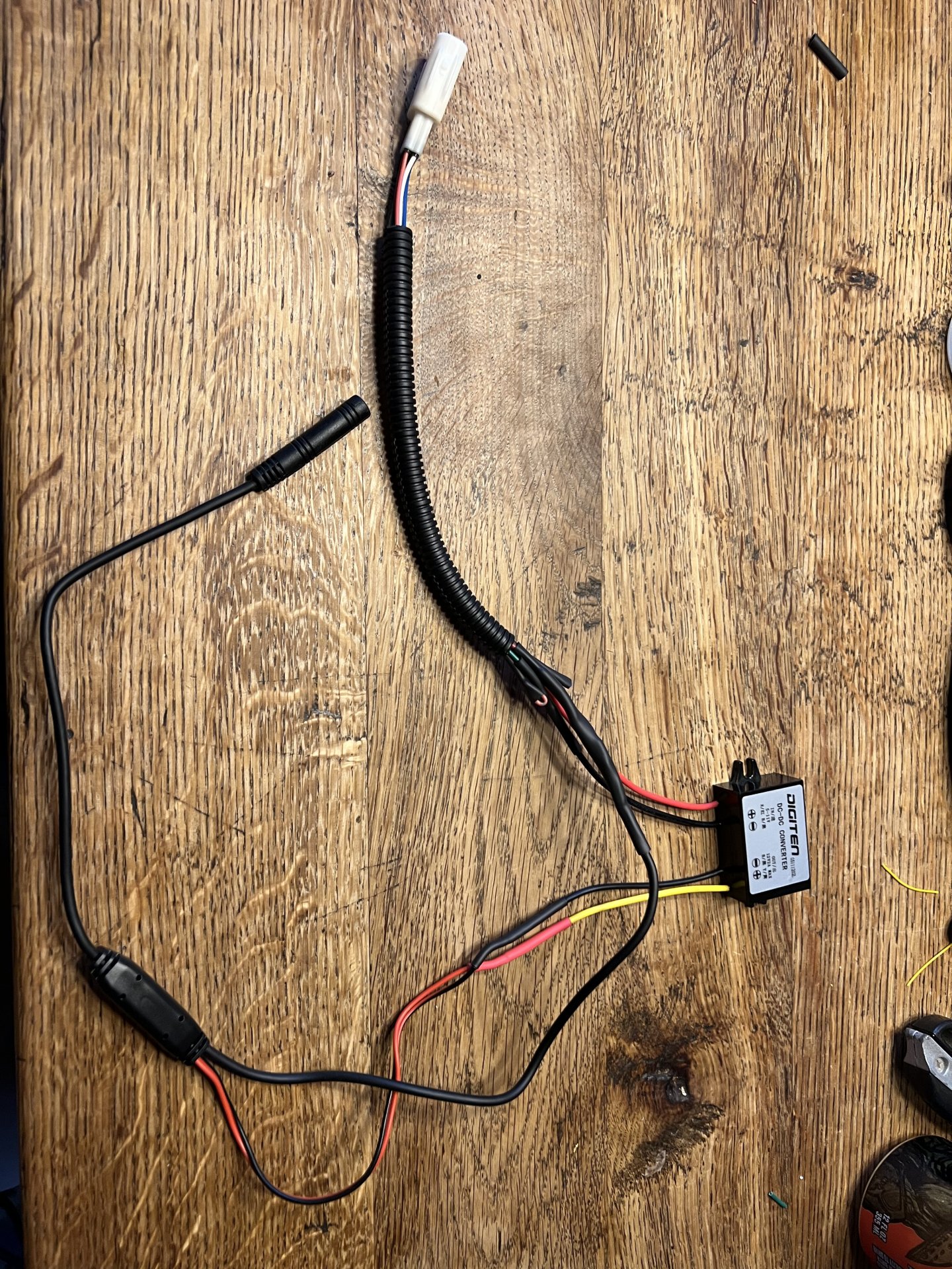

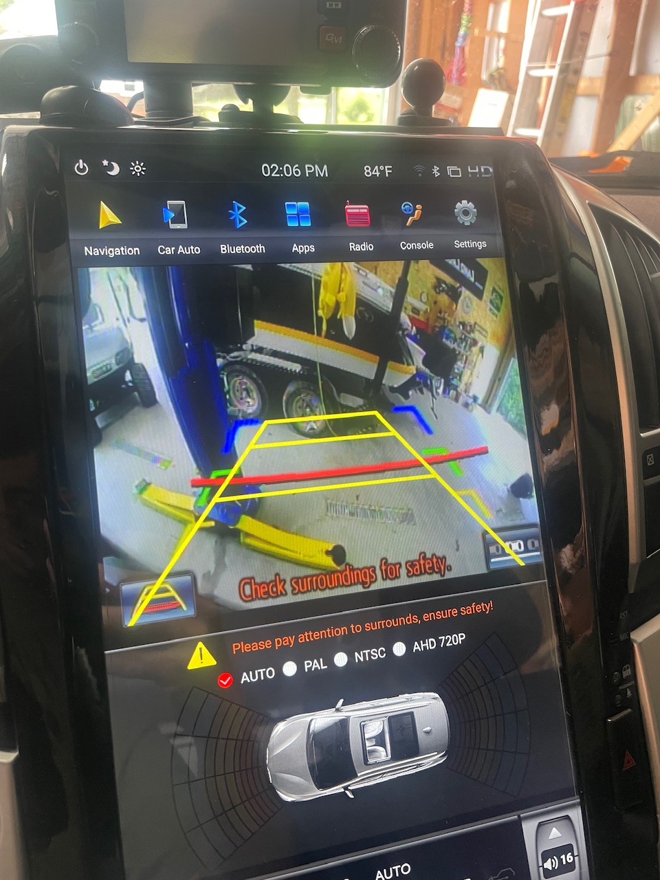

Testing my new camera:
All worked until I connected the extra yellow wire off the RCA plug to ground. I thought it was a ground wire but it seems to be a trigger wire that I don’t need. The installation instructions didn’t say anything about it. Connecting it to ground disables the image. It stays disabled until the voltage decays. The circuits weird in that it seems to keep its voltage for a while even with the truck off and then it decays but takes a few minutes for it to go to zero.
in theory, the camera is capable of 1024 resolution but I can’t get that to work with the Android PX6 head unit. The PX6 should be able to display that but I get nothing when I try it. So 720p for now. Still better that OEM.
