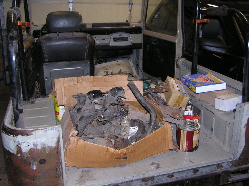

Well, I bought one! Brought home a bunch of spare parts today, need to go back and pick the truck up. Hope to find a trailer tomorrow and pick it up.
It's a 78, unfortunately it doesn't have a top, so that will be one of the first things I look for.

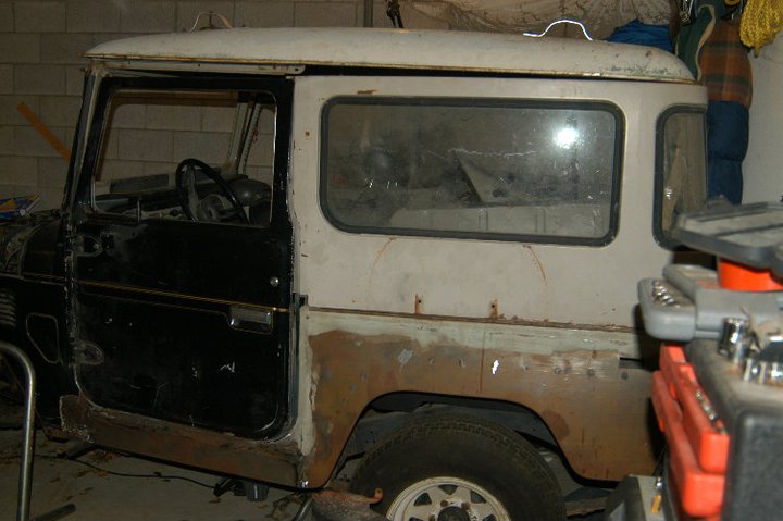

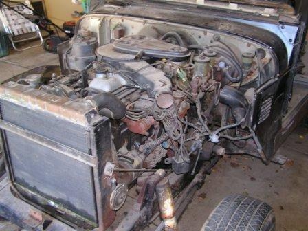

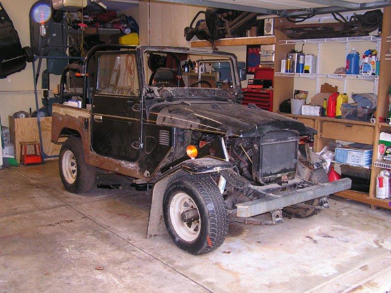

Thanks! Made it home before the rain. Haven't had time for taking pics so I'll post some the PO sent.
stock color was tan, very cool. That's my favorite for an FJ40 so I'll likely return her to that color.

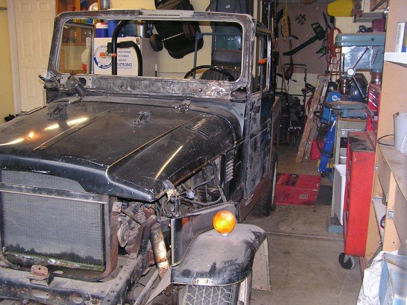

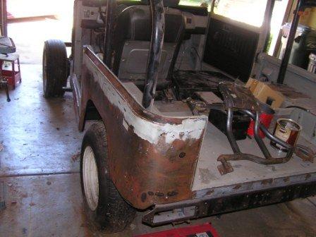

hard top, radiator, windsheild are definite needs but I'm sure this thing will be a mone pit for a long time to come.
Like to get her running and maybe drive a little to check things out. Then I'd like to tear her down. I'm anxious to remove the body and strip and treat the frame.
Need to search and see if there are any plans out there for bulding a rolling stand for the body.
I'll probably do a rebuild on the motor. Have to balance cost but at least should open her up and check things out. Supposedly a recent head/valve job was done.
PO had the hard top but sold it. He said it was on while he did the bodywork but I think I'd like to get one and install it to make sure everything lines up before I go too far. By eye it looks like the drivers top rail bows in a little.

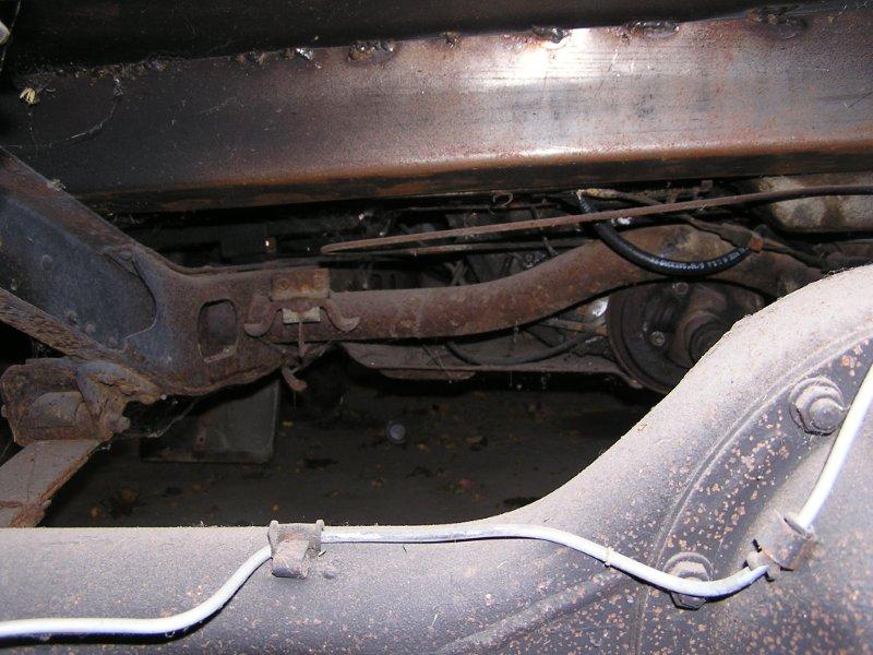

I remember reading about some rust treatment product good for frames? POR? Need to find out about that.

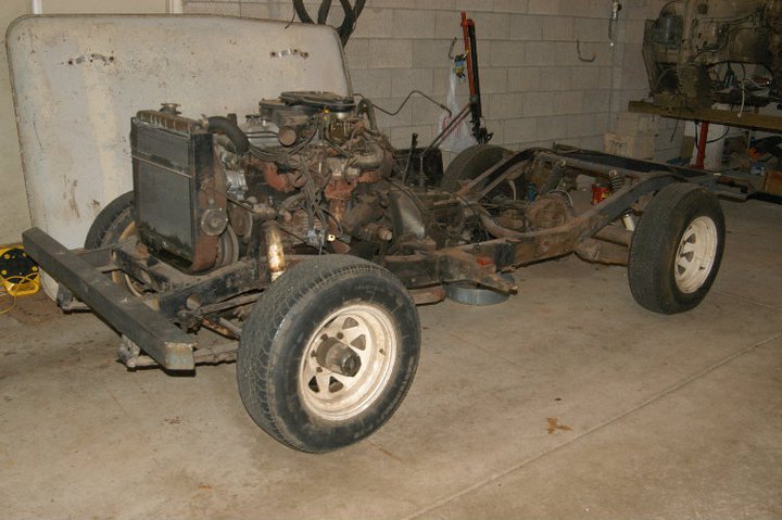

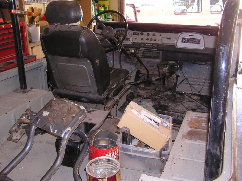

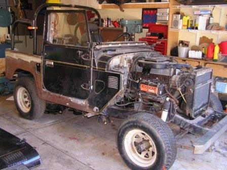

Making some progress.

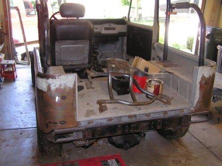

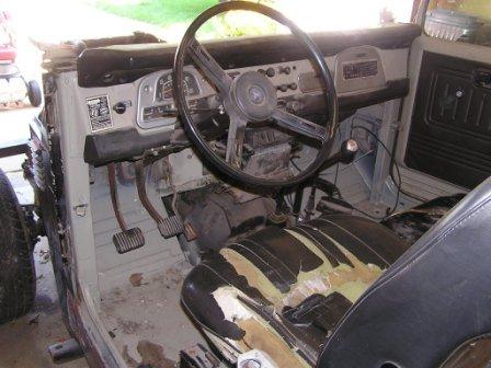

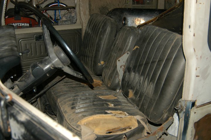

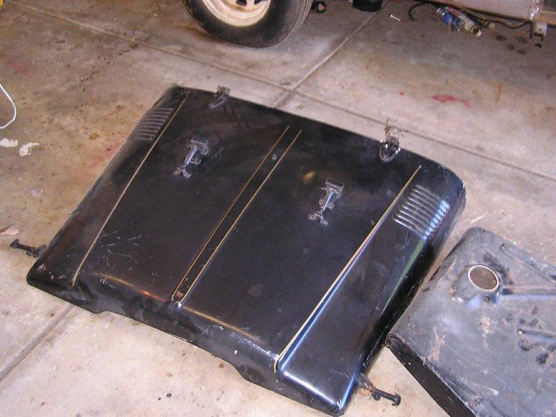

Got a top. Looks like I'll probably need to remove the glass and replace the seals. They're pretty weathered. Top is very weathered but underneath metal is clean. Top is from an early model, think I might have a problem mounting to windshield frame but hope to make something work without buying a different bracket.
Got a 60/40 bench seat. Hope to fab some brackets to make it work. Thought the bench would be a nice option. Wife and I enjoyed one years ago... Might keep the buckets though and restore them as well. Considering making patterns from the originals and doing my own upholstery.

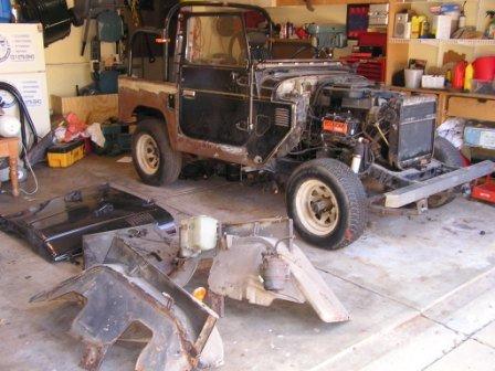

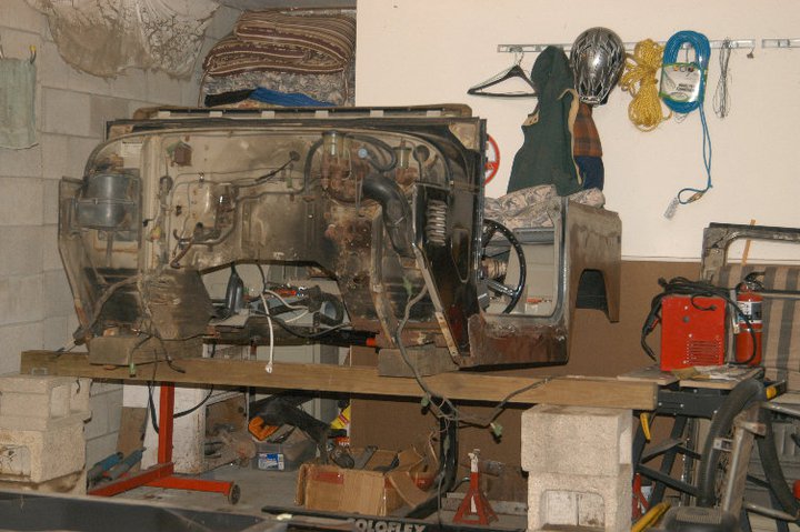

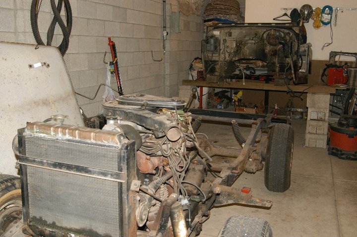

Managed to separate the frame from the body.
Should get the motor and trans pulled tomorrow. Compression is low in cylinder 2, likely going to tear the motor down and check things out. Probably do a rebuild but want to keep cost to a minimum but still do it right. Probably going to desmog.
Start stripping and cleaning up the frame shortly. Need to strip a lot of the body work yet too.

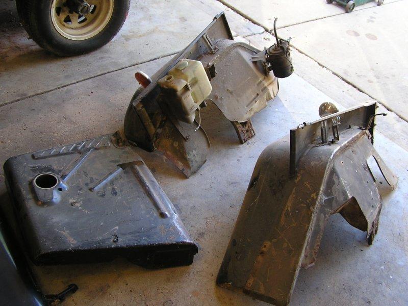

Moving quickly. DO NOT SANDBLAST ANY BODY PARTS. YOU WILL WARP THINGS(ask Phil about the bezel I gave him.) Plastic media is best , or soda. Altho you can blast the crap out of the frame and axles.
As far as how far you want to go- take stuff to the powder coater in Delavan, plating parts to Racine plating. Seats recovered by Geneva upholstery.(material buy from aatlisx) Move quickly on signals and the like(cdan) before they are discontinued. In fact, make a list, call him and you can just cross off the things . Then the real quest begins.

Moving quickly. DO NOT SANDBLAST ANY BODY PARTS. YOU WILL WARP THINGS(ask Phil about the bezel I gave him.) Plastic media is best , or soda. Altho you can blast the **** out of the frame and axles.

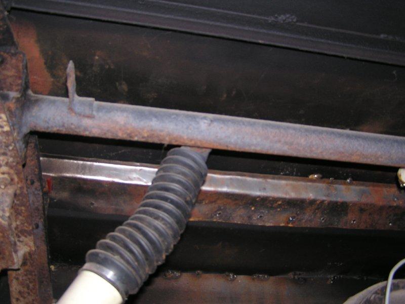

Ordered some Picklex 20, the flash rust on the replaced panels have driven me crazy since I saw pictures of the project.

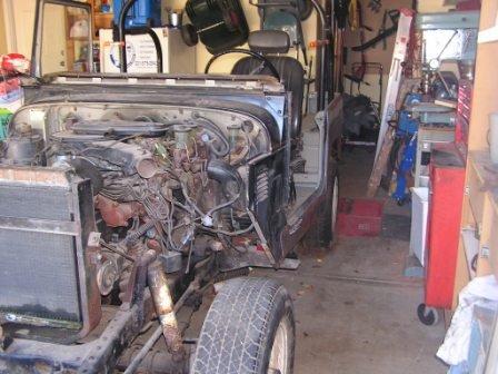

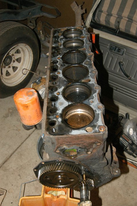

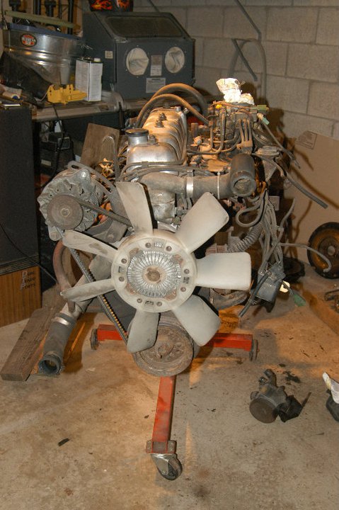

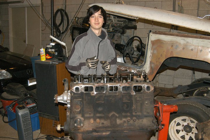

Remove the motor and strated tearing it down a little.
Motor is going to need a rebuild, rebuild carb, new radiator, etc. Need to crunch the numbers and just consider a different swap. Diesel might be cool, chevy v8 might not be much more expensive (and less weight than the 2F?) but definitely leaning towards keeping it stock. Would like to get her rebuilt and enjoy it for awhile. I can always swap something else down the road.

Figured out the other day I probably got the wrong top too, 1978 had the pop-out side windows? Sigh, those would have been cool. Didn't even know the pop-out windows existed. I thought I had read that the tops didn't change throughout the years. Oh well, not a huge deal but the windows might have been nice, especially in the summer.

Picklex 20 came yesterday. Need to treat the replacement pieces the PO put on the tub.

Is that half tub aftermarket? Looks like an IPor product.
