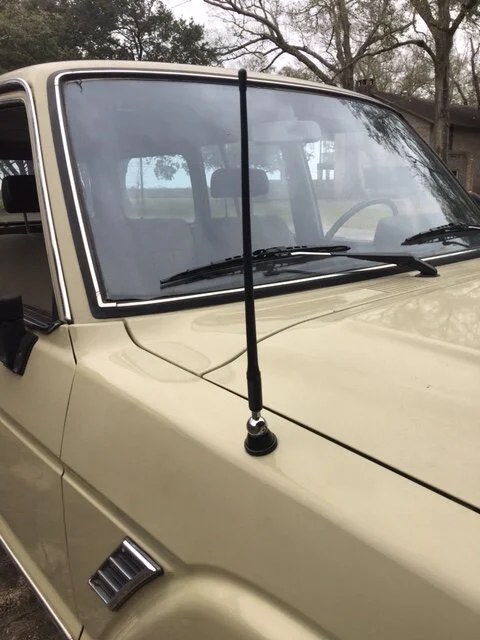

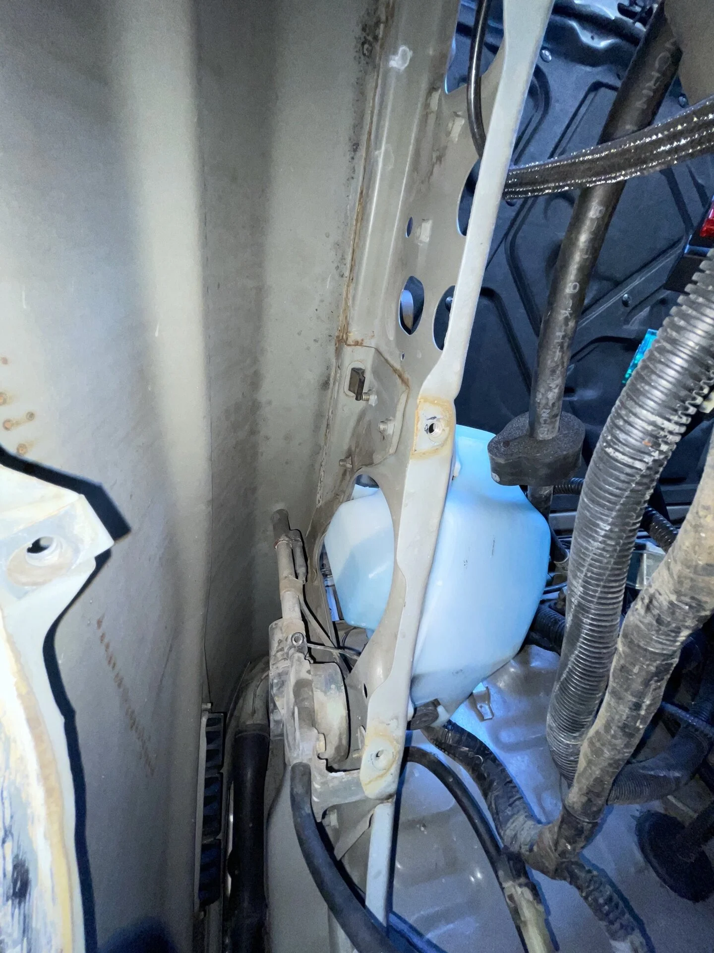

I just did this. I did remove the washer reservoir. The antenna came out easily. All and all it went smooth. I did an aftermarket antenna… it looks crappy and I’ll replace it with a real one soon.
Vintage Teq is sold out of 60 antennas. Is there another option people have used that looks alright and bolts in easy?
I replaced it today with a shorter black one . Thanks to everyone for the replies.
Comes out easy and like he said get the washer jar out and easy. Get back there with a box wrench and done! Cleaned mine up

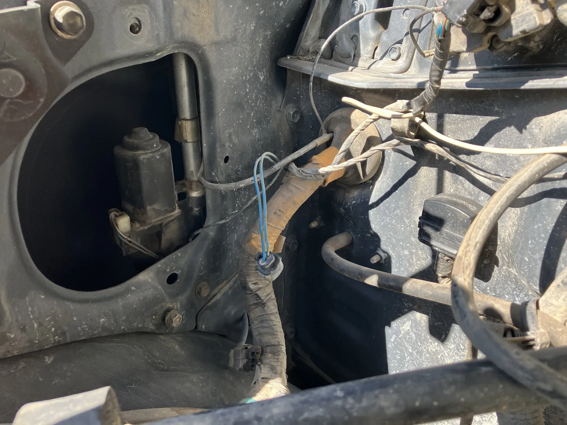

Where does the antenna wire route through the firewall?

FJ62 Ant wire (below 2 blue wires) runs thru firewall at major grommet. Need to remove washer fluid reservoir.
Thank you for posting this pic in the main forum. That was a huge help, and I sure do appreciate it.. Got the wire run and everything buttoned back up. Wow, its nice to have a stereo!
Here to help :D
