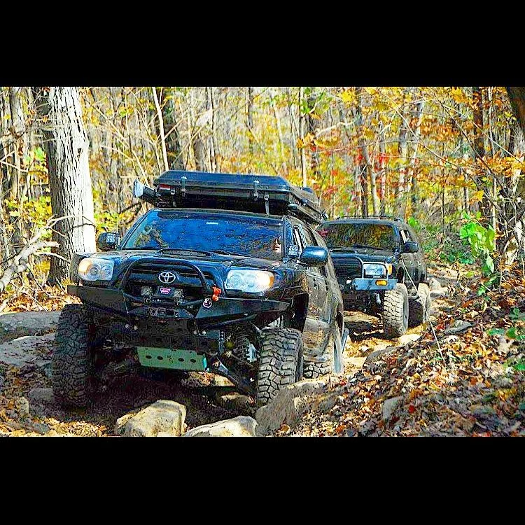

Hello all. I recently sold my 08 4runner build (pics below), a bought my wife a 15 GX460. We/I already have a build list going to start our family Overland rig but I need ideas for mounting my ham radio antenna. I had my 4runners on the back hatch but I don’t think that can happen with the GX swing out door. Let me know what you guys run.
Thanks

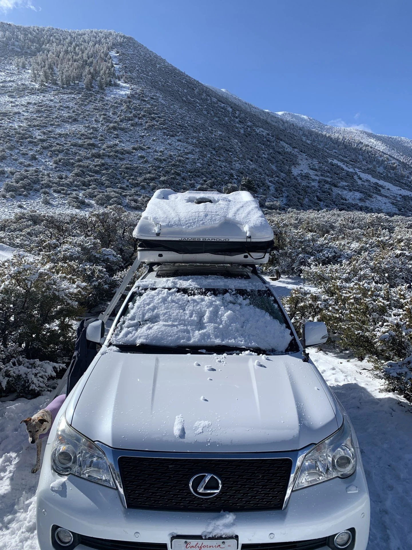

EDIT: here is a couple of shots I took that happen to show my antenna mounted to the hood of my truck.
2002491
2002493
I am running a Diamond NR770B Antenna and the mount I'm currently using is the Diamond K412S medium-duty lip mount, I plan on upgrading the mount to the Diamond K400D heavy-duty lip mount. The NR770 is a very durable antenna. I've had it on my last couple of trucks, mounted high, and it's been through brush, trees, and parking structures and it's still going strong. That being said; it's not as easy to fold anymore, it has taken a slight bend, and I've lost one of the two set screws (loosing set screws seems to be common with antennas and off-road driving).
EDIT: Here's where I mounted my antenna before I removed the Front Runner roof rack and installed the Rhino Rack cross bars and my RTT. I noticed a pretty decent drop in reception by having the antenna lower than I used to have it.
