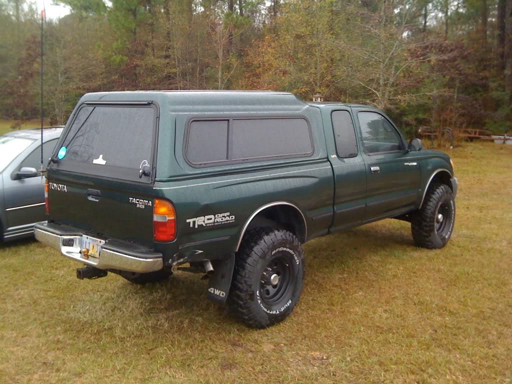

I tried two different Firesticks on my Tacoma. I have a fiberglass camper and I made a mount that's right above the tail light. The first antannae was a 3' that was too short to clear the camper well. I could never get the SWR right. So I got a 5' that clears the camper and it was a matter of about 4 tries to get it right. 1.0 from channel 1-40. Its the no plane one with the screw tip adjuster. IIRC you need 2/3 of the antannae above the roof line to get it set up best. Mine is about 1/2 and it works good. I don't run it with a spring because I don't want it beating the side of the camper up all the time.
This is the one that I couldn't get the SWR down on:
And this is the one that worked out good:

I had my antenna in that location for a bit. Similar results, due to what others have said with the ground plane and height I believe.
Anyway like my first post here I am running a firestick and in that location I did have to tune it. I about 1.4 -1.6 across the range. Its not perfect, but works fine short distance on the trails.

This is what I used. Mounted it to driver side D piller.

D'oh!, I suppose you could mount it lower by the tailgate and get a longer antenna?
Yes on the cable :) Makes a good connection and clean install IMO.
D'oh!, I suppose you could mount it lower by the tailgate and get a longer antenna?.
ya sure .. wonder if that would work better than my actual setup since I don't have that much roof as Tencha used to have ..
I think it's because your antennae doesn't clear the cab by very much.
Yep. It could be cured with a longer antenna, or using a mast to raise the bottom up higher. In all likelihood the bumper is providing a very good ground plane, it is just the rest of the truck is absorbing what is transmitted.
