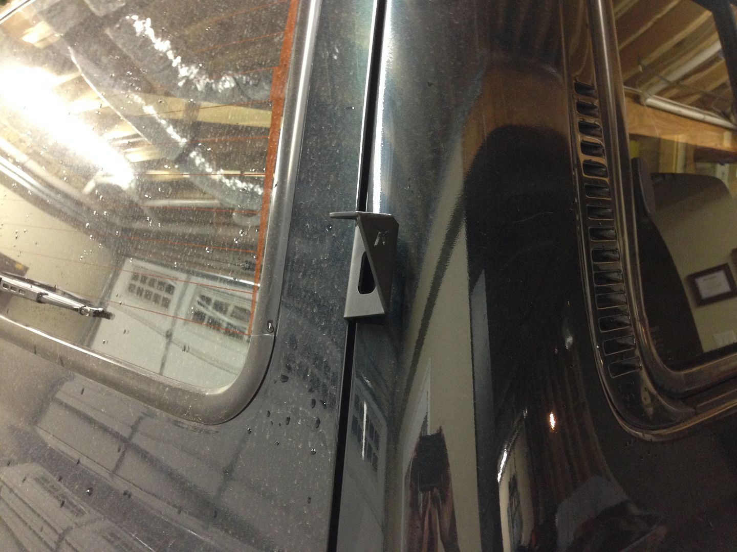

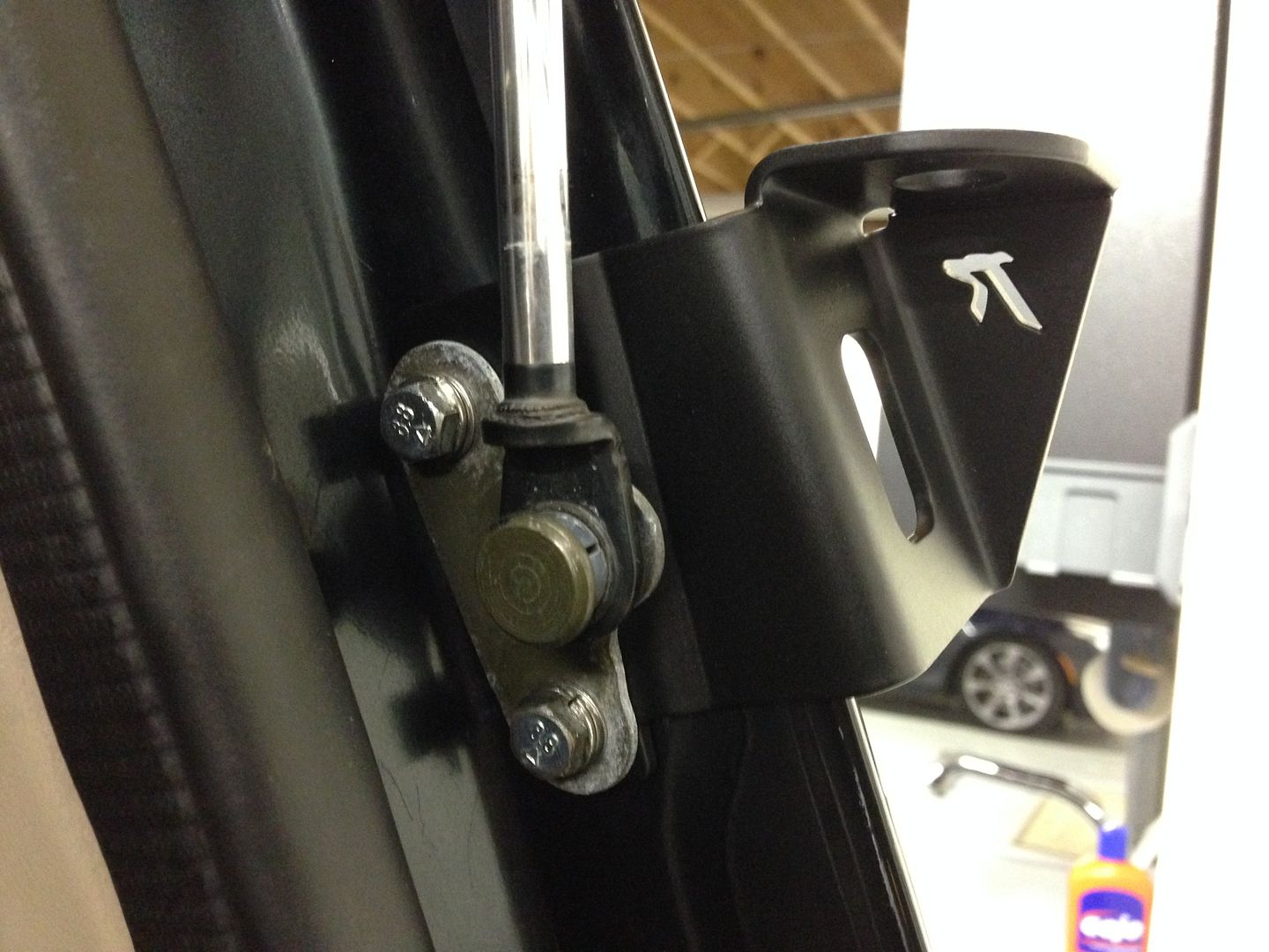

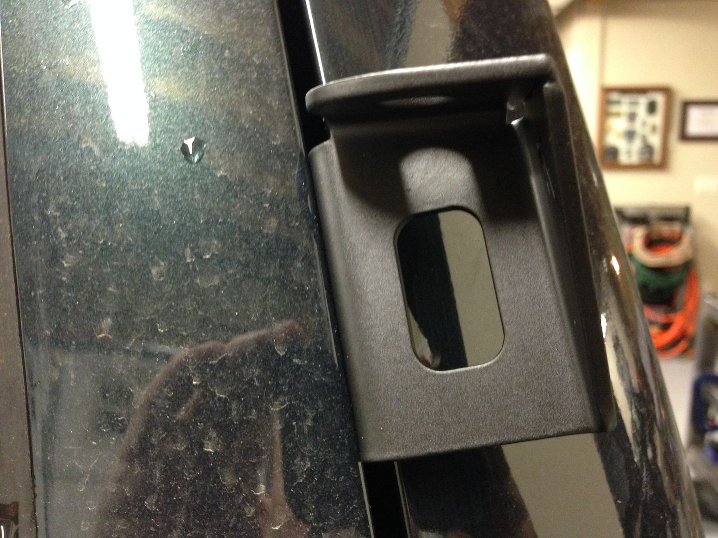

Here's mine...
13296756385
13297142324
Sorry about the pic, I'm having trouble with this new site. Right click and view image......
