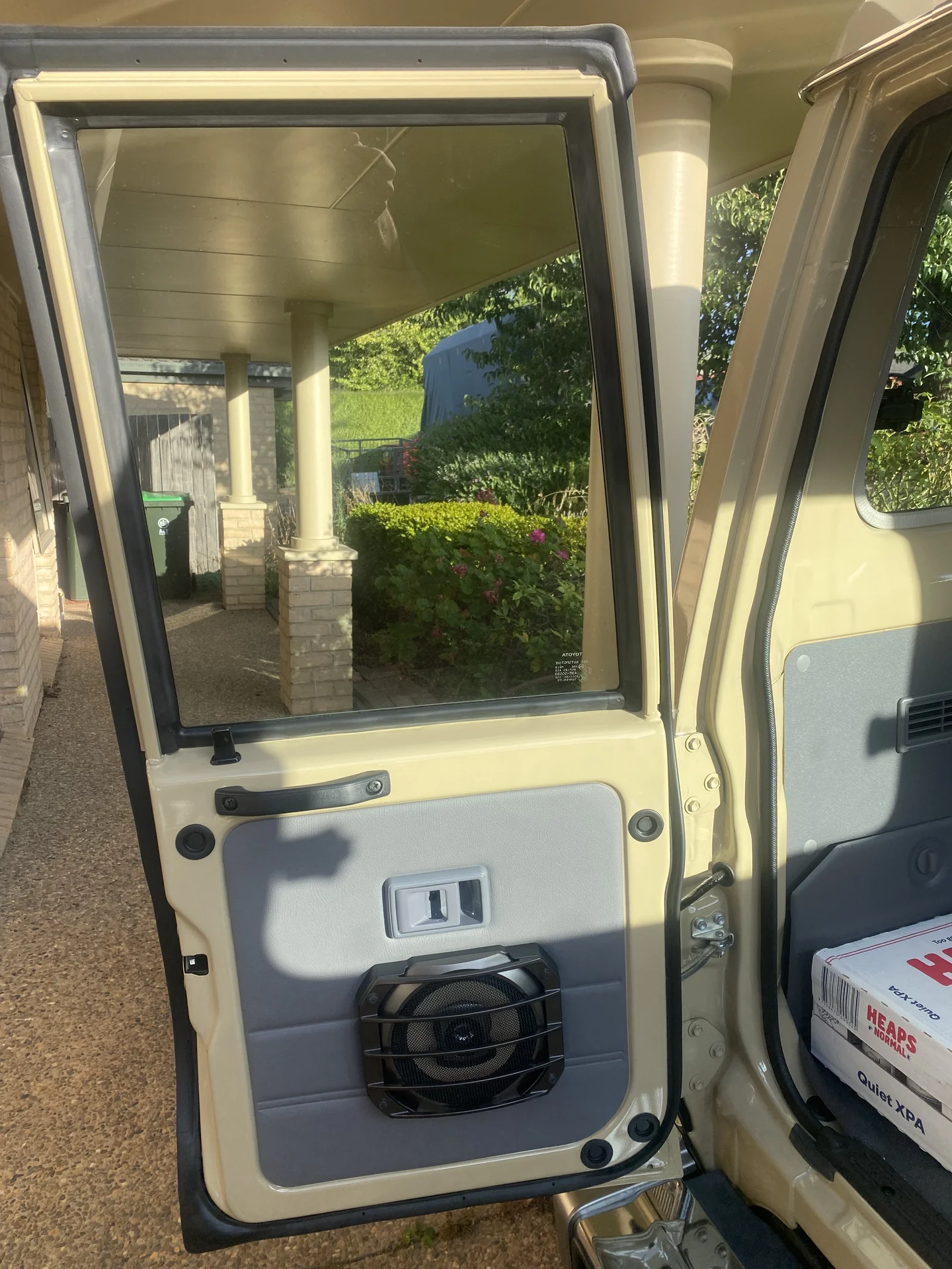

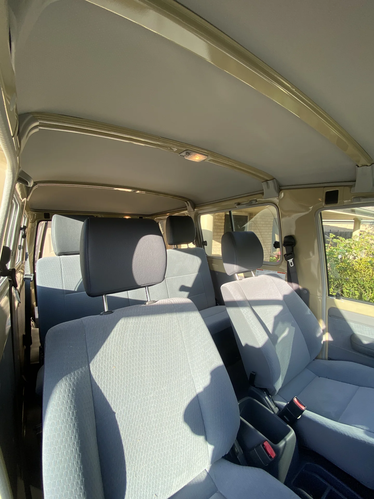

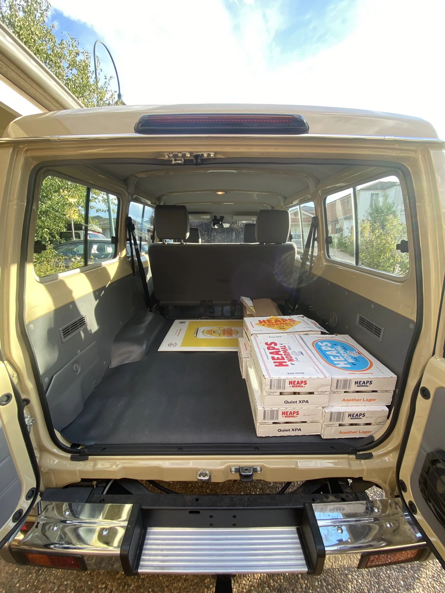

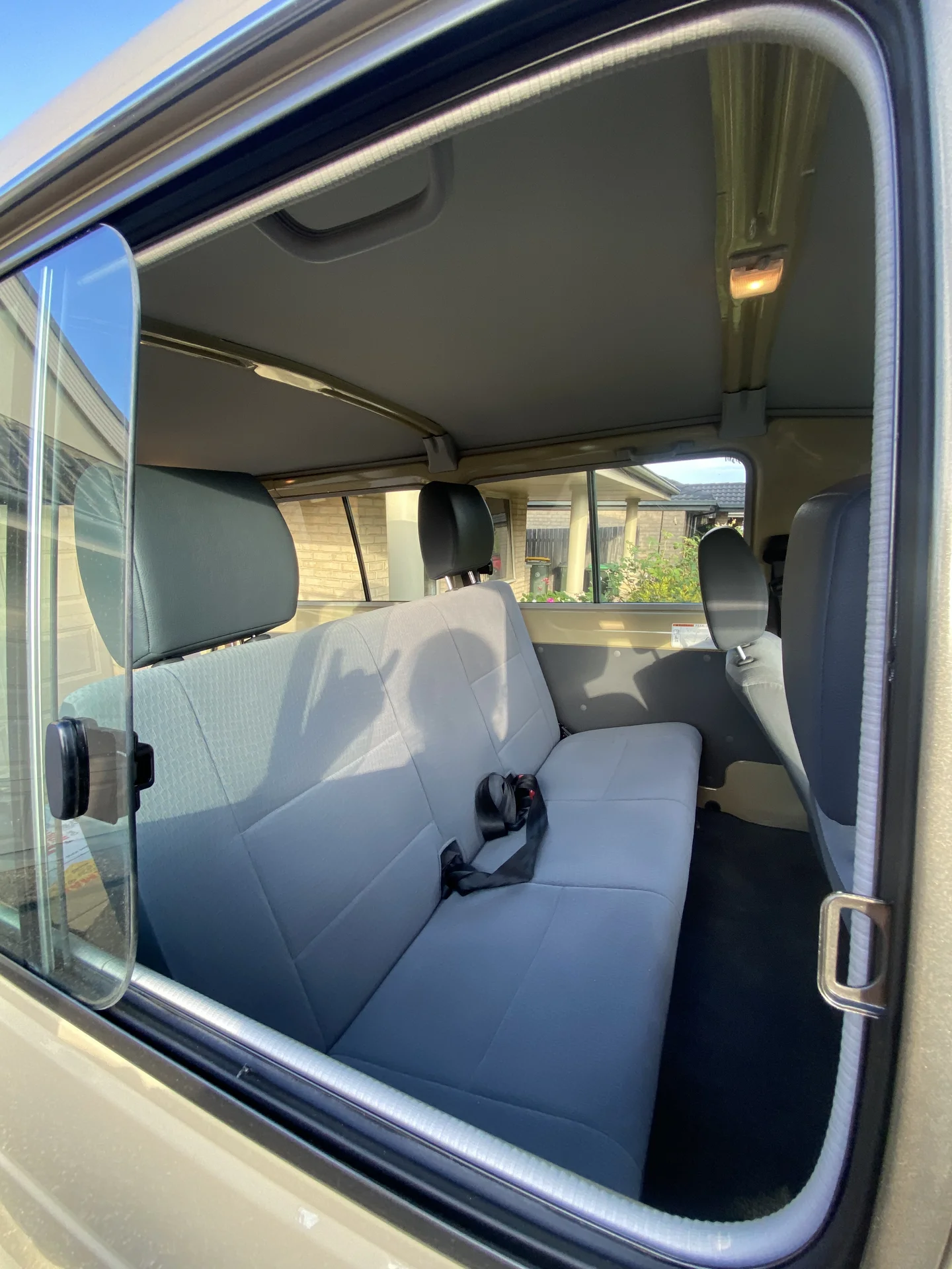

Would love to see some interior photos.
The belly of the beast; some cool roof skeleton and bare interior walls.
Beer-carrying ability is off the charts! (I'm a beer rep...not a fiend).
A reasonably nice set of speakers that are begging to be relocated.
Rear seats that will sadly go un-sat. 🤘
