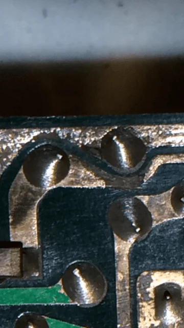

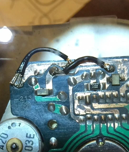

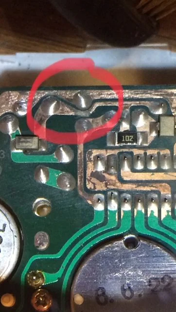

Just wanted to share my broken speedo experience. I am in NO WAY an expert, electrician or pinball-wizard, this is just me doing me. Hope it can help others.
I just got my first 80 Land Cruiser, a 1994, lower end model, 234k. Amongst numerous issues, the Speedo and OD where not working. After reading a bunch of different sources this is what I did.
Tested VSS (on transfer case- remove unit, has 3 pins center is ground, input 12v, ground center, check remaining pin for voltage (will not be enough to light test light, need multimeter) when drive turns, should be 4x pulse per revolution. If no voltage try input on other side, center is ground. Check VSS wiring feed, has 3 wires in plug-yellow=power in, Brown=ground, red/grey tracer= signal. Turn key to power, ground center on plug, yellow wire should be "hot" with 12v. If all of the above checks out it's on to checking the signal wire running to the dash. (I believe this wire branches to also control cruise control). Disconnect battery. Pull dash panels, pull cluster. Signal wire at cluster plug will be red w/ green (its the 3rd in from one side). Place 12v source under car, ground battery to transfer case ground wire, (double check you have good ground), 12v+ plugs into red w/grey signal wire at VSS plug. Go to dash, ground multimeter, find brown cluster plug, Red w/ green (3rd in from one side) should be hot (12v). If all this checks out problem is likely the speedometer. Open cluster face, pull 4x screws on back, remove speedometer. BE CAREFULL WITH IT. Look at back for dark/burnt area along top. Mine and others where burnt out along top, seems there are 2 areas that a problematic. (see pictures). I used a brass brush to clean, took cellphone pic and zoomed in to see what was going on. One area was completely burned away, other was very thin. I soldered jumper wires across being careful to not bridge nearby contacts. When done gave it a quick spray of rattle can clear coat. Put it all back together and was SHOCKED to see I now had a fully functioning, smooth speedometer, working odometer, working cruise control . (The tree lights also seem to now work where as before it was super hit and miss). Time will tell how long this fix lasts but so far so good.
