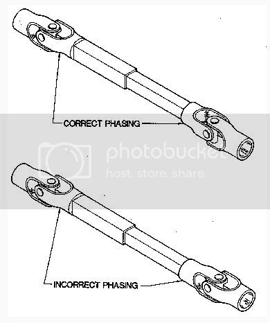

Check your driveshaft phasing as it could cause a vibration....
