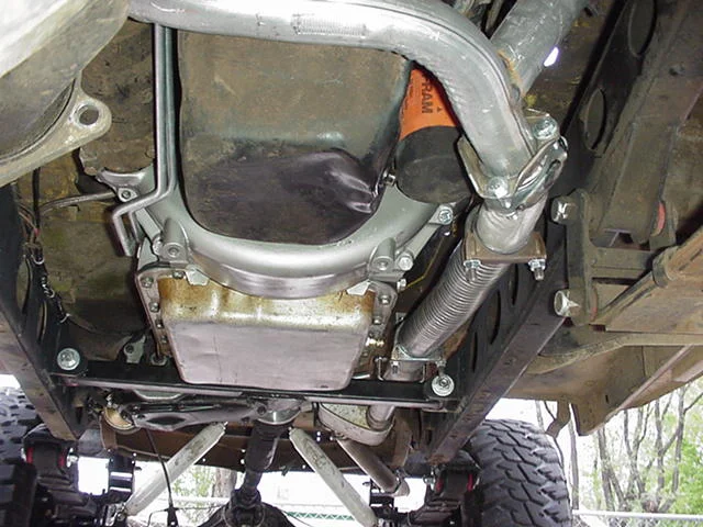

Mine is a Completely Stock CV Toyota mini truck drive shaft.. Came out of the front of my 89 4runner.. 25" long
My Drive line sits ~1" Drivers side, and the pinion on the 3rd sits 1.5" to the Passenger side.. No vibrations up to 80MPH.. :steer: <-- Keeping it in my lane ;)

Did it again! Brand new shaft this time, first hill climb I came to. Gave it some throttle, just a little, and BANG. I'm trying to run an 80 rear axle with the stock 40 three speed transfer case in my fj40. The axle is not that far offset. only about three inches. Any body running this setup? Any suggestions other than replacing the rear axle with the correct offset? Just need a shaft that will hold up to some skinny pedal.
How long is your driveshaft? I'm running this EXACT setup, but haven't gotten out yet since I'm finishing up my front suspension. I ended up going with a Double CV driveshaft too. How'd you 1310's at the T-case end? No one could match that factory LC t-case stuff to switch over to spicer. I ended up with mini truck cv at the tcase, and spicer stuff at 80 series pinion. I ended up doing around a 6" wheelbase stretch so I'm hoping I won't have this problem...

Mr. Notorious, my rear driveshaft is 24" long. I am running 55 rear springs so the axle is moved back 4" or so. I sent the flanges to the shaft maker and they drilled them out to fit the spicer yoke. If you can, (sounds too late) don't bother with the double double. Mine still vibrated at all speeds, some worse than others. I have not replaced the shaft yet, but I am going a different direction. Not everything you work out on paper necessarily works in reality! I'll post as soon as I get there, (reality):hhmm:. The t-case brake is MAF. Good kit. I replaced mine because the drum was scored where the seal goes and I skipped the speedi sleeve. Also I left the e-brake on in 4low:whoops:.Only problem is the cable gets water in it and it freezes. PITA:mad:. I have the factory locker and used the Downey cable conversion. That works wicked pissah too. Get your order in soon 'cause it takes a while for them to make one. The new t-case flange that comes with the disc kit is a 4spd unit.

Yeah I already got the double CV, we'll see. I have a 4link so maybe I'll be able to dial in my pinion more to prevent vibes, we'll see. Everyone I talked to said a compound angle on a ujoint doesn't matter, doesn't sound like the case here...
