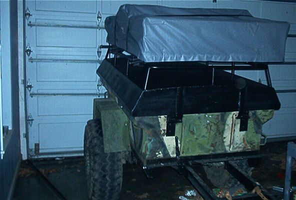

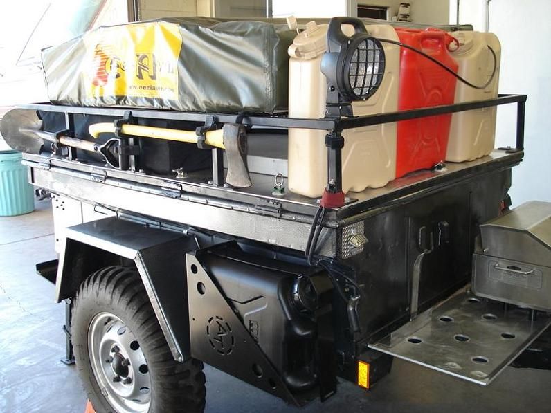

after looking at the prices of yakima and thule racks and all the crap you have to buy with it to make it work in my application, i decided to build a permanantly mounted rack on the top of my lid. this will give me a place to mount my tent, carry other junk and eventually somewhere to mount my kayak and bike. i got the idea from izzydusit over on expedition portal. he's done a great job on his trailer. here's a pic of his rack-hope he doesn't mind.
the main difference is my tent will be mounted above the rack on some removable crossbars so i can carry more crap, and it'll be made of round tube.
finished my rack today. just have to paint the whole thing and then fab up some cross bars to mount the tent on.
i used 1.05 inch gas pipe as i couldn't find any tube on short notice. it's a little heavier, but it doesn't add up to enough to matter.
