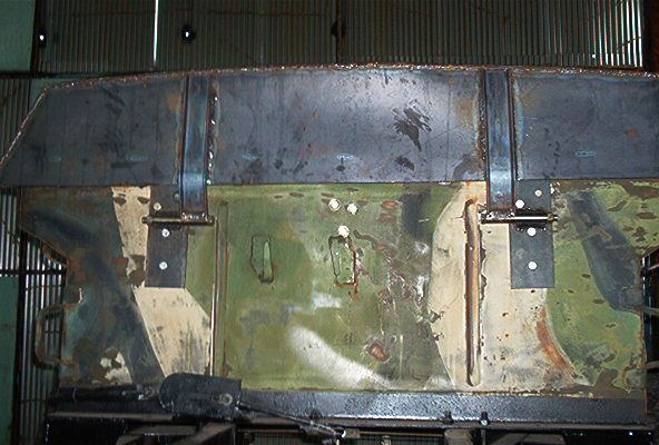

first pic is my handle-nice and stout, but as it turns out, kind of hard to reach when the lid is all the way open.
second pic is my hinges. 3 inch channel with bushings welded on the ends and then welded to the top. on the tub are pieces of flat stock with the same bushings welded to them and bolts for pins. on the inside is another piece of flat stock running all the way across to keep the tub hinges in place.
third pick is my 250lb(per strut) gas struts.

last pic shows how high the lid opens. a little more than i was expecting, but it will be nice once i get all my crap in there. i did finally bite the bullet and order an arb simpson II rtt. i found out that the 4wheelparts just across the stateline was running a special. i got $125 off the sticker price and then talked them into drop shipping it to me so i wouldn't have to pay any taxes on it. should be here by the end of next week.
