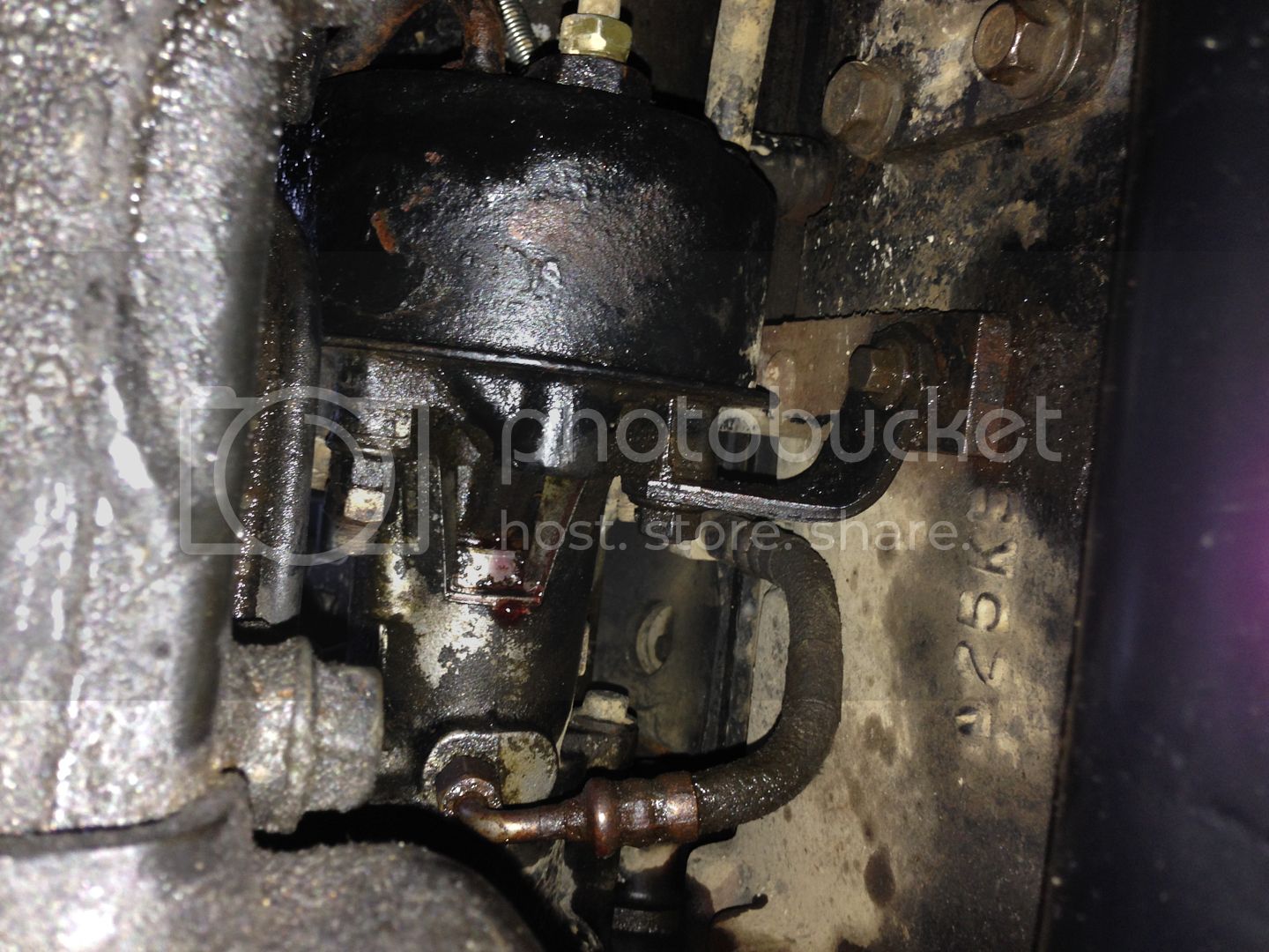

Did you reseal the pump prior to install? My 02 Dodge CTD leaked like no other when I got it. $30 seal kit fixed it right up.
There is an after market pump seal kit with bigger o-rings. Get it and don't look back. Mine were all cummins parts and it lasted about 1500 miles. When I originally rebuilt it I thought it needed bigger o-rings I was right it's a common problem with an easy fix
That OEM part is the same in the kit. It comes with that too

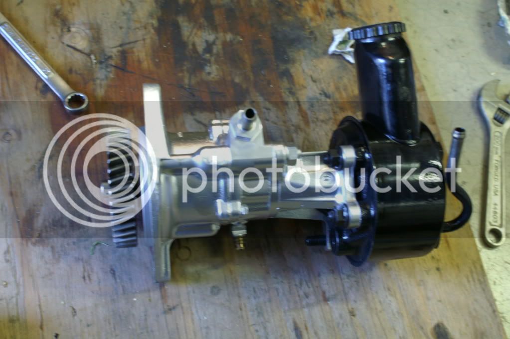

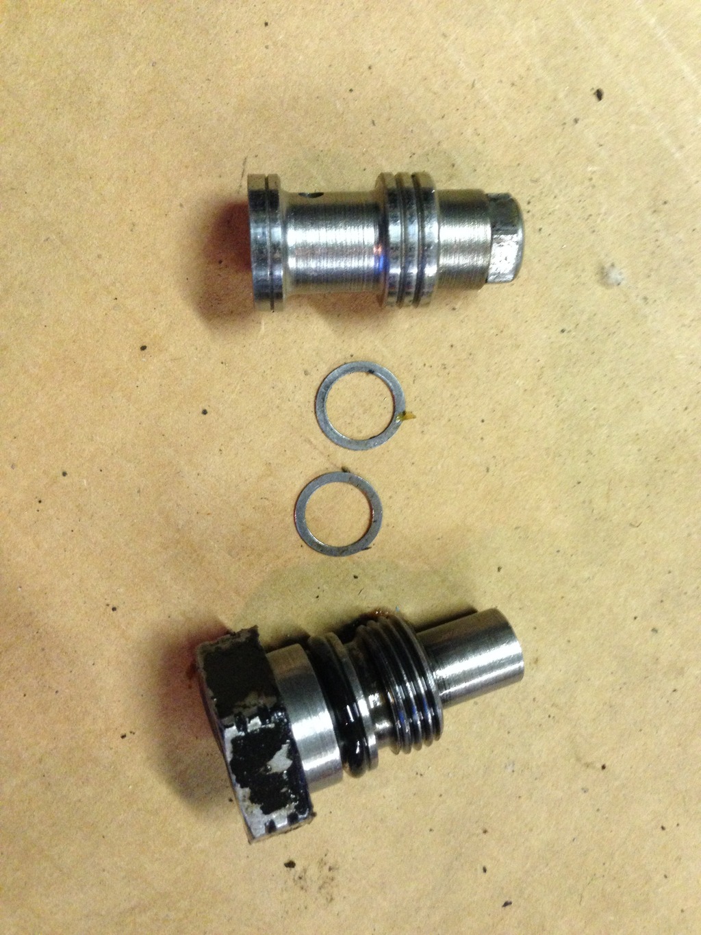

Here's the new pump, not mine just a pic

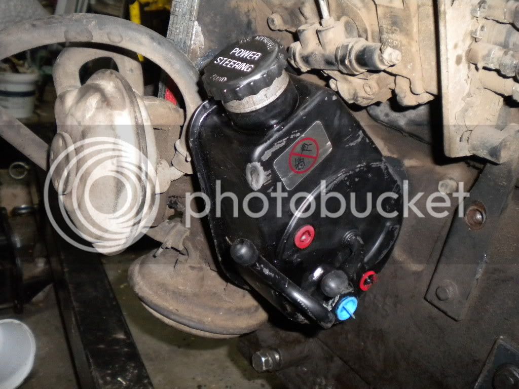

And what my original looked like, again just a pic not mine.
Are you using hydro boost brakes or the original vacuum. I wouldn't think it would matter the pump should be the same. You can turn up the pressure. West Texas offroad has a good writeup on it.

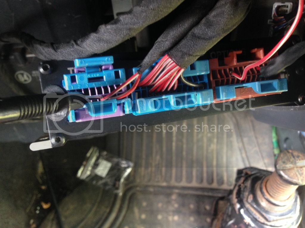

So I was trying to figure out the reverse lights and I found that if I ground the reverse switch on the trans controller, where the black test lead is, it powers the reverse light output and I can hear a relay click and my R dash light and reverse lights come on. The reverse output is the kinked red wire all by itself on the right connector.
So does anyone know why it's not working? Why is the reverse not closing the switch?
